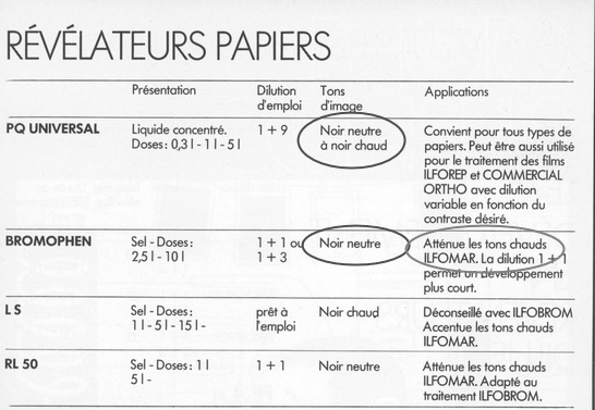

I've been trying to obtain slightly colder (or less warm) tones from Foma Variant 111, compared to what I'm currently using.
Which is : either D-72 or ID-62. They give identical (to me) results.
Tried a modified ID-62 with no KBr and 2x benzotriazole. Still no difference in a side-by-side comparison of step wedges.
Then I came across this old Ilford leaflet (see below). From the time HP4 was still around and the dinosaurs... According to that, PQU is "neutral to warm", while Bromophen is "neutral", and even "attenuates the warm tone of Ilfomar". While there seems to be a consensus that PQU is more or less ID-62, I have not come across a reliable Bromophen equivalent.
Maybe modern papers have their tonality baked in more than in the past? Or, is there a way to cool down somewhat currently available neutral-tone papers?

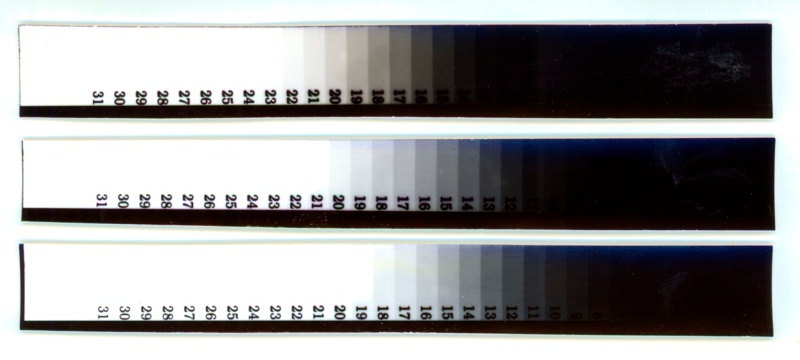

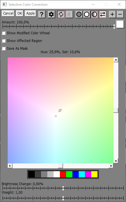

First : Do not expand the thumbnails until you have performed the blind test.
Replacing phenidone with metol in ID-62 results in a close approximation of D-72. Except for the restrainer(s), but read on. I've tested both and claim that the tonality is identical. But, (you will say) D-72 has just bromide, while ID-62 has both bromide and benzotriazole. I had thought of that back when I made my tests and prepared also D-72/BTA with KBr replaced by 0.4g/litre (stock solution) of benzotriazole. I also tested ID-62/BTA with no KBr and 0.4g/l (stock) benzotriazole.
So that is 4 combinations. Exposed strips of Fomabrom Variant 111 under a Stouffer wedge (31x0.1) and a #2.5 filter. Developed in respective developers diluted 1+2 2min at 22°C. The four strips were scanned jointly using a V700, 300dpi, 48-bit Tiff. Then (Faststone) saturation cranked up to +100, image resized to 600 wide, saved as jpg.
Now expand the first thumbnail. Which strip(s) looks warmer? colder? For an objective assessment, I opened the image in Picture Window Pro, and used the eydropper to sample step #12 in the four strips. The second attached image is a (zoomed-in) representation of the the hue-saturation space. The small circle is "white". The symbol slightly to the upper right is the cluster of the four samples. Virtually identical.
So far the experiment only claims to reveal differences (or absence of-) between the developers. Note, however, that the samples are in the direction of Orange, consistent with my perception of the tonality as slightly on the warm side. That is not my main claim in the present post, so no need to argue whether a V700 can do absolute colorimetry.
The developers used for respective strips are revealed at the bottom of the Sports page.
  • ID-62 (plain)
  • ID-62 (0.4g BTA)
  • D-72 (plain)
  • D-72 (0.4g BTA)

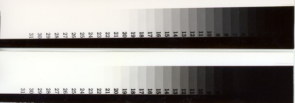

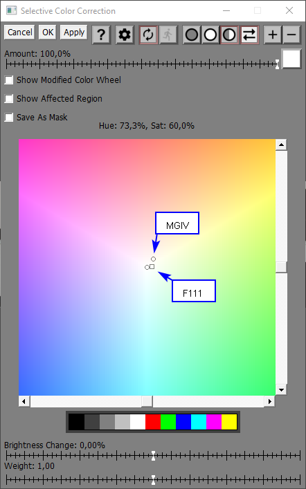

I repeated the same process as in my post #11 above, but this time Ilford MG IV versus Fomabrom 111 variant (previous tests kept on file). Both developed in D-72. This time I sampled step #28. Top is MGIV, bottom Fomabrom 111. Disregard the Hue/Sat numbers above the colormap; I guess they reflect the position of the mouse. This measurement does not support your statement. Maybe my MGIV was old, but definitely the Fomabrom 111 is neutral relative to the calibration strip of my V700.
Fomaspeed variant is another story.

It's interesting that your tests find Fomabrom as, or more, neutral than Multigrade Classic. Did you compare unexposed parts of a print? The borders on my Fomabrom prints are always yellower than the Ilford papers.
Other than developer tweaks (more BTA, using Metol instead of phenidone, etc., the only other thing I can think of is gold toning. Have you looked into that? Or getting your hands on some PMT?

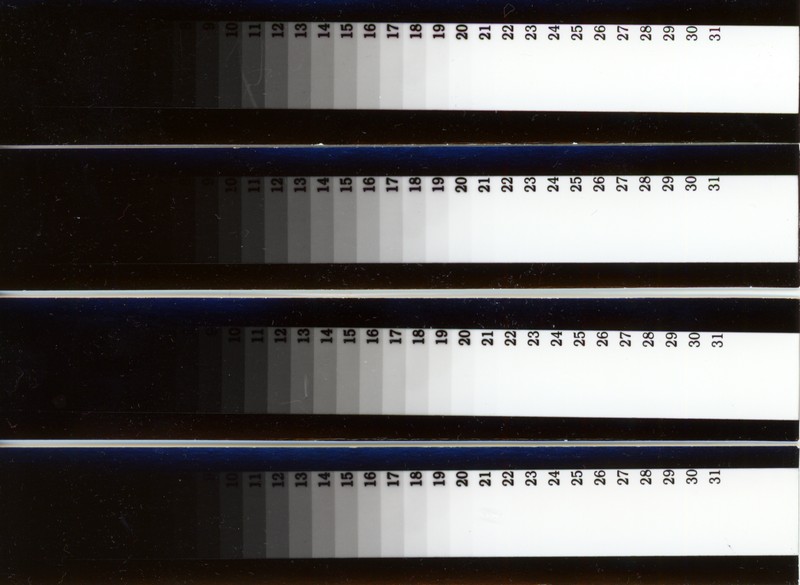

In the meantime, I have received some Moersch Blue Finisher and made tests. Fomabrom variant 111. Stouffer step wedge 0.1D steps. ID-62 1+2 2min @22°C. Amounts 0, 5ml, 10ml per litre of working solution.
Executive summary. It works. Thanks to all those who gave positive input, especially @Milpool who gave an effective solution already in post #3.
Below the test strips. Scanned as 48-bit tif, then as final step resized and converted to jpg for forum display. First as-scanned, next with saturation enhanced to +50 (whatever that means) in PictureWindowPro. Repeat for those who practice speed reading: Amounts 0, 5ml, 10ml per litre of working solution.
Also repeat what I wrote in a previous post: no claim to absolute colorimetry. Here, neutral white is defined by the cal strip of my V700. This said, the rendition on my screen agrees with the in-person viewing of the strips: Fomabrom "as-is" has warm tones (the intermediate values). At 5ml/l of Blue Finisher, mostly neutral tones, only-so-slightly on the cold side. Speed loss @5ml/l about 2 wedge steps, i.e. 2/3 stops. @10ml/l twice as much.
Not that I'm bothered by the speed loss, but I'll try halving the amount and see if neutralizing remains effective.

Hi Bernard, thanks for updating. These results are fairly consistent with my tests of PMT (the active ingredient in Finisher Blue) with MQ developers and Ilford papers. Depending on the amount used/required, some speed loss is normal given PMT is a powerful restrainer.
