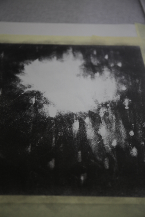

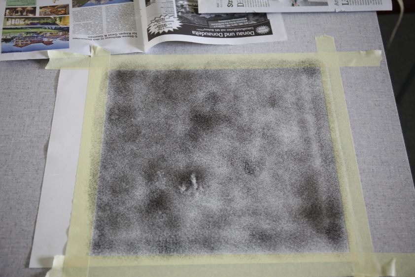

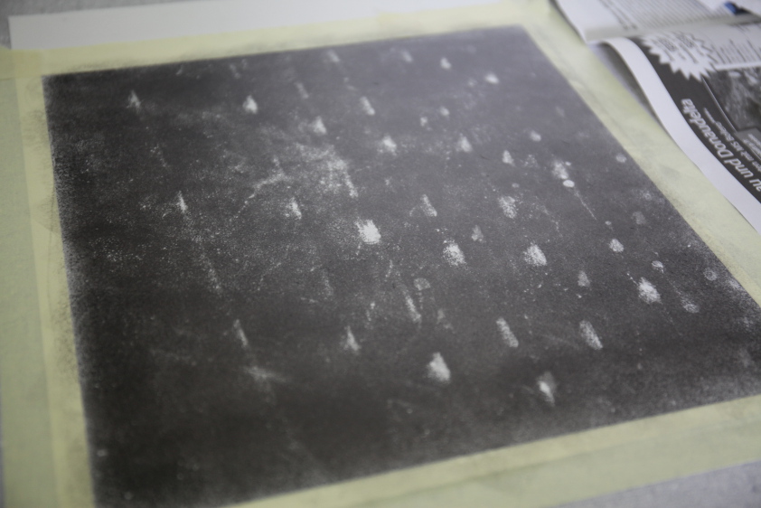

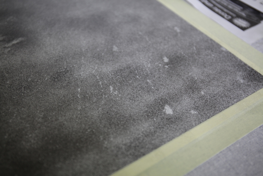

This is what my inking looks like:
1) First layer. The only place where the ink doesn't stick looks like a paper defect. (left/below center)
2) Light application of second layer, after being put for another 2-3 minutes into water. First layer is peeling
off in places
3) Continuing with application, ink sticks except for places where the emulsion (?) lifts off, it seems the pattern is maybe pattern of rollers while being coated.
4) Using a roller I can take off the top layer easily, the stuff under seems uniformly smooth. At this stage I would see some hints of an image if the paper was matte ilford FB IV. At this stage it's just experimenting, since the second photo it was clear I'm not getting anything out of it.
