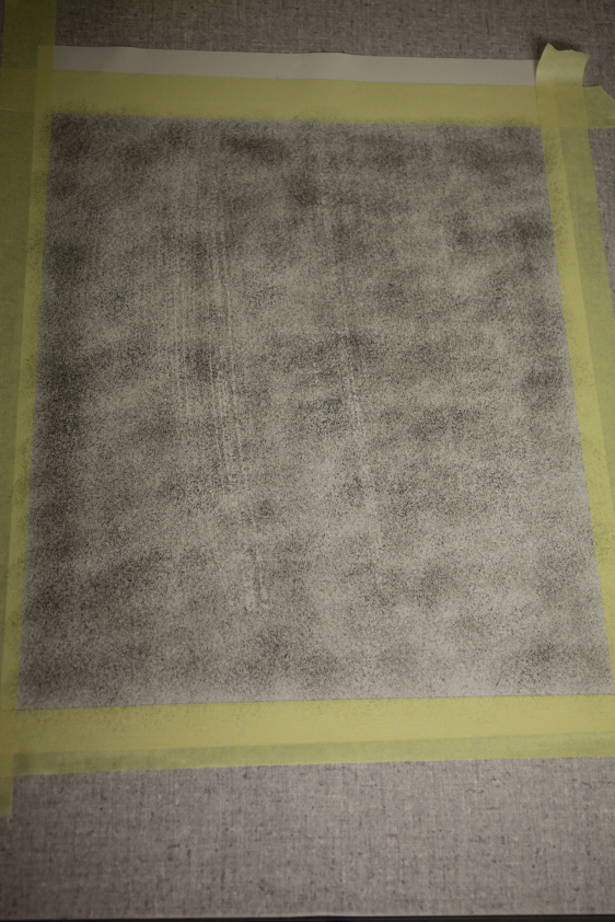

Here is the last attempt:
After first light coat
After second coat:
Note that the only thing shown immediately is what looks like damage to the top layer, I do not know what from.
Thanks for all the help so far. I think next step would be to replace fix with hypo and perhaps try something like rodinal or XTOL for developer. (My options are rather limited, everything takes a lot of time and I need to adhere to relatively strict disposal rules.)

Soaking time is not the problem - I soak Foamabrom Variant IV 123 for about 7 minutes at room temperature. When you take the print out of the soak I assume that you are removing all surface water.
I am running out of ideas otherwise. I'm not sure where you are located but if you are in the D.C. area then you could stop by one of my workshops and observe - there must be something fundamentally wrong since you are getting nothing (my mistakes normally get me at least some results, with the exception of the time I incorrectly weighed out my chemicals).

Sadly, I'm in Europe, and D.C. is quite out of the way even when I travel to the US. I think what I'm getting is consistent with hardening fix. I assume hardening fix would make gelatine not take in water at all..
simple hypo with nothing else is safest and cheap

I do not claim to anything of an expert when inking bromoil on "normal" paper... BUT the images you showed us last (post 26) reminds me of what I can get if I soak too long ! not too short... (and the vertical lines seems to be a result of extra swelling of the gelatine after you have wiped the water off (not carefully enough)....
So why not try a much shorter soaking time?

I can try soaking it for shorter time (but I originally tried about 5 minutes in about 15 degree water and got nothing), but I would be surprised if that gave me something if I get nothing whatsoever. Having the lines from extra swelling of the gelatine from standing water seems unlikely as well, I checked that I don't have any remains, to me it is more likely that it happened while wiping off the water after processing- grain of sand damaged the paper and perhaps gelatine under a hard upper layer was cracked and exposed to water.

Correct, if you are using fix with hardener in it then you are not swelling the emulsion - if you are using hardening fix then definitely change to sodium thiosulfate (I use quick fix without the hardener added).
When I soak too long the ink does not initially take, but as the paper eventually dries out the ink starts to be applied.

I fixed with ilford rapid, as that was the only thing nearby that certainly doesn't contain hardener and there is progress! Initially the dabbing-with-a-brush approach left ink everywhere equally, but when I started smearing it it started catching in some places more than in others. It is still far from the ease of applying that can be seen on youtube videos of both people that have been doing it for decades and people that are doing it already for 3 days, but a starting position is a starting position!

Not sure what you mean by smearing. Are you using a stiff brush and tapping the paper?

I am using a shaving brush. Initially I used a hog's hair brush but the only one I managed to find locally shed immense ammount of hairs. When I tap on the paper, ink distributes everywhere in equal amounts, in fact, it's only when I remove it that it forms a image. So essentially, what works is first applying a lot of ink, then brushing it away, potentially after re-wetting the paper once it gets too dry. I think it's now that the little details (precisely long/warm soak, pre-drying in a oven, ... start being important.

A shaving brush is too soft. Try a pastry brush.

I use a shaving brush but only after resoaking when I want to very lightly remove ink in a generalized area. I would suggest that it is much too soft. I use Bostick & Sullivan's American Bromoil Brush (http://www.bostick-sullivan.com/cart/home.php?cat=42), as it is relatively inexpensive and, for me, has just the right amount of spring.
Perhaps you are using too much ink. I spread out about a pea's worth which is plenty for an 8x10" print.

tile or plastic plate three peas different stiffness... use the stiffness that works... the process is about brush control... use several sizes of print smaller... waste a box of paper before you go big.
