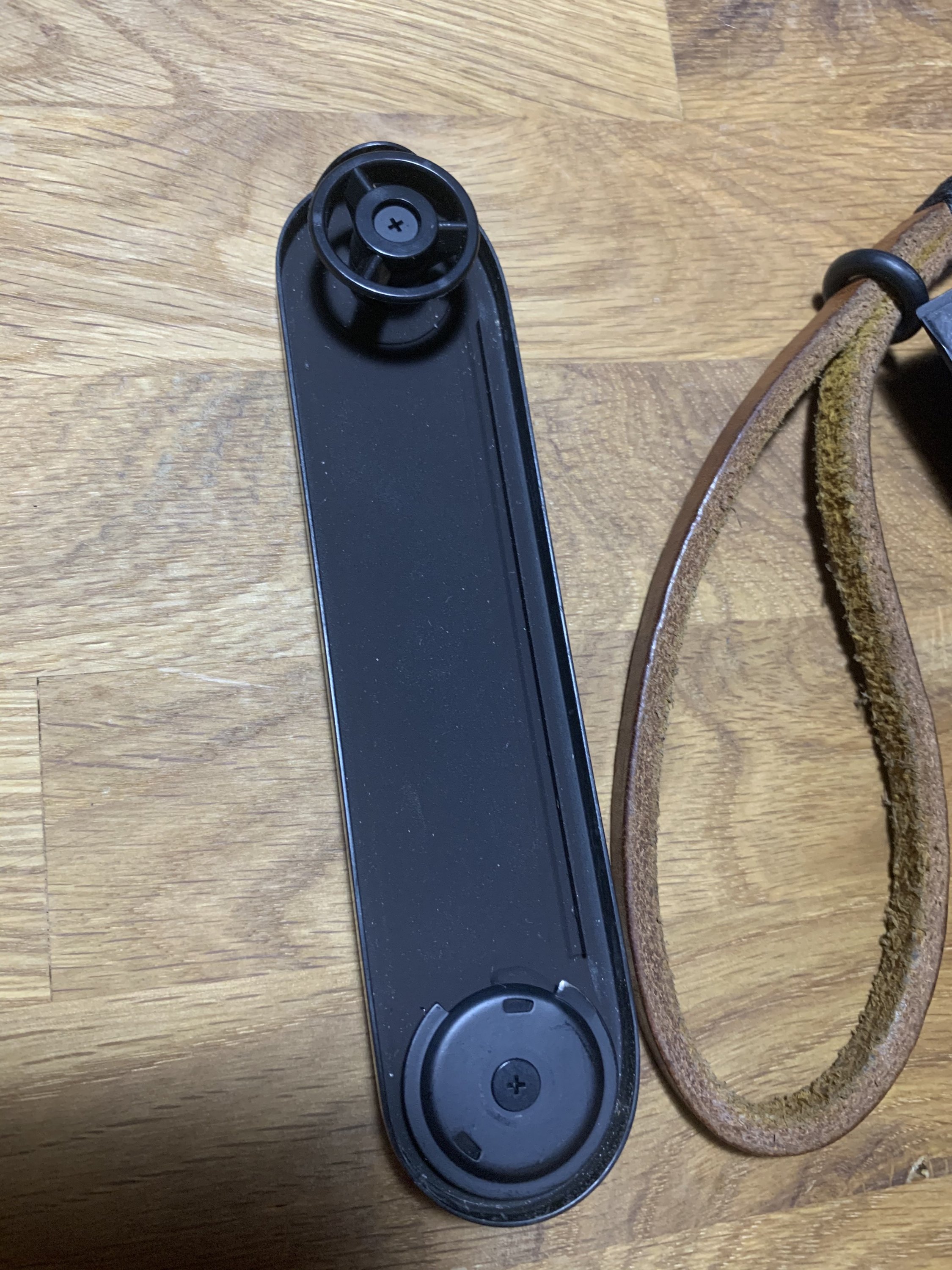

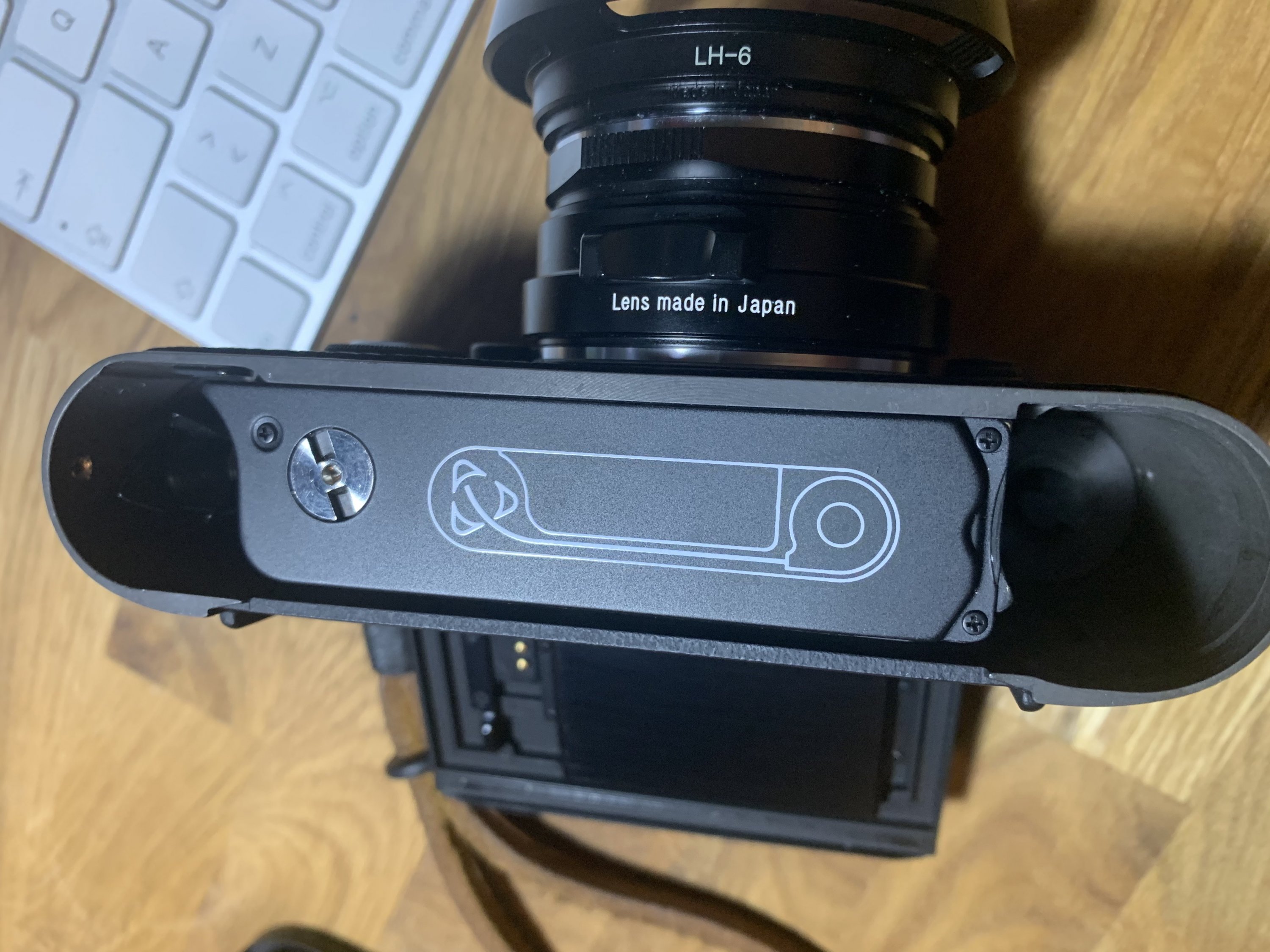

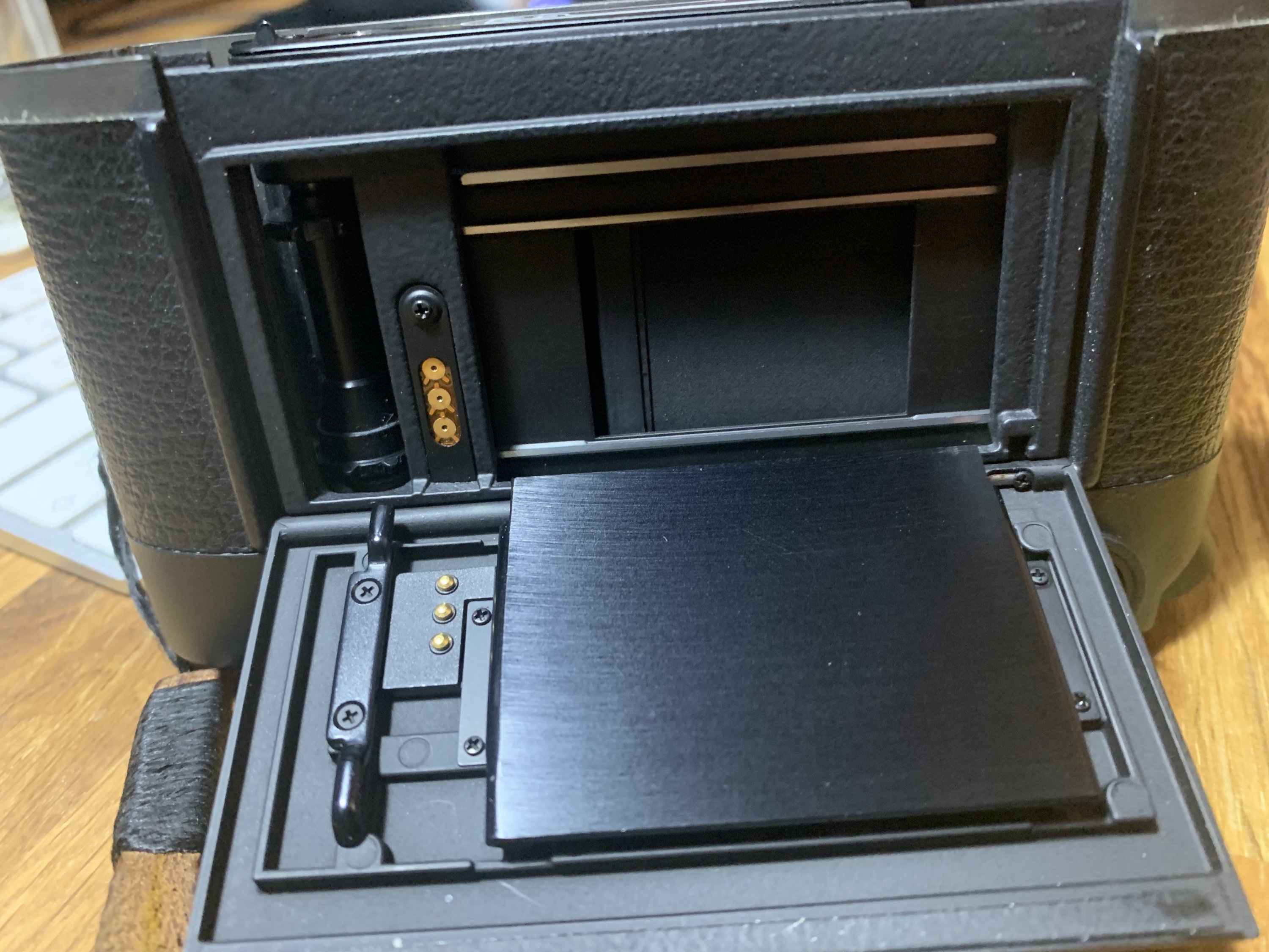

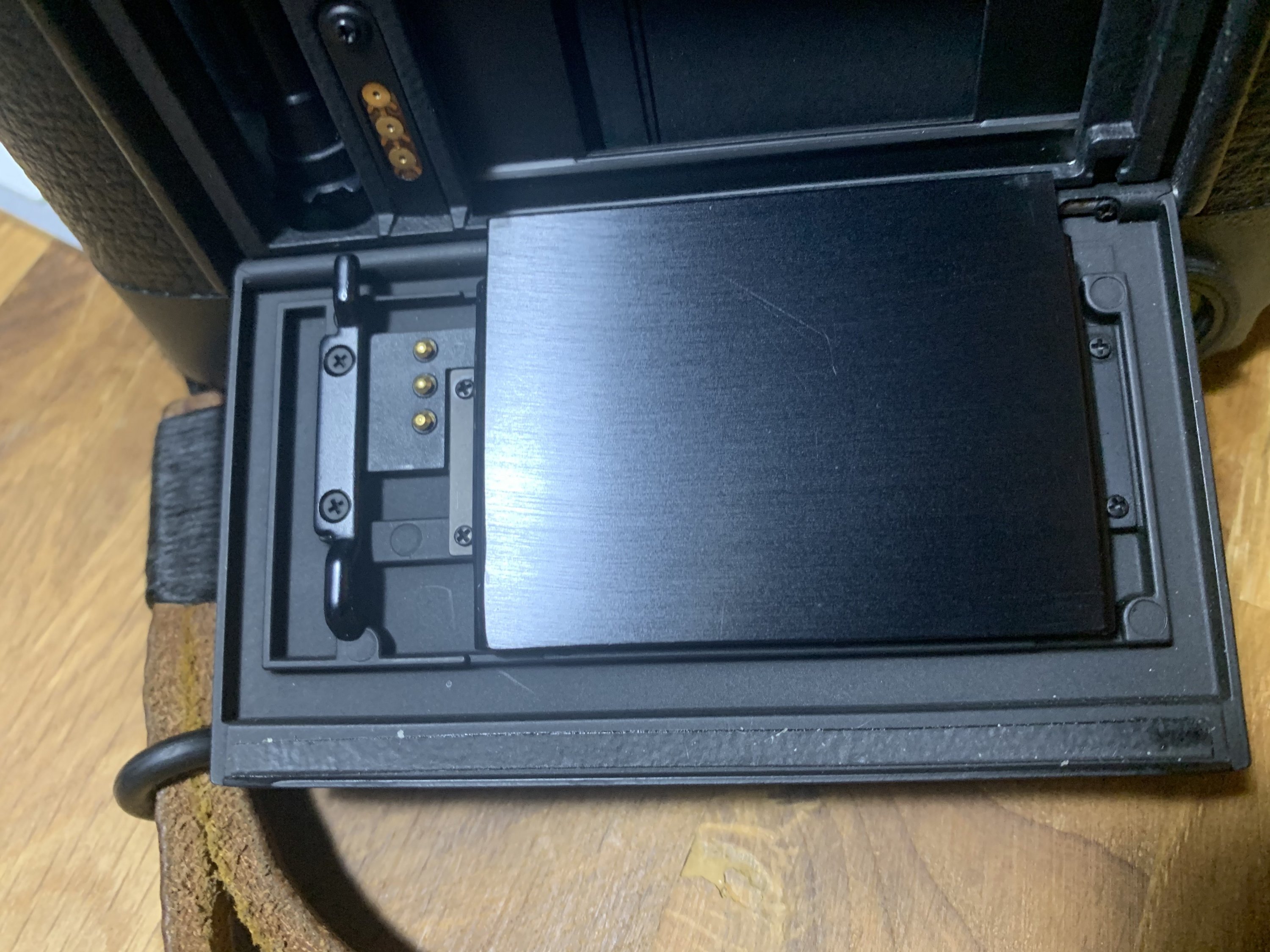

Is the only way to get it to a Leica center to check this or can looking at the camera give any hints? I took a few pictures of it open now.
View attachment 259865 View attachment 259866 View attachment 259867 View attachment 259868
Thanks; I'm not familiar with Leica cameras or their ecosystem. Judging by your negs, it seems likely light may be leaking through the back around the take-up spool when the film is static in the camera, and is being shielded by the sprockets. Bear in mind though, light doesn't always fog film adjacent to the leak; it could be on the other side of the camera.
Yes, it's probably best to get the camera to a service centre and show them the negatives. You might pay a bit of money but you'll have a fully working camera and guaranteed workmanship.
You might be able to search for a D.I.Y. solution on your favourite search engine. If you need a temporary fix, you could stick black insulation tape around the film door and pretend it's an expensive Holga... :smile:
Best of luck. :smile:
