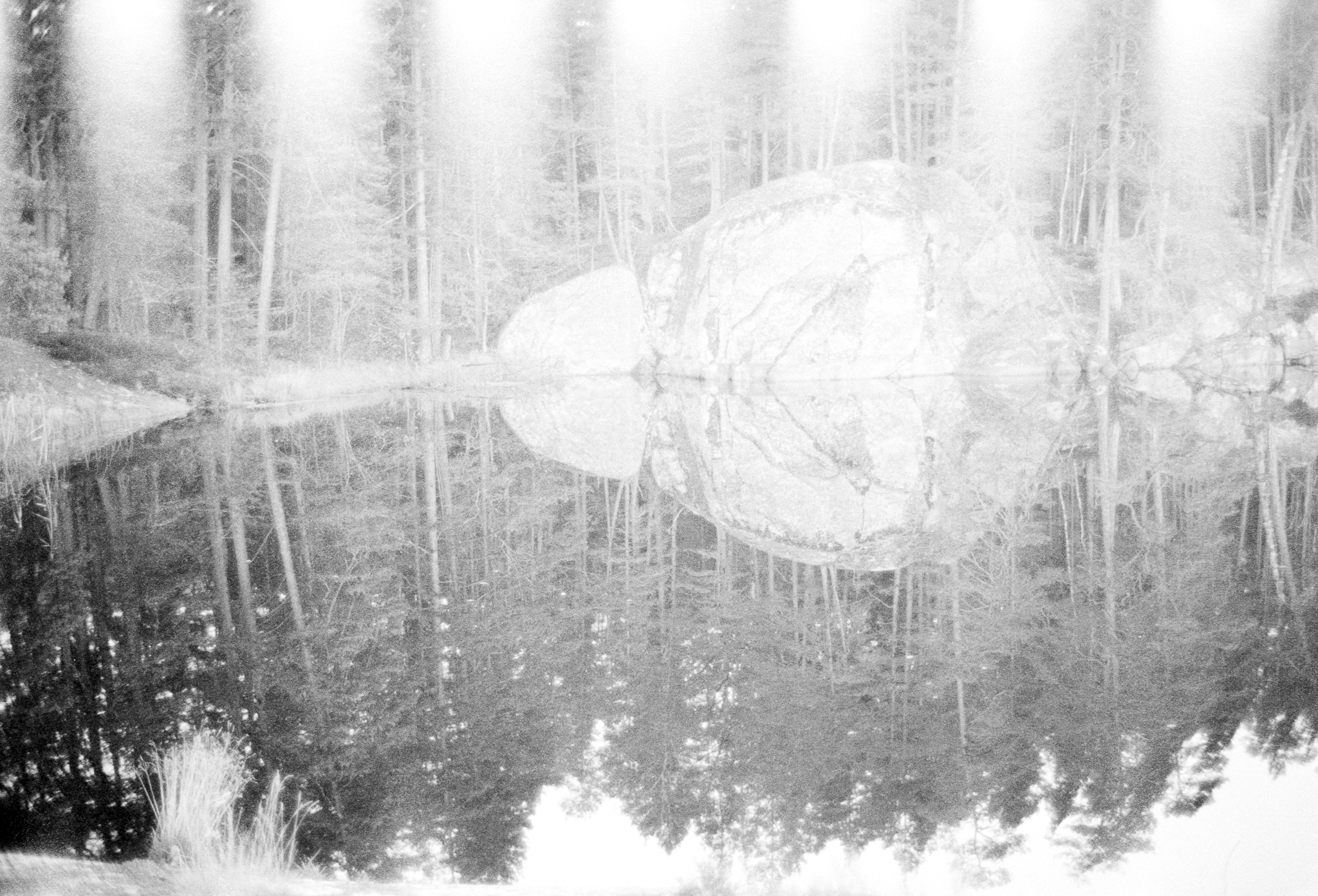

I've developed some HP5+ pushed to 800. Used HC-110 at dilution B (1:31) for 10 minutes. Agitated for the first 30 seconds, then 12-15 seconds every minute starting at 1:00. Stop for 30 seconds and then fix for 3:30.
Negs come out with lines that I figure can be bromide drag but I'm unsure. The process is the same as I usually do without this effect but I have come up with this effect a couple of times now and not sure what the reason can be. I usually don't get it with Tri-x 400. Photos have been shot outside in quite moist weather if that has any effect on it?
Shooting with Leica M6 and Voigtländer lens. Trying to figure out if there is anything wrong with my process if it's some technical thing with the camera?

So we are looking at negs here? The first one looks like a print to me and strangely "foggy" all over. In the second one are the white streaks examples of what you suspect as bromide drag? Can you take a digital picture of each negative and show us that?
Bromide drag is usually associated with lack of agitation and your agitation method certainly does not lack agitation.

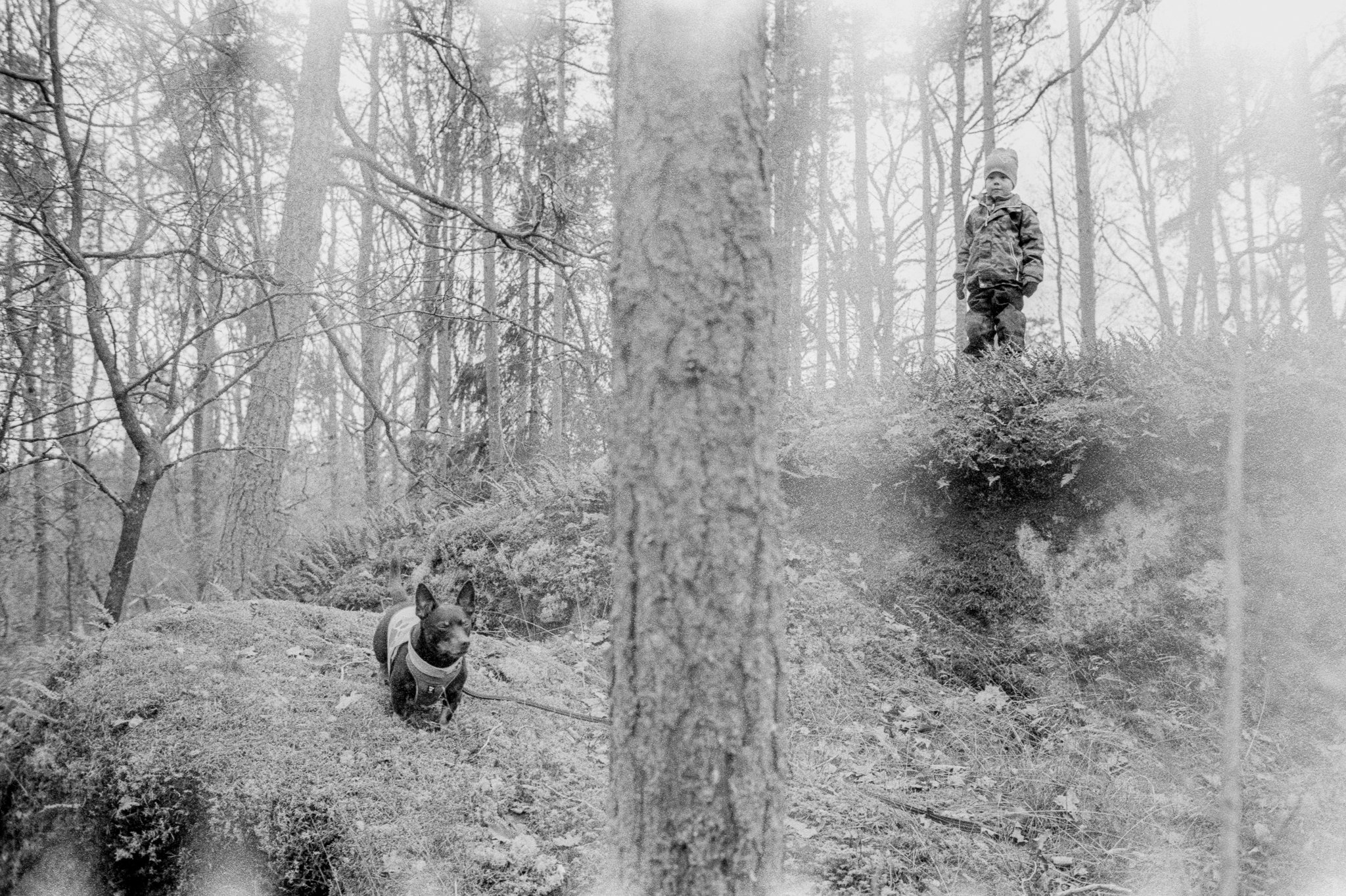

These are scans of the negs, but you can clearly see the lines on the negs as well. These are scanned with Plustek 8100 and exported to jpg from Lightroom.
It was a foggy day so the pictures are expected to be foggy, but on the first one, you have white lines coming from the left into the picture and the second from the top.

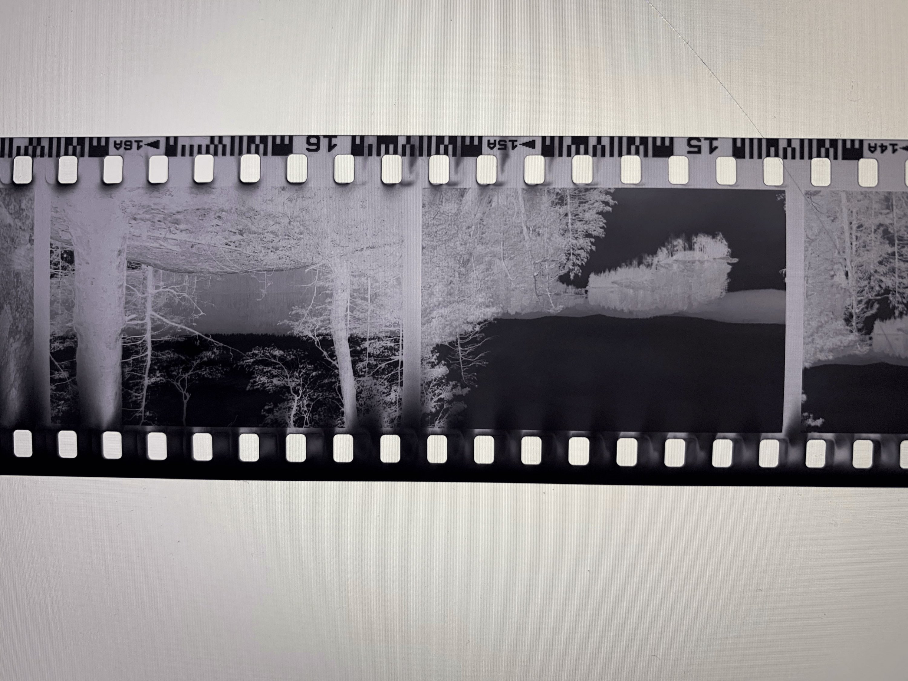

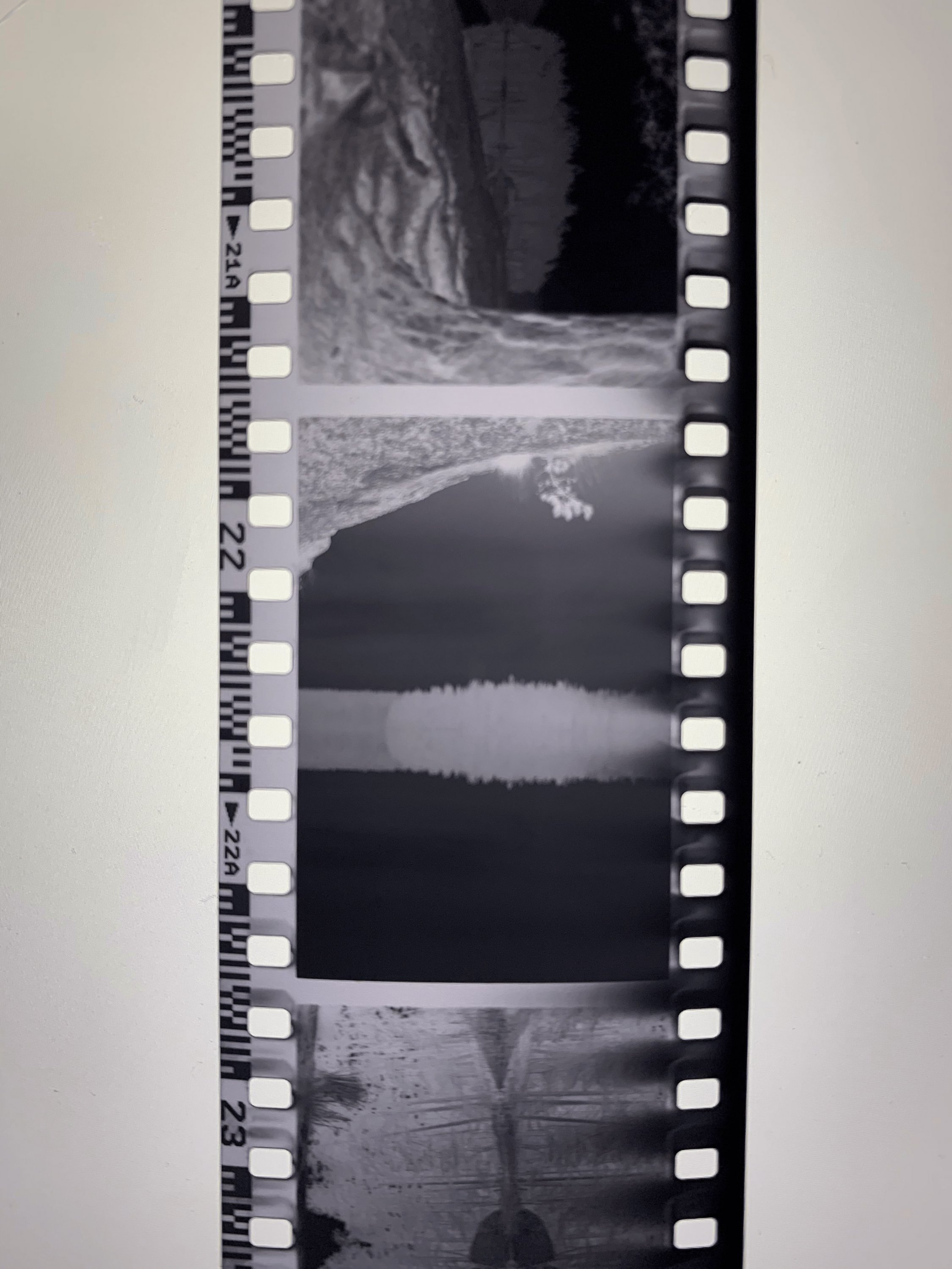

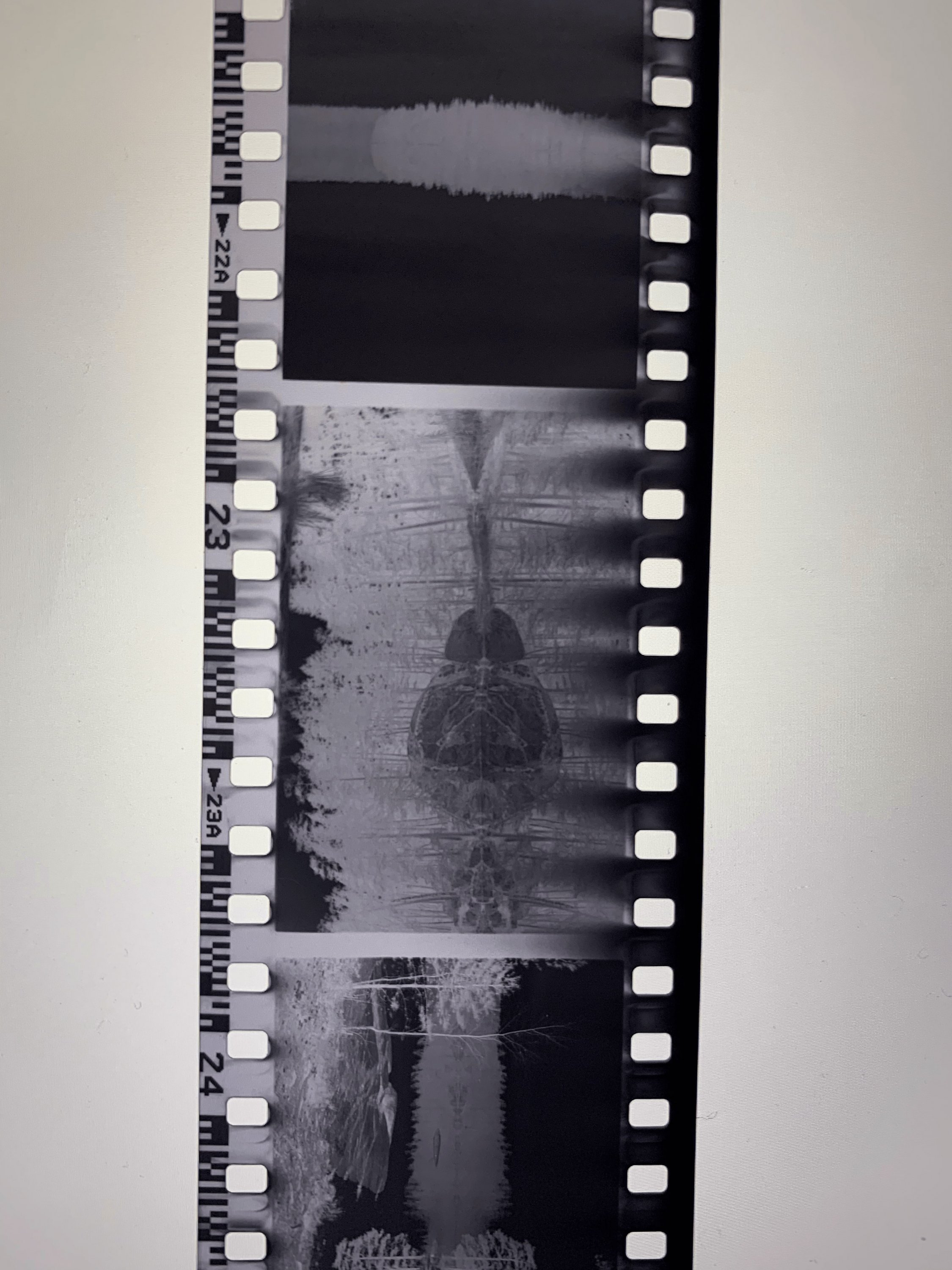

Here are some negs, hope that can give you a better clue. Some of the negs have the issues appear more clear than others but it's there on all of them when scanning.
I used 300ml of liquid in a regular Paterson 2 reel tank with only one reel in as I always do. From what I can recall the reel was at the bottom of the tank.
Edit: on IMG_8062-min.jpg you can see it in the bottom of the negs. Was confused when taking the picture

No, those are light leaks to me

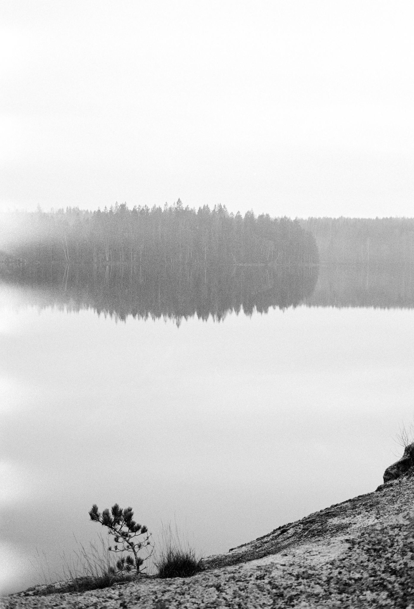

Here is another picture from the same roll. This day the weather was not so foggy nor sunny.
I have a roll in the camera. Maybe it would be a good idea to try with more liquid. 400ml or something just to rule out that issue.

They look like surge marks to me.
10s agitation every 30 seconds seems excessive and a single reel loose in a 2 reel tank sounds like a recipe for surge marks.

Its not a light leak as the pattern follows the sprocket holes if you look at image 8059.
Actually looking again it looks like more than one thing has gone wrong here as the film edge isnt clear either on the side with the sprocket pattern.
Quite a lot seems to have gone wrong!

The density at the top edge is from a light leak... Which is a more serious issue then bromide drag. You'll have to find where the leak happened. For bromide drag, next time have more stock developer, or increase agitation cycles.
Craig75
May 9, 2016
1,234
Uk
Its hard to see how you could get such a perfectly straight light leak though.
The other side of the film edge is pretty dirty in places too but none of it is in image itself. That side looks like surge marks too as its all around the sprocket holes just to a milder degree than the other side.
