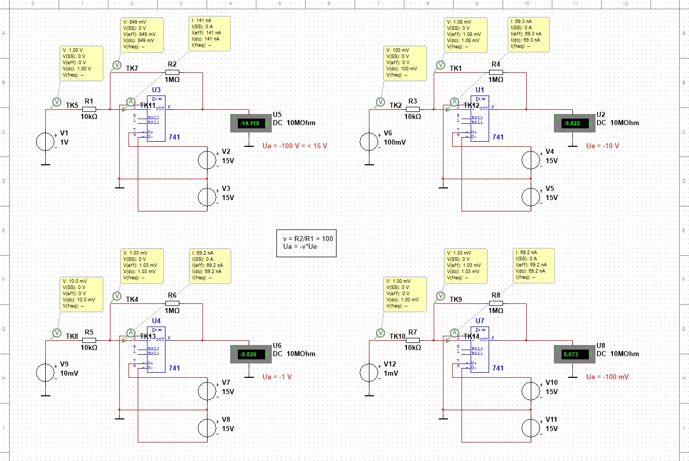

I am currently going through the basic circuits with the operational amplifier.
Here is the inverting amplifier with negative feedback simulated with NI Multisim.
The output voltage can be set using the two resistors in the circuit.
A maximum output voltage of around 1 V below the operating voltage is possible.
Here I learned that the lower the input voltage, the greater the deviation from the calculation using the formula.
The reason for this will be interference voltages, which are noticeable here.

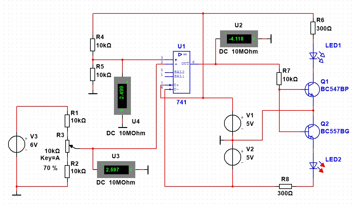

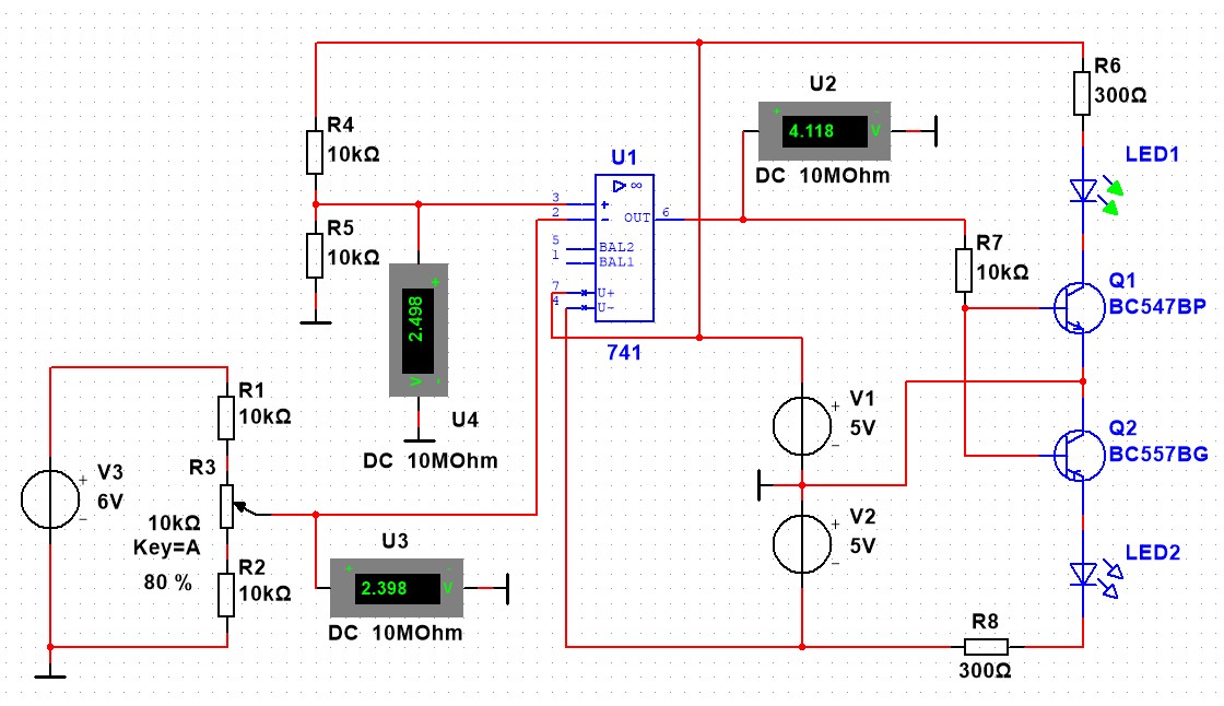

Here the operational amplifier is working as a comparator.
The task of this circuit is to compare two voltages.
One of these voltages is the reference, the other the voltage for comparison.
The reference voltage can be seen at the top left and is 2.498 volts.
The comparison voltage is shown below and is 2.398 volts, so it is smaller.
In this case, the comparator produces a positive output voltage, which can be seen at the top right. It is +4.118 volts.
The green LED lights up.
Here the comparison voltage is greater than the reference voltage.
The comparator now outputs a negative voltage.
The red LED lights up.

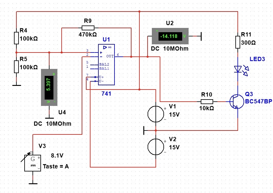

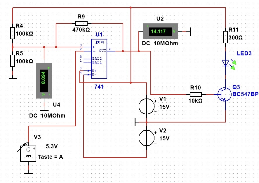

The last application of an operational amplifier I would like to introduce here is the Schmitt trigger.
As with the previous example, this is a comparator that compares two voltages.
Depending on the result, the output voltage is either positive or negative.
Here, even the smallest voltage differences are sufficient to switch.
If the reference voltage is 5 volts and the comparison voltage is 5.01 volts, for example, the comparator switches the output voltage.
This allows an exact changeover point to be set, but this is not always advantageous.
If the comparison voltage fluctuates around the changeover point, the comparator switches constantly. Eg. 5.3, 4.7, 5.6 volts etc.
This would mean, for example, that a connected LED is constantly flashing. Or the display lighting in the viewfinder of a camera, which
reacts to changes in the brightness of the environment.
To avoid this the Schmitt trigger expands the comparator with what is known as positive feedback, which creates two changeover points that are separated in terms of voltage.
For example, the LED could be switched on at 5 volts but only switched off at 3 volts. Voltage changes between these values do not affect this; the LED does not flash.
The Schmitt trigger was invented by American scientist Otto H. Schmitt in 1934 while he was a graduate student.
The Schmitt trigger can be constructed from individual components such as transistors and resistors or mainly with an operational amplifier.
It is an ingenious circuit based on the principle of voltage dividers and positive feedback.

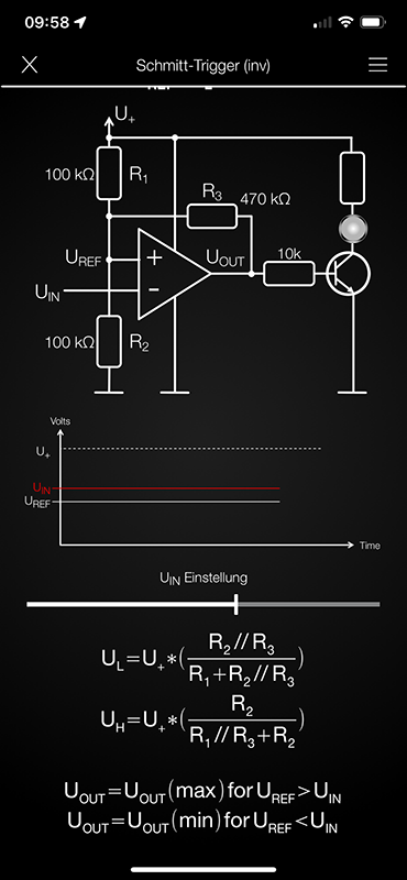

In this example, the LED on the right is switched off at a reference voltage of 8.1 volts (DC voltage source, see bottom left).
By returning the output voltage to the reference voltage (see positive feedback via resistor R9), the lower changeover point (UL) for switching on the LED is formed, which is approximately 5.4 volts here.
When the reference voltage is reduced to 5.39 volts, the LED switches on again.
At the same time, the upper changeover point (UH) is set at approx. 8.1 volts using the same positive feedback principle.
The two changeover points can be set using resistors R4, R5 and R9. They can either be further or closer together in terms of voltage, depending on what you want.

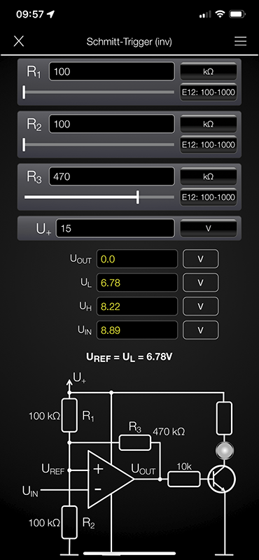

To build a Schmitt trigger with an operational amplifier, you don't need to understand the theory behind it and the interplay of the voltages.
You can use an electronics app, for example, that shows the circuit and calculates the values for the changeover points.
The corresponding formulas are also given in case you want to calculate the values for the circuit yourself.

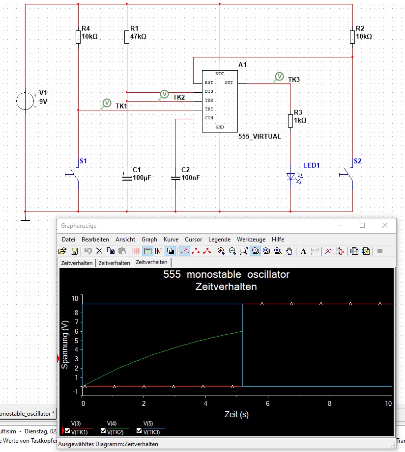

I recreated this circuit in NI Multisim (see above).
My values are slightly different, but that probably has something to do with the OP 741 I used. The app shows a generic operational amplifier.

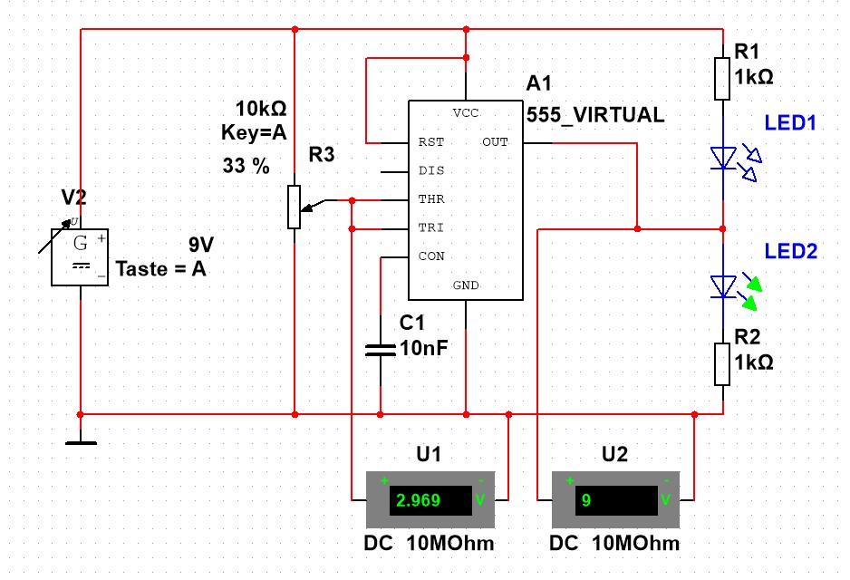

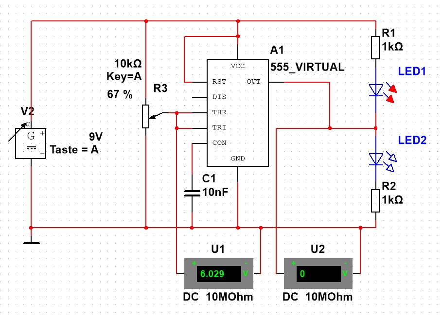

A Schmitt trigger can also be built using the 555 timer IC.
The 555 IC contains, among other things, a voltage divider, comparators, a flip-flop and an output stage.
This module can be used to build timers, pulse generators or oscillators using additional external components.
The 555 IC contains 25 transistors, two diodes and 15 resistors.
See
In the following circuit as a Schmitt trigger, the 555 IC controls two LEDs.
At an input voltage of 6 volts the red LED lights up.
If the input voltage drops to 3 volts, the green LED lights up.
This creates two separate switching thresholds. The corresponding voltage difference is called "hysteresis".
For details of the circuit, see:

koraks
Nov 29, 2018
27,510
Europe
Which for a Schmitt trigger is quite essential, and one of the main reasons why they're generally not implemented with an opamp. The usual solution is to use a dedicated Schmitt trigger IC. They're not very commonly used today as discrete parts since they're integrated on the GPIO's of microcontroller as well as the digital inputs on a plethora of IC's.
I have already seen a 555 IC in the circuit diagram of an SLR, but I can't remember which one it was.
There are different types of 555's, but the difference doesn't mean that one is used as a Schmitt trigger, an oscillator, flip-flop etc. The difference is usually in voltage rating and power consumption, not to mention package size. The application is determined by how it's implemented. So just by noting there's a 555 in there, you can't already say what it's used for. You have to look at the context for that.

Andreas Thaler
Nov 19, 2017
4,863
Vienna/Austria
Working with an integrated circuit using the example of the 555 timer IC
If you work with discrete electronic components, you can deduce the circuit based on their known electrical properties.
In this example, an LED is controlled by a transistor.
The currents and voltages in the circuit can be calculated directly using formulas.
The calculation is based on the following values, for example:
  • voltage drop across the LED = 2 volts,
  • current through the LED = 10 milliamperes,
  • voltage drop across the transistor base-emitter path = 0.7 volts,
  • voltage drop across the transistor collector-emitter path = ~ 0.1 volts, etc.
The connections are visible; if the circuit is not too complex, you have an overview and understand what is happening where.
It is different with integrated circuits (ICs) ...
... which contain a large number of discrete components such as transistors, resistors or diodes.
Here, the relationships are not visible.
You only have a housing from which connections (pins) lead:
Which pin stands for what and what it is used for can be seen from the IC's data sheet.
This means that you have to learn how each IC behaves electrically and cannot draw any direct conclusions because the internal circuit is unknown or too complex („blackbox“).

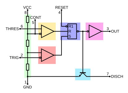

If you have a block diagram of the integrated circuit, you can deduce what happens in the IC, which is helpful.
The 555 timer IC for example contains, among other things, a voltage divider, two comparators, a flip-flop and an output stage:

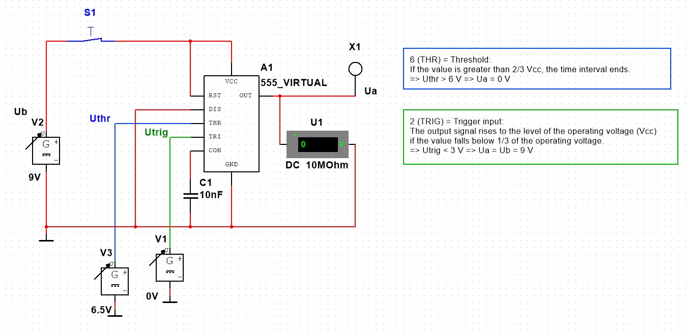

To understand how the 555 timer IC basically works ...
... it is helpful to explore it without additional external circuitry (which determines its function).
This works particularly well with a circuit simulation program where an electronic circuit can be virtually constructed and modified.
All electrical values can be measured and optimized. You then see immediately whether the circuit works as intended or not.

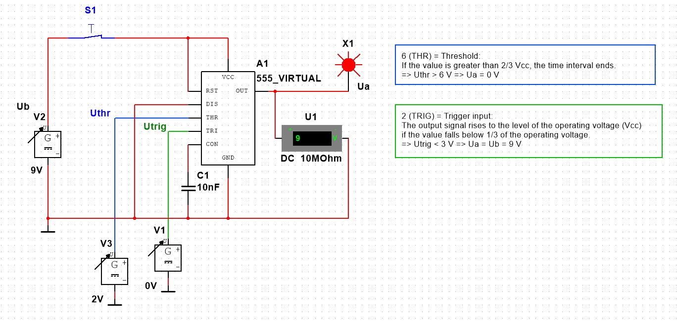

Here the 555 timer IC is shown in NI Multisim.
Its eight pins are labelled, but we will only focus on those that are required for its basic function.
In order for the IC to work, it needs a DC supply, which can be seen on the left in the picture and is 9 volts.
The IC is controlled with voltages via the "Threshold" and "Trigger" inputs.
The conditions for these inputs can be seen on the right.
The reason for these conditions is the internal circuit of the 555 timer IC, which cannot be seen here. So we take the IC as it is.
In this state, switch S1 is open, so no current flows through the 555 timer IC, it does not work.
Now we close the switch.
We see that a test lamp (right above, indicating HIGH) lights up at the output of the 555 timer IC and the voltage at the output is 9 volts.
Why this is the case is clear from the conditions on the right.
The voltage at the trigger input is 0 volts and is therefore less than 1/3 ( = 3 volts) of the operating voltage of 9 volts.
The 555 timer IC then switches its output to the level of the operating voltage, i.e. 9 volts.
Now we raise the voltage at the threshold input from 0 volts to 6.5 volts.
This causes the output voltage to drop from 9 volts to 0 volts and the test lamp no longer lights up (indicating LOW).
Here too, the conditions on the right indicate why this is the case.
Since the voltage at the threshold input is 6.5 volts, which is greater than 2/3 of the operating voltage (= 6 volts), the 555 timer IC switches its output to 0 volts.
Now we reduce the input voltage at the threshold input from 6.5 volts to 2 volts and see that the output voltage goes back to 9 volts (HIGH).
The condition on the right is that the output voltage is only 0 volts if the input voltage at the threshold input is above 2/3 of the operating voltage.
And since the current 2 volts are below 2/3 of the operating voltage, i.e. 6 volts, this is not enough to set the output to 0 volts.
Once you have understood this basic operation of the 555 timer IC, you can explore its remaining connections and then look at ways of connecting it to external components.
This way you can build timer circuits, oscillators or even a Schmitt trigger, as we saw above.
I realize that circuit diagrams, numbers, formulas and conditions are not everyone's cup of tea.
Just as my attempt to explain the basic function of a 555 timer IC might be too simple for others 😌
But everything here follows rules and principles that can be learned. Even if it looks confusing at first glance.
I can therefore recommend working with electronics, no matter what level, to anyone who enjoys finding out connections, understanding processes and doing a bit of math.
And I hope it will help to understand the electronics in cameras a little better 🙂
All information provided without guarantee and use at your own risk.

If you leave out the transistor and R2, the circuit will do the same.
What am I trying to do with this example?
To show that a discrete circuit with a few components is easy to understand and the voltages and currents are understandable as long as the circuit is not too complex. In contrast to an IC. Whether the circuit makes sense or not is irrelevant.

Finally, here is an example of how you can use the 555 timer IC as a time-controlled switch.
Monostable flip-flop (source: Jacques Vrey: The 555 Timer – Basic electronics introductory course)
The 555 timer IC cannot do anything on its own; it must be connected to electronic components and voltage.
The idea in this circuit is to make the LED at the bottom right light up for around five seconds by pressing a switch once. After that, it should go out again.
Trigger and threshold work together
If you press the switch (S1) that is connected to the trigger pin of the 555 timer IC, it is set from 9 volts to 0 volts and the IC activates its output. Current flows and the connected LED lights up.
At the same time, the electrolytic capacitor (C1) connected to the threshold pin is charged, which takes a certain amount of time. As soon as the voltage on the capacitor has reached a certain level, the 555 timer IC switches off its output and the LED goes out.
Capacitor and resistor regulate the lighting duration
The duration of the charging process depends on the capacity of the capacitor and the amount of current that flows into it per second. The amount of current is regulated by a resistor (here R1). A capacitor with a larger capacity takes longer to charge than a capacitor with a smaller capacity.
So by connecting the 555 timer IC to additional electronic components, you can create a so-called monostable flip-flop that allows current to flow for a certain time. In our example, this is through an LED.
Below the circuit diagram you can see time/voltage curves for the trigger pin (red), the threshold pin (green) and the output (blue). They show what happens when the switch on the left (S1) is activated.
