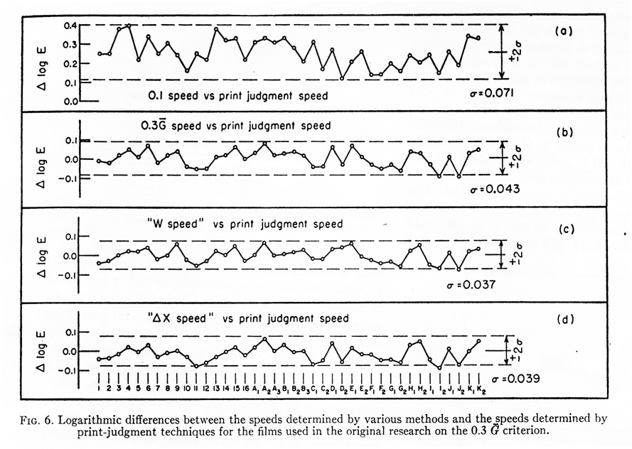

This is the first part from one of the two key papers used in the decision to change the standard in 1960 and is where the Delta-X Criterion originates. C.N. Nelson and J.L. Simonds, Simple Methods for Approximating the Fractional Gradient Speeds of Photographic Materials, Journal of the Optical Society of America, V 46, N 5, May 1956.
part 1
View attachment Approx Fractional Gradient Speeds.pdf

Bill, you're under selling the importance of the first excellent print test. The speed method resulted from the first excellent print test was the first to link exposure criteria to perceived print quality. W.F. Berg explains it very nicely in his book Exposure Theory and Practice, "In his book the whole of the exposure problem is treated from the point of view of obtaining a satisfactory picture; it has been stressed over and over again that the quality of the picture is the factor which decides what exposure should be given. This consideration outweighs all others when it comes to choosing the speed criterion, since on its choice, together with the conditions of the subject, will depend the camera exposure to be given.
Thus all those speed criteria must be rejected which are based merely on a property of the negative material alone; unless and until it can be shown that this property is intimately liked with the quality of the print. Nevertheless, speed criteria are in practice invariably determined from the behaviors of the negative material alone. Where progress has been made in recent years in fixing a sensible criterion, it has been in the direction of linking print quality with the characteristics of the negative material...
We consider as our next speed criterion that introduced by Jones and adopted both the American Standards Association and the British Standards Institution. With this criterion, we complete the circle which started from a purely academic linking of the speed with an almost entirely arbitrary property of the characteristic curve, then led us to the purely practical concept of speed, to end up with what appears to be the most successful attempt so far of connecting print quality with a characteristic of the negative material.
Realizing that speed must be based on print quality, Jones decided to make a large number of exposures on a large variety of subjects on many negative materials and to submit the prints to a number of observers who were asked to judge the print quality. These prints were made on a grade of paper best suited to the negative in hand, i.e. on hard paper for underexposed negatives of low contrast, and on medium or even soft paper for the more correctly exposed negatives…
The final step was to link this criterion with a property of the characteristic curve. The point was to find that characteristic of the negative material which best tied up with the exposure necessary to yield the first excellent print."
Not sure where you found that the study concluding some of the shadow detail wasn't important. Jones' conclusion kind of contradicts that.
No one said the Zone System speeds were based on the fractional gradient. There's no indication Adams was aware of it or would understand it if he was. What he was trying to do is to come up with a testing method that can be done by the photographer that will approximate the ASA film speed. Which he did. My argument has always been about understanding the test. I don't care if the Zone System produces an almost universal 1/2 to 1 stop slower results than the ISO speed. Just don't call it "true" or "correct" speed. Personally, I believe the reason there is so much emphasis on determining a personal EI with the Zone System is because you can't test for the aim contrast without it. Otherwise, I can't see the purpose of doing such an imprecise test.
Finally, I'll just touch on this point for now, the speed point isn't necessarily where the shadow exposure is intended to fall. The fractional gradient point is approximately one stop below the ISO speed point, yet the pre 1960 speeds were twice as high as today. The reason why the density of 0.10 over Fb+f was chosen for the speed point in the current ISO standard was not because it represents the minimum useful exposure, but because it is easy to find.

Looks like I am wrong to associate Print Judgment Speed with 0.3G speed. This compares them as three different criteria.
Basically, the print judgment speed is the most accurate method of determining film speed. It is based directly on the finished prints; however, it is incredibly laborious and therefore impractical to do on a regular basis. The next best method is to find a mechanical approach that will yield speeds similar to the print judgment speeds in the majority of cases. The fractional gradient method is that method. Fixed density methods were evaluated but weren't as consistently accurate. The fractional gradient method was determined by finding the spread between the proposed method and the speeds resulting from the print judgement speeds. Just like the spread example with testing alternative methods to the fractional gradient method. Of the three methods shown, the fixed density 0.10 method had the highest degree of spread and therefore the least consistently accurate to the print judgment speeds.

Interesting that W speed, Delta X speed and 0.3 gradient all are reasonable. But heck no to 0.1 speed. And I know you've said that the standards get away with using 0.1 - only because they specify conditions that make them fit 0.3 gradient.
But this is another fun thought for the conclusion...
Maybe we should be designing "print judgment" tests, since they're the best. And we have all this determination to pick a personal speed...
