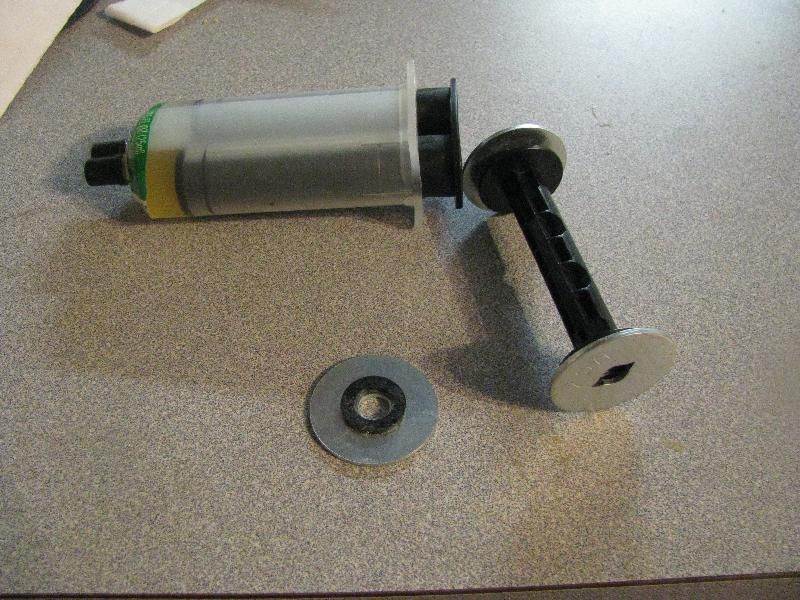

I use HP5+ in my Brownie 2C. Fun cameras. I had to adapt my spools so its a bit wonky but yours should be fine.
