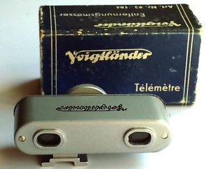

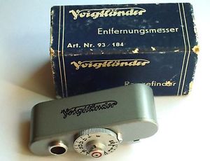

In case you need precision, then something like the Voigtlander 93/184 hot-shoe RF should do it.

If you can find a nice accessory rangefinder for the right price, it can be a real boon on scale-focus cameras.
But just make sure that your camera distance scale and the rangefinder scale are calibrated in the same units (both in feet or both in metric) -- unless your mental arithmetic is quicker than mine :wink:
