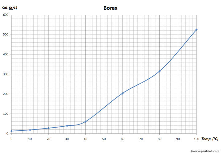

My experience is the opposite. Borax will readily dissolve in a very shallow layer of water provided the water is hot (50C being a lower limit when I do this). This is also reflected in solubility data for borax, which shows two things: (1) its solubility in water is really quite limited, but (2) it increases dramatically as water temperature increases.
Here's a useful link about it: https://www.sciencemadness.org/smwiki/index.php/Borax
Note this chart:

koraks, thanks for #12 which seems to confirm what I wondered might be the answer as I stated above. My whole post was simply to relay what had been said by John Finch and then wonder if there might be an explanation that reconciled that with the need for nearly boiling water if the amount of water vis a vis the amount of borax was much smaller .
What seems clear to me from your experience and graph is that if borax isn't harmed by water that's nearly at boiling point then dissolving it in that is the sensible thing to do. Why bother with the waiting involved in any alternative methods
