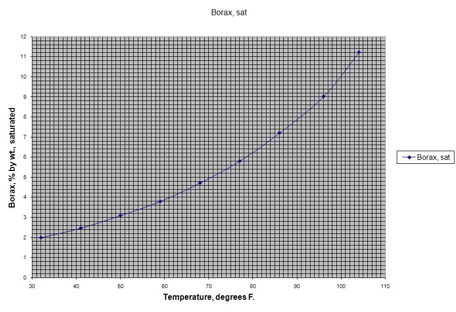

Saturated borax solutions
IIRC, the solubility of borax in water at 20 C is only 4.7 grams/liter.
From the "Dictionary of Photography" printed in England 1943.
Solubility of crystals: 3 per cent in cold, 98 percent in hot water; very little soluable in alcohol, 60 per cent in glycerine.
Saturated borax solutions.
The attached chart should help.
I should send everybody some of this stuff..it's maddening. I got somr grocery store stuff tonight and it dissolves rapidly..EC
Pat - take a closer look of the graph you posted and check the units on it. While the temp on the x-axis is in degrees Farhenheit, the solubility on the y-axis is given in %w/v. And that's the same as grams/100 ml which equals 10xgrams/liter.
So according to your graph, it should be about 47 grams/liter at 20C...
Patrick

Patrick - (welcome back!) - you misread the ordinate. It is 4.7g percent or 47g/L as you so well described in your Borax article.
