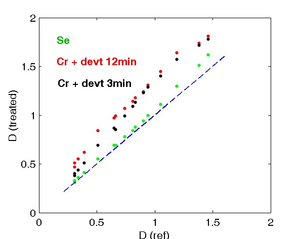

(...) selenium intensification (...) The former is great for negatives developed in non-staining developers. It is easy and adds about one grade of contrast to the negative. Use selenium toner 1+2 for 5 minutes, wash and dry as usual.
Time and again one can see Se toner recommended on photo forums to increase negative contrast. I was dubious from my previous attempts. So I made actual measurements. Neopan 400. Plot shows density (after) versus density (before). Disregard the points for Cr intensification, part of ongoing work. Se curve shows that for initial D=1, the density of Se-treated film is at most 1.05, being generous. I call that less than 1/4 paper grade; hardly worth the trouble. Treatment was Se toner 1+2 20min(!).

All that I can say is that I have found it to be very effective in practical use. On the one occassion that it produced less than expected increase in contrast was when I was in an area with somewhat acidic water. The solution there was to mix 1 part Selenium to two parts HCA (AA recommended mix) and this solved the problem.
Bernard,
I don't doubt your results. As different papers tone differently in selenium, so will different films. Obviously, Neopan doesn't tone well in selenium. I've used this technique with Tri-X 320 sheet film (both old and new versions) with gratifying results however.
Good to know this about Neopan. Have you tested other films? I'm curious now.

Granted, my data is valid only for Neopan400 (developed in D-76 1+1 9:30). Sorry, I don't have data for other films; some future time maybe. For the moment my priority is to find and verify a process to increase the contrast of three important (to me) Neopan400-120 films that appear to have been developed to CI~0.45, and do so preserving the tonal scale.

About conflicting/puzzling results concerning selenium toner intensification:
http://www.largeformatphotography.i...?2082-Selenium-Toner-for-Negs-It-Doesn-t-Work
We might all be right, in a way.
It would seem that different films tone differently, just like different papers do. Intensification using selenium would therefore be film-specific.
Maybe some enterprising soul with lots of test negatives on different film and a densitometer will do a series of tests for us?
FWIW, I use Kodak selenium toner 1+2 for five minutes when I selenium intensify. The toning goes pretty much to completion. I've had luck with Tri-X, and both T-Max films.
