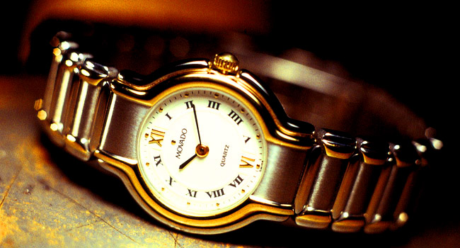

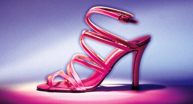

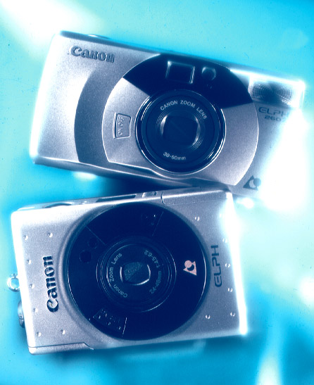

For example - here are a couple shots of a technique I developed in the 90's - these primarily used the modeling lights of my speedo stuff (or flash with full CTO gel), with grids and snoots, on 35mm Tungsten film pushed 3 stops (for the grainy sort of pastel texture) - then the "slides" were projected onto 8x10 sheet film in my enlarger with a small on-camera flash taped to the condenser box to give me daylight color. Products were multiple exposures, sometimes layered on stacked sheets of glass - single products use separate exposures for foreground and background, which made soft halos and silhouettes. These took weeks of playing and a small mountain of 35mm polaroid. I used lighting gels where I wanted intense color, which the pushed film really loved. But at the start, i had a hazy idea of color and texture, and kept my mind open for happy accidents, etc.

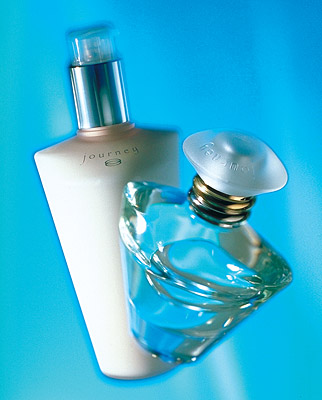

attachment.php
So with this shot for example, are you saying these are on two different sheets of glass, one below the other? And perhaps looking straight down, then changing focus (with the rear standard) for each bottle and exposing each separately on one sheet of film?
If I am envisioning this correctly the rear standard focus will account for the halo, whereas a front standard focus would change the bottle sizes more and make for a much larger halo.
Does this sound about right from your recollection?
M Carter
Jan 23, 2013
2,147
Dallas, TX
Sort-of, Dan - but per the post, these were all shot 35mm for grain.
The lights were aimed on each level/layer, and I'd shoot the top layer, turn off those lights, turn on the bottom layer lights, and refocus on the bottom layer... this made the product on the top layer a soft silhouette that blocked some of the bottom layer. Then I'd light just the BG (the floor actually) and both products would be soft silhouettes.
I did some stuff like this 4x5, but mainly to really rack the DOF all to hell with shifts. Shot some 6x7MF as well, but the 35mm grain with EPJ was just (to me) luscious. That was my favorite film for some time for editorial stuff, and duping it onto sheet film really popped the grain and made it easy to show.
Usually by the time the shot was done, I had so many light stands, booms, and reflectors it was like a cage around the set... the dual products had to be only inches apart to keep the size relationships, lots of tiny black paper snoots, blackwrap, and snipped up metal flashing for reflectors.
The shot of the model, I had tungsten fresnels lighting the back wall, and a strobe on the model, with the modeling light turned off. I'd shoot at, say, a half second - after the flash popped I'd move the camera or twist the focus ring to soften the BG. This was a little difficult, usually I had an assistant on the model light switch. I also did this with two banks of tungsten lights on switches and would call "front - back!!" with longer exposures, racking focus as needed. I would also do the constant BG light with the foreground strobes, and just stick diffusion in front of the lens after the pop - usually just a 4x5 film sleeve rubbed on my forehead... long before the massive choice of diffusion the digital cinema era has given us. Diffusion tricks at least allowed me to stop down a bit more - some of this was really wide-open to get a good focus difference.
Those were some long nights, doing this commercially and waiting for snip tests from the lab in the morning!!! I'd push EPJ 2, 3 and 4 stops. Gorgeous stuff.

Thanks - it's kind of a deep black hole of possibilities... the #1 thing I found was keep my mind open for "gifts from the muse" kind of stuff... the dual perfume bottles, for instance - I was dialing it in, had some blue seamless on the floor. The polaroids had these odd silver streaks that at first I was like "damn it, another thing to fix" and then "that's really kind of pretty..."
Turned out to be the leg of a c-stand, my thought was I'd raise the paper over the floor and stands when all that mess was dialed in... I grabbed some 5/8 pipe from the grip pile and added some more, that's those sort of "rays" of highlight in the background. Thank you, gods of creativity... ya never know when they'll poke their heads in...

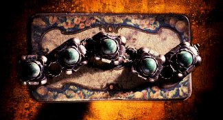

Your biggest problem may be the white or gray reflecting all over the subject and killing the contrast... in those cases, glass or some kind of stand (where the boot hides the pole & base) could help. Glass, you get into a fistfight with reflections! I like the shot, my personal hoo-ha would be hit it with some harder directional light, like it's sitting in hard window light - sometimes that gives a static item a sense of motion and direction (the hard rim of light under the sole seems odd, to me it's like "the bottom is where the shadows are", but then it does add a compositional sort of line... what the F do i know anyway!??!)... but I dig grungy old stuff under the lights.
On the attached shot, I lifted the metal box with a block... but you can see the shadow of the block, bottom left... I think I got tired of messing with this one.
