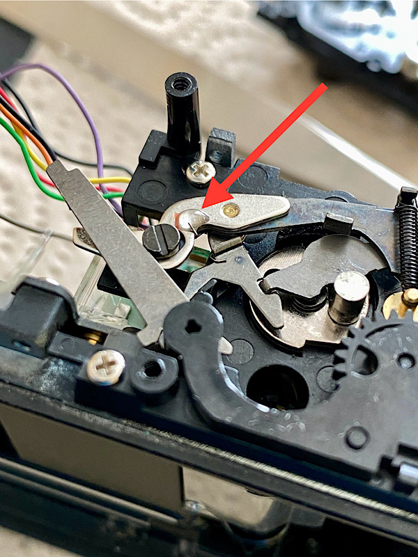

I'm just getting into the subject of bonding and am trying to classify the adhesives I already have according to their area of application.
So far for camera repair purposes I have experience with the following adhesives:
  • UHU extra for low-load connections,
  • Loctite universal and for plastics for permanent connections with medium load,
  • Pliobond for attaching leatherettes and everything that should be removable,
  • and now, for the first time, Epoxy.
I get along well with the first mentioned, I've only used Epoxy once. I'm impressed by the strength and the setting of the latter within minutes.
Nikon F-301: Fixing a spring with Epoxy
Can epoxy be considered the adhesive of choice for all connections that need to be as strong as possible and resistant to force from all directions?
Simply put, no.
E.g., your drop on metal above: two modes of failure. One, the spring wiggles back and forth in operation. This movement extends up to the epoxy. This motion will slowly wear away the epoxy at the interface, allowing for more and more movement, more wear, expansion inward of the range of motion. Until eventually the epoxy is worn away enough for the spring to come undone.
Two, the attachment to the metal. Good chance that this isn't permanent and with enough sideways force it will fail.
Now maybe my possible failure methods are moot in your case because the wear rate of the epoxy will so much slower than the failure time for other parts of the system?
I think of epoxy as a reinforcement of a mechanical connection. So for example your spring- make slot or hole for the spring to seat in. Or thread a screw into the metal lever and attach the spring with this. At the least, provide a mechanical attachment for the epoxy itself- roughen the surface, make holes and divots for the epoxy to form itself into pins and such, etc.
Now there are a variety of epoxies out there. I had a broken camera part and someone who had experience with aircraft assembly suggested an epoxy. It worked well on its own but kept failing in operation becasue of sideways forces. I asked him about it and he apologized, that he didn't understand how small the part was, and that there was no way that his recommended epoxy would handle that situation- too little surface area and too much sideways force.
I know that there are much better terms for what I am saying and maybe someone will use them. And there are varieties of epoxies I have no knowledge of that might handle your spring. I'll be interested what one of the engineering-types has to say.

The spring was previously sealed with red varnish, so I thought epoxy would be at least as good. The remains of the varnish are still visible in the picture.

In relation to my application example with picture, I wonder whether the original red varnish was intended to be used as a fixation or as a sealant, for whatever reason.
If it was applied for the first case, then the next question is whether my epoxy drop is at least an equivalent replacement.
All I can do is test it myself.
In the second case also. To me, it looks like it was there to fix the spring in place especially in the face of mechanical shocks to the camera body (dropping etc.) causing it to be dislodged. No major forces are expected to be exerted on the bond and if (that's a big one, though) the epoxy has bonded well with the metal surface, I'm sure it'll do fine as it is.
If varnish was used, most likely the spring has minimal movement and/or force and low risk of moving out of place. So very likely that a standard off-the-shelf epoxy will do just fine.
Now another thing to think about before you start using epoxy all over cameras: what about future repairs? Can it be undone if need be? Will it need to be undone? Like loctite- using loctite that requires 400F degrees to undo on a camera side panel is a mistake, I would say.

Having never seen a spring secured that way, are you sure that’s a factory procedure or something else?
Also, if red varnish was previously used then why not red varnish again? It’s not like nail varnish is an obsolete material that requires a substitute
I use what I have and what works. Of course, I can't meet the factory standards.
The spring is supposed to be fixed at one end, and that is met.
Likewise, I don't have the range of lubricants that Nikon specifies for the F-301 or other cameras and lenses, as those things are not (longer) available.
