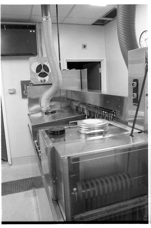

I'll scan the pictures of the BBCs old cine processing machine later tonight. I seem to remember VNF1 was a sort of movie film E-6 developer, from memory the film stayed in the dark until the colour developer step. Certainly the process had a first and colour dev just like E-6. It was a while back I think 1984-85 when I worked there so forgive me if I can't remember. They mothballed the machine in 1985 to replace with a VT suite.
Here are 2 quick scans:
the machine was a Photomec (tec) ?

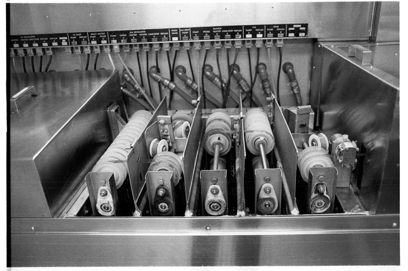

Hi Tom yes it was installed at BBC East in Norwich at All Saints Green, Anglia TV had a similar one they ran on until the 90's

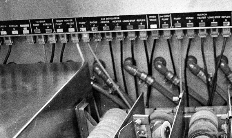

The pipes and wires are replenshishment, heaters and circulation pumps from memory
Iv'e done a crop of the rack shot:
No too clear as the point of focus was on the film racks not the pumps.
The machine was a continuos leader type in the bottom shot you can see the leader magazine at the far top which is where the unprocessed film went.

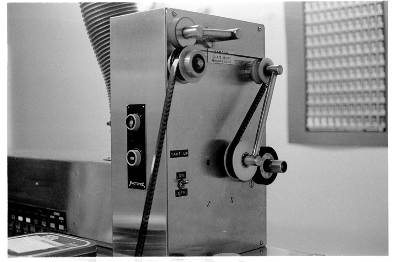

Scanning some more of my old negs i found one of the take up mechanism. It had a toggle switch so you could stall the take up to inspect the film with a lupe there was a festoon loop at the end. If you look closely at the can on the left you'll see we also used Fuji film I think the film was called Fuji RT 400 but mainly they used Kodak stock. If you look on the back wall you'll see an out of focus Kodak chart which showed process faults bottom left overdeveloped top right under each side of that were different colours I think there were recommendations for process control on the chart too-but can't remember.
Mark
