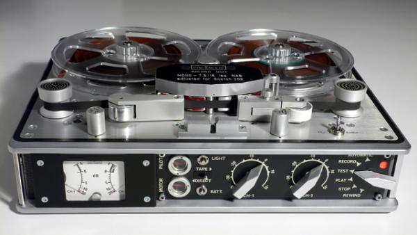

A Stellavox SP7, waiting for a camera that features Synchroton:
