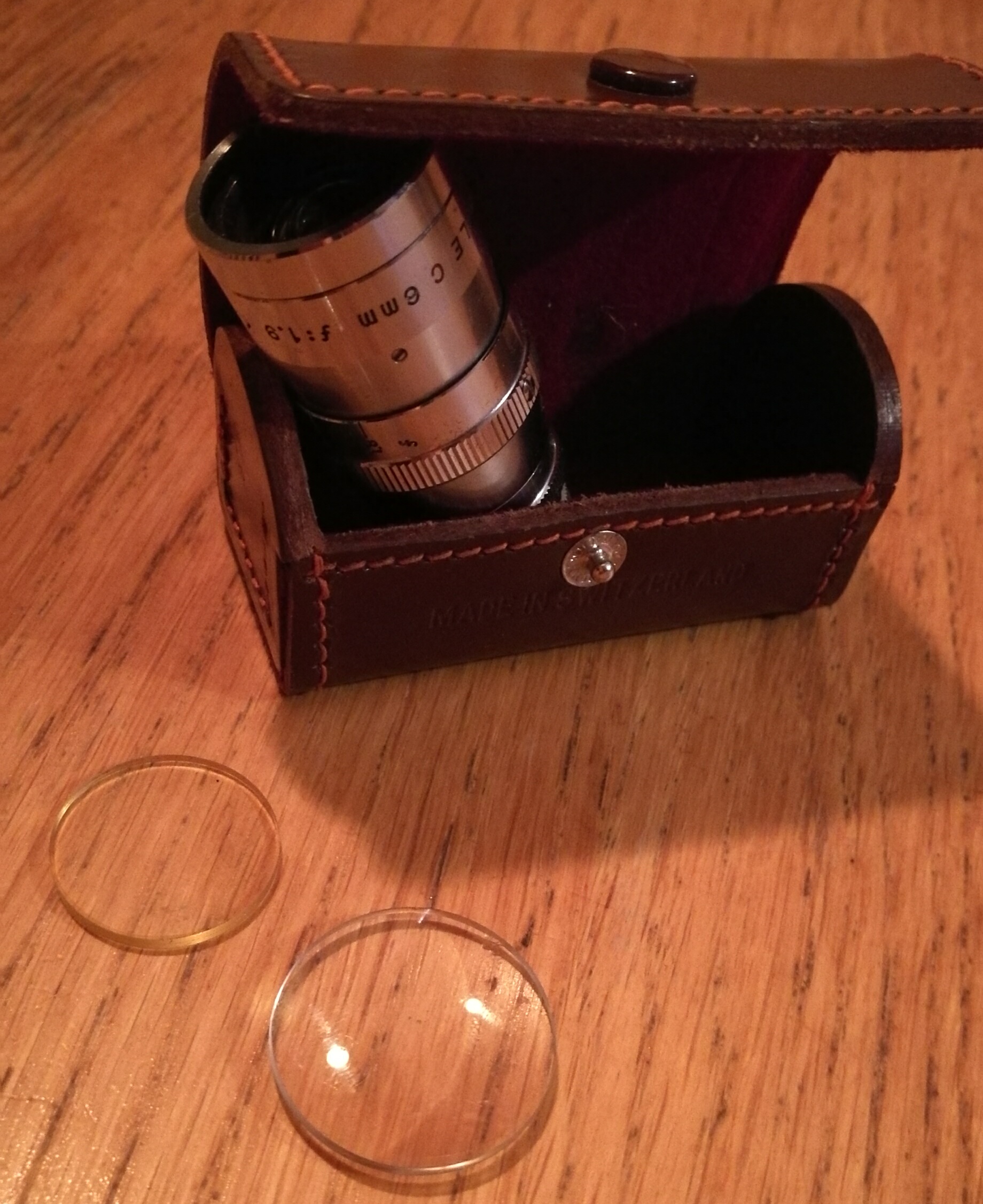

The c8 actually came with a second lens, a 6mm f1.9 of the same brand as the tele:
In the smallest of lens cases I've seen..
