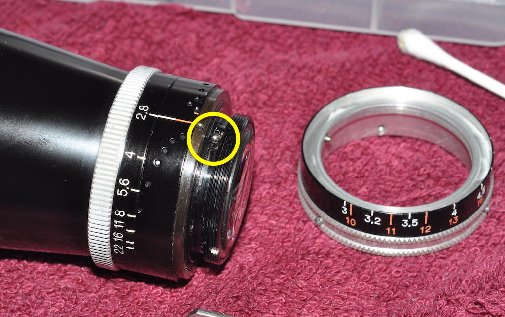

Some points on re-assembly. Green circle shows the little ball and spring that are for the f-stop detent.
Blue circle is the notch for the screw that holds the anti-rotation spline assembly in plase and keeps it from spinning when mounting the lens.
Red circle shows what appears to be a missing screw. However, there is a screw on the other side, and this hole is covered with a dab of paint. This lens had not been disassembled before, so I think it is OK with just the single screw.
The aperture ring has been cleaned of all the thick, wax-like grease. Slide it over the little ball and spring.
Next, the depth of field scale slides on. There is a screw hole to align it (yellow circle).

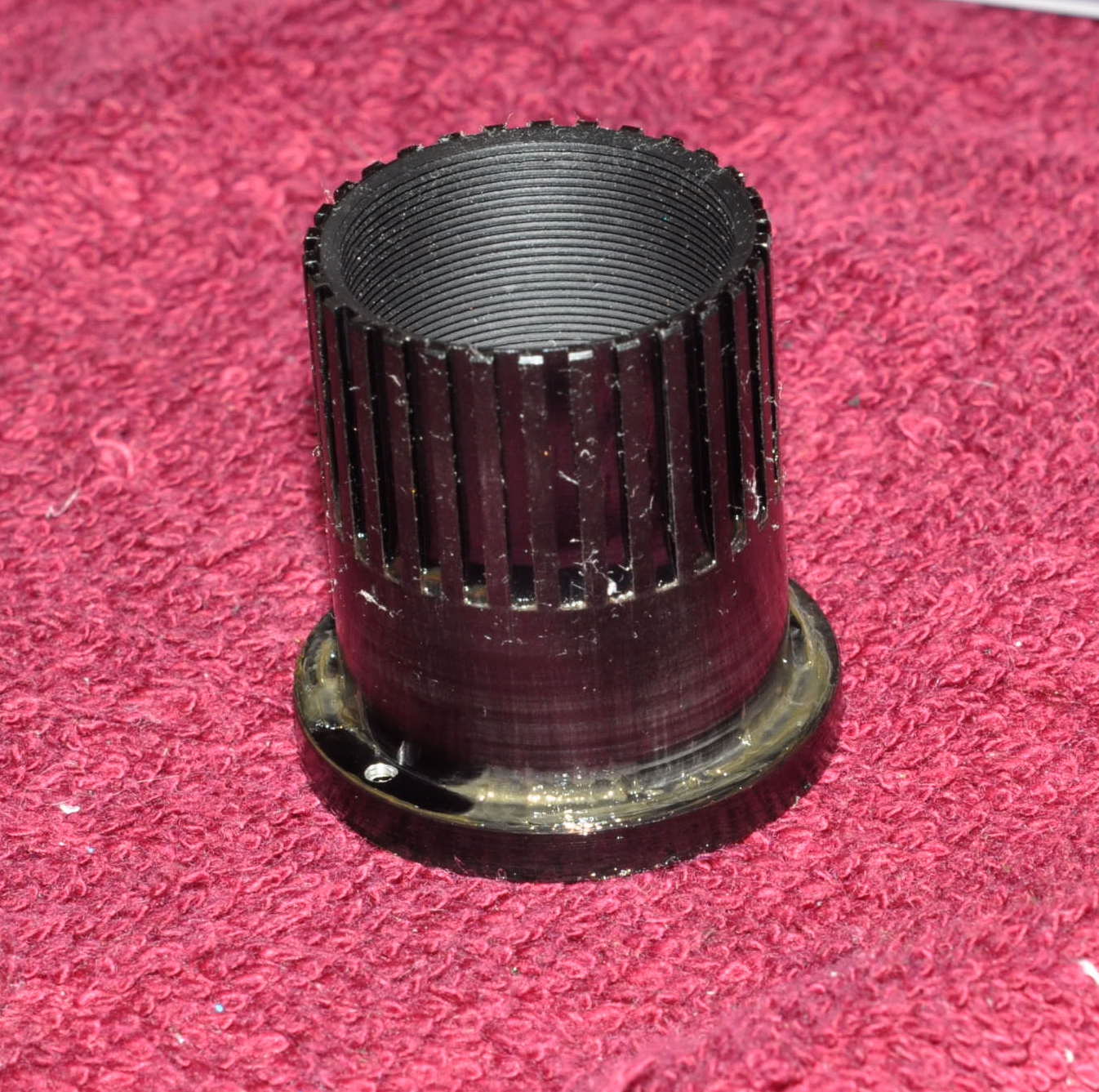

These splines allow one to re-assemble the lens so the index marks for focus and aperture are on top. You can see the hole for the screw that holds it in place. That screw locks in the slot with the blue circle on post #2.
In this picture the part has not yet been cleaned.

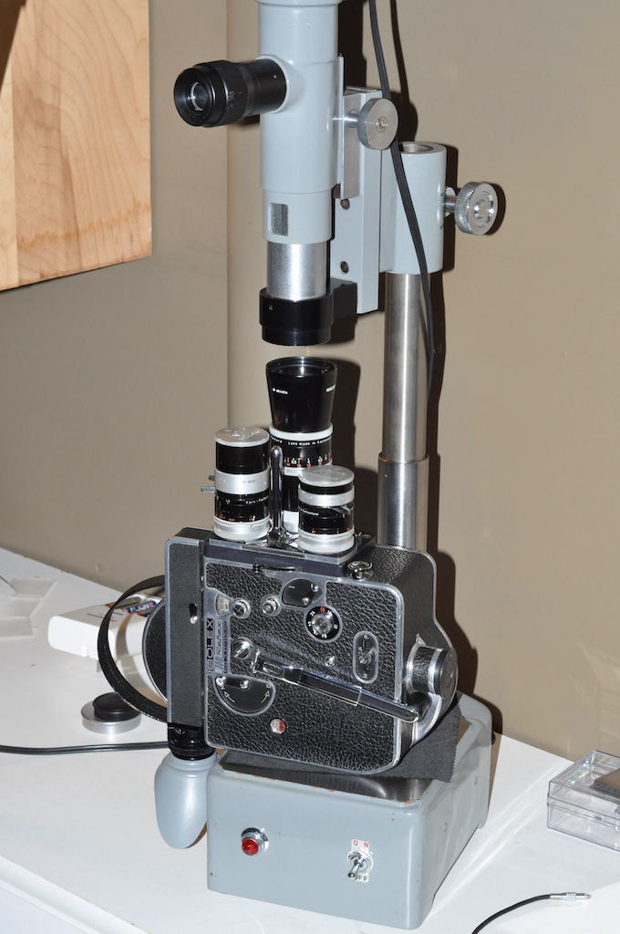

Here is is all ready for collimation.
On the autocollimator to set infinity focus. I use film in the gate and focus on the film surface.
