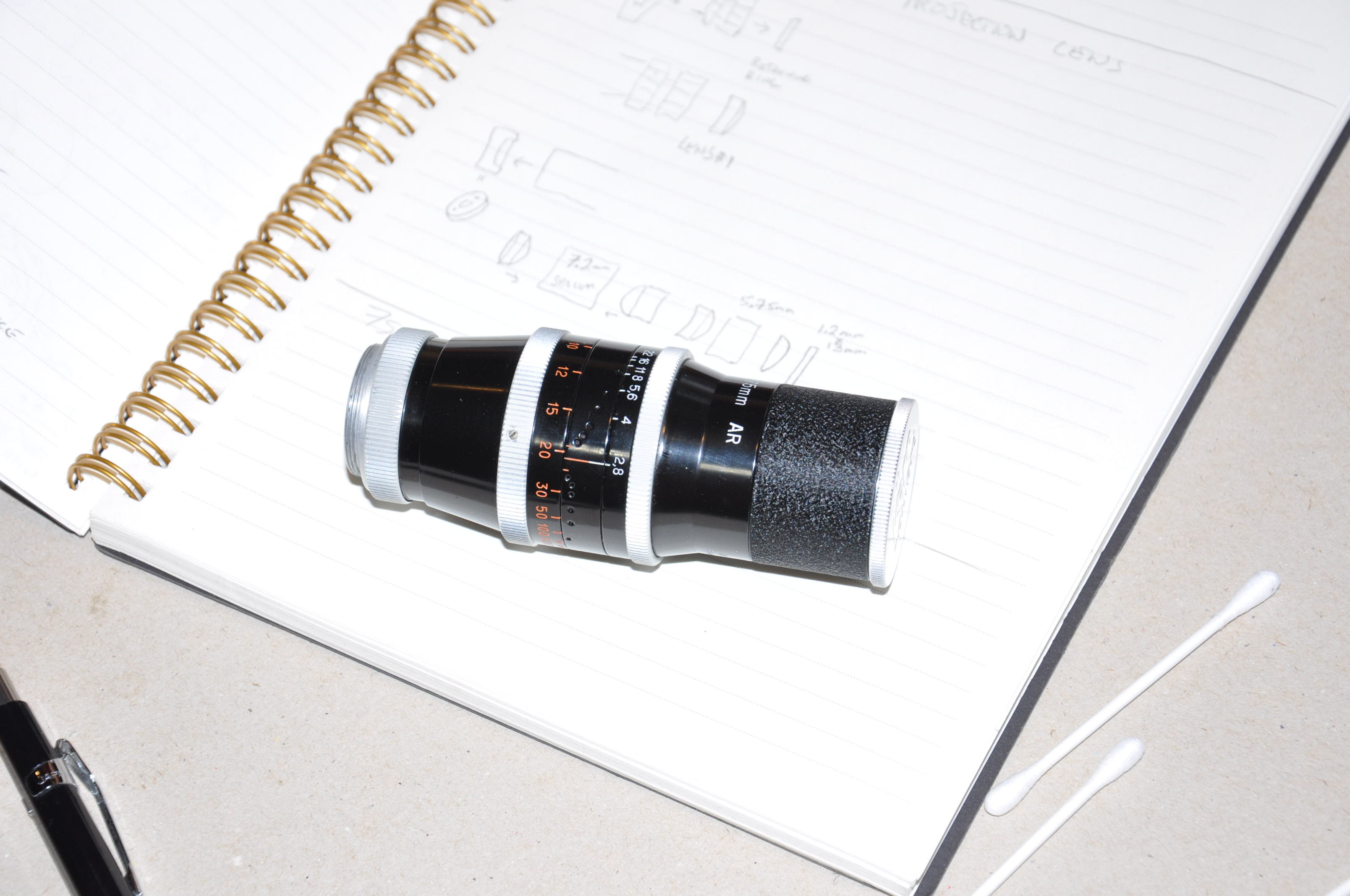

I wanted a long lens for my Non-Rex Bolex H8 for the last Eclipse. I did not find on in time, finding a 150mm Yvar for my H8-REX camera.
Finally a 75mm Yvar that I liked did show up. This one is in mint condition with a frozen focus and appropriately low price tag.
It came with the original lens hood and front & rear caps.
This is a C mount lens, but I'll be using it on my H8 Non-Rex Bolex with a "C to D" adapter.

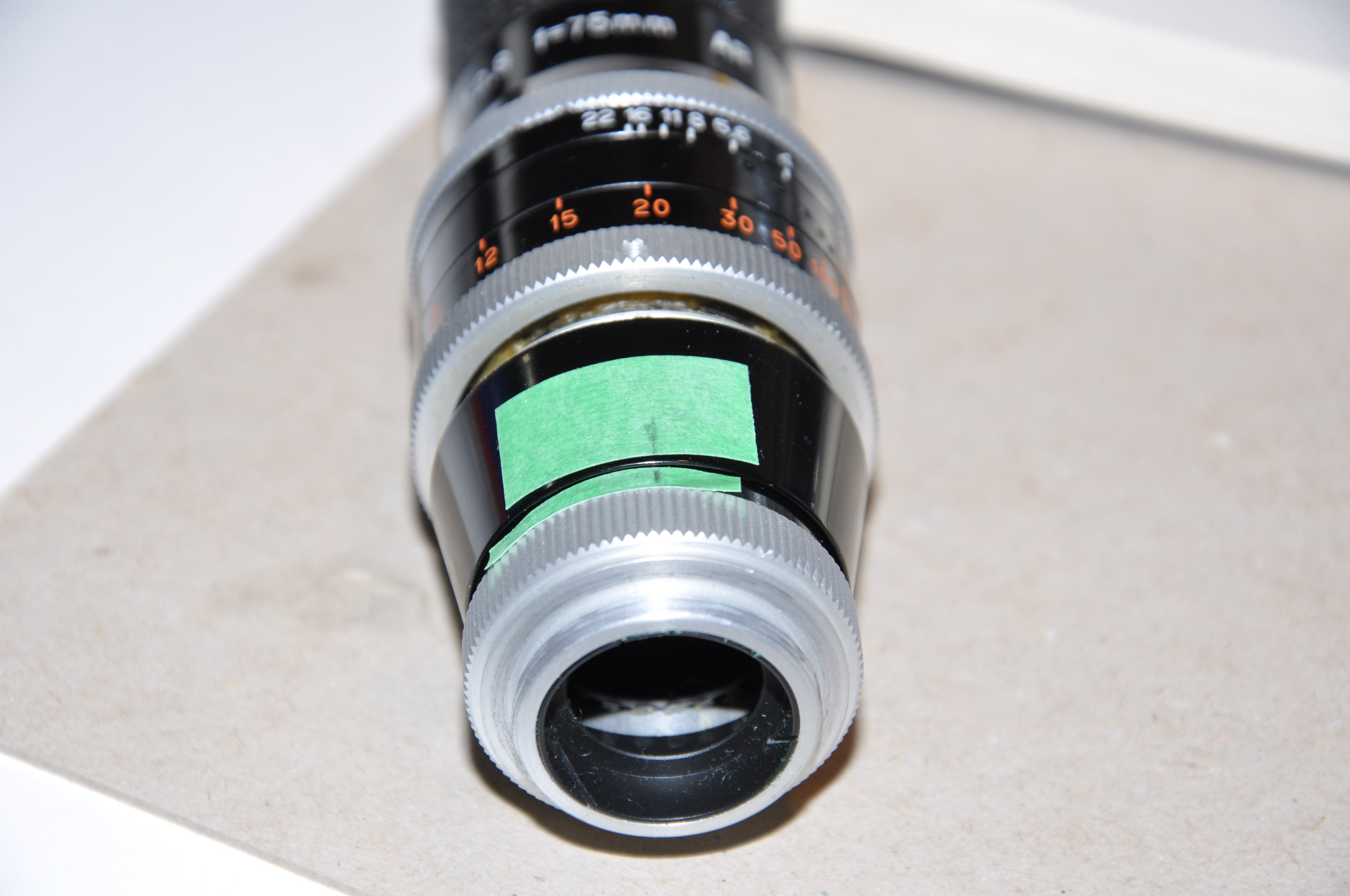

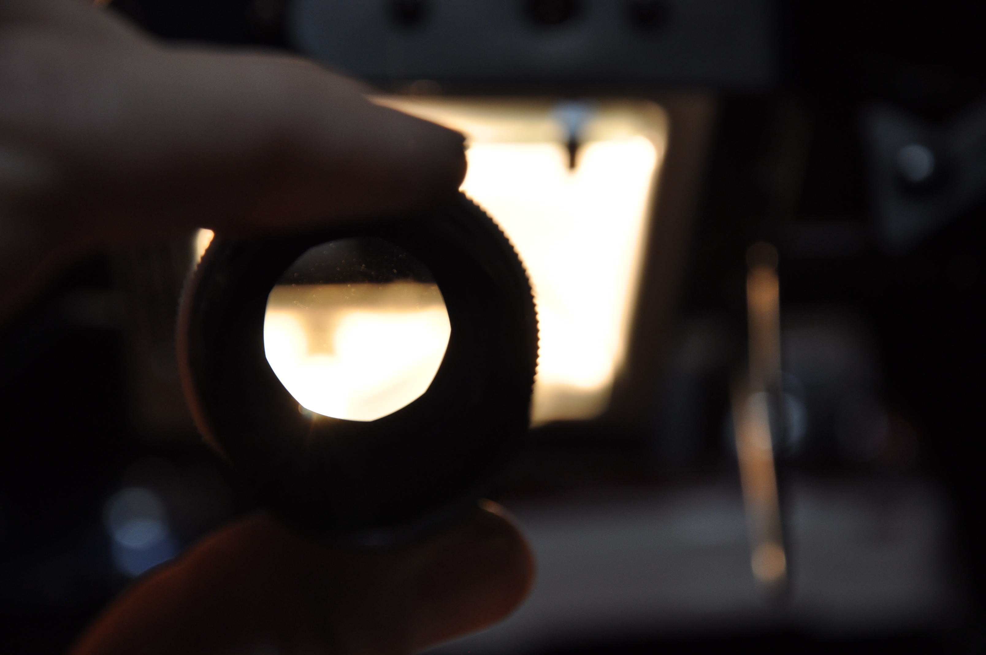

The optics are in great shape and the lens has no signs of tamper. I'll just be fixing the frozen focus.

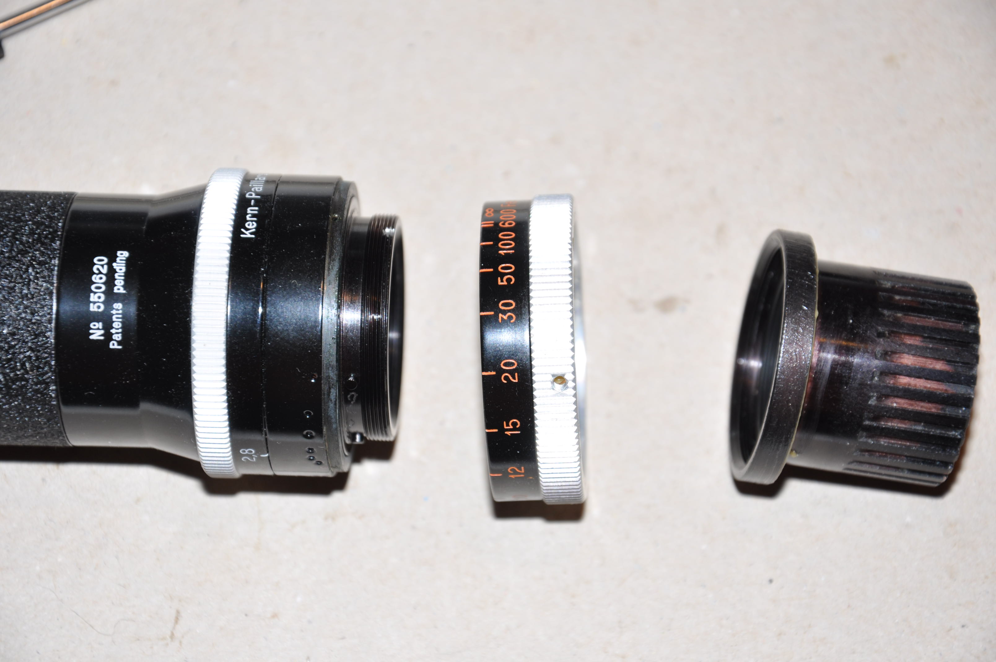

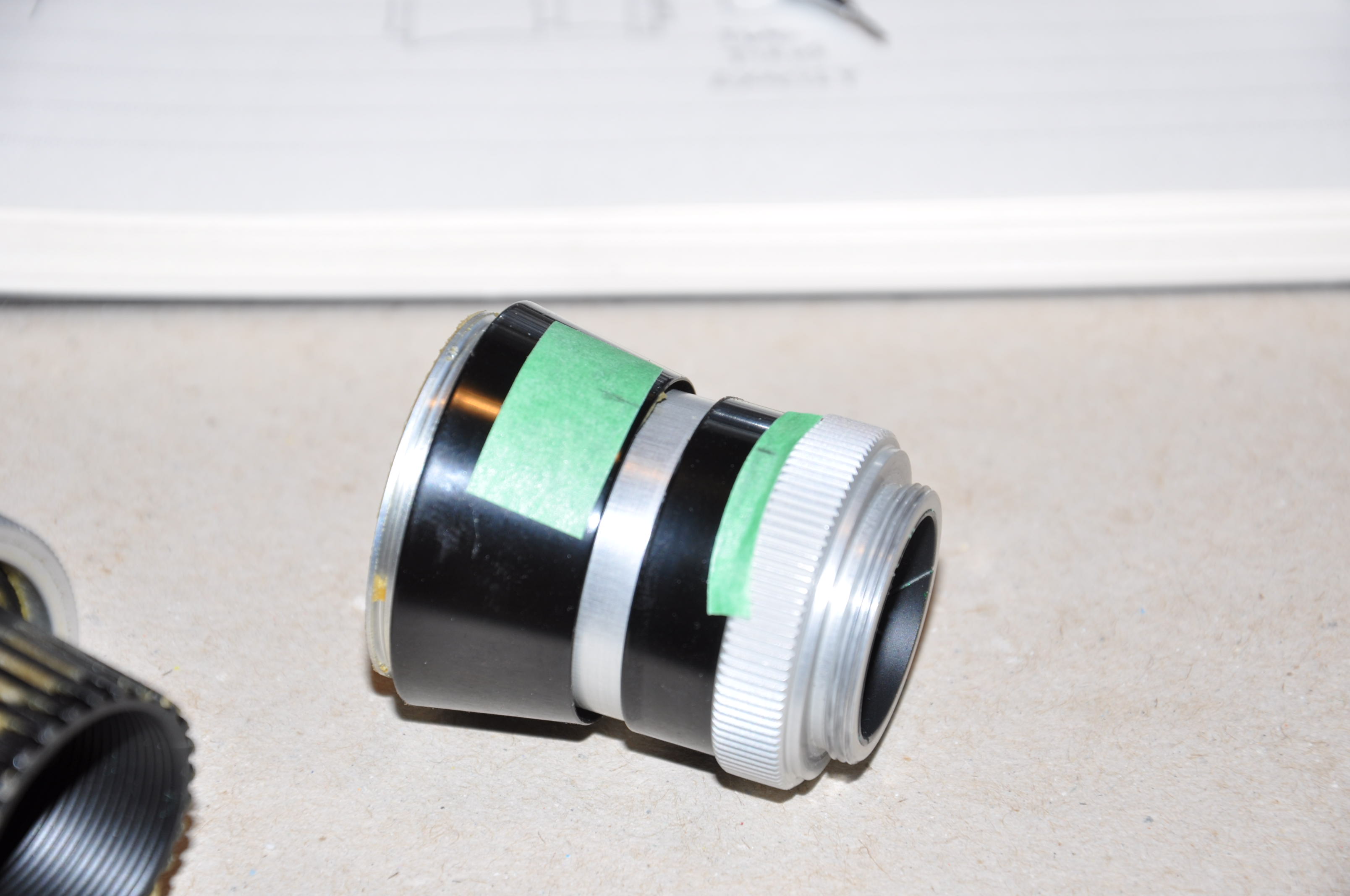

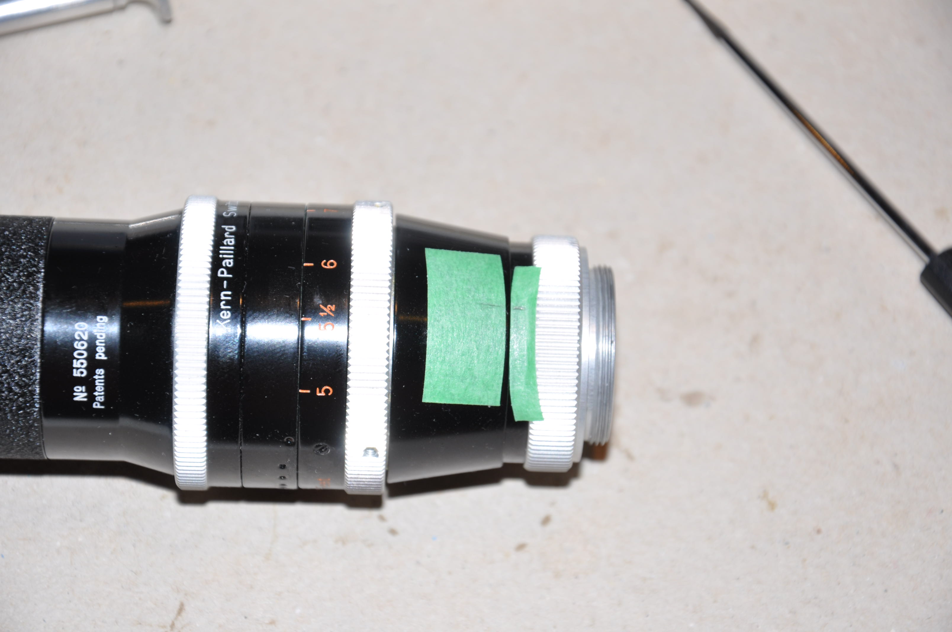

Three screws around the perimeter of the focus ring allow the lens to be disassembled. Make sure to mark the two rotating pieces, otherwise the infinity setting will need to be re-done. This lens, as it is, focuses perfectly at in finity with the "C to D" adapter I got (2.2mm offset).
With the focus helicoid removed from the rest of the lens, my example came apart with exactly two turns so I did not need to make a second set of marks.

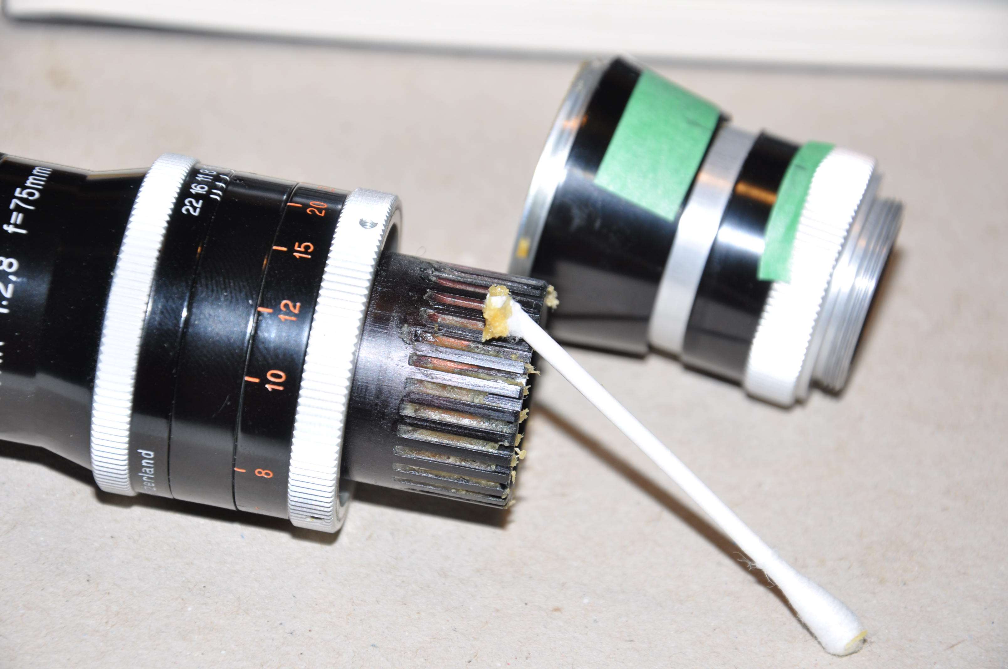

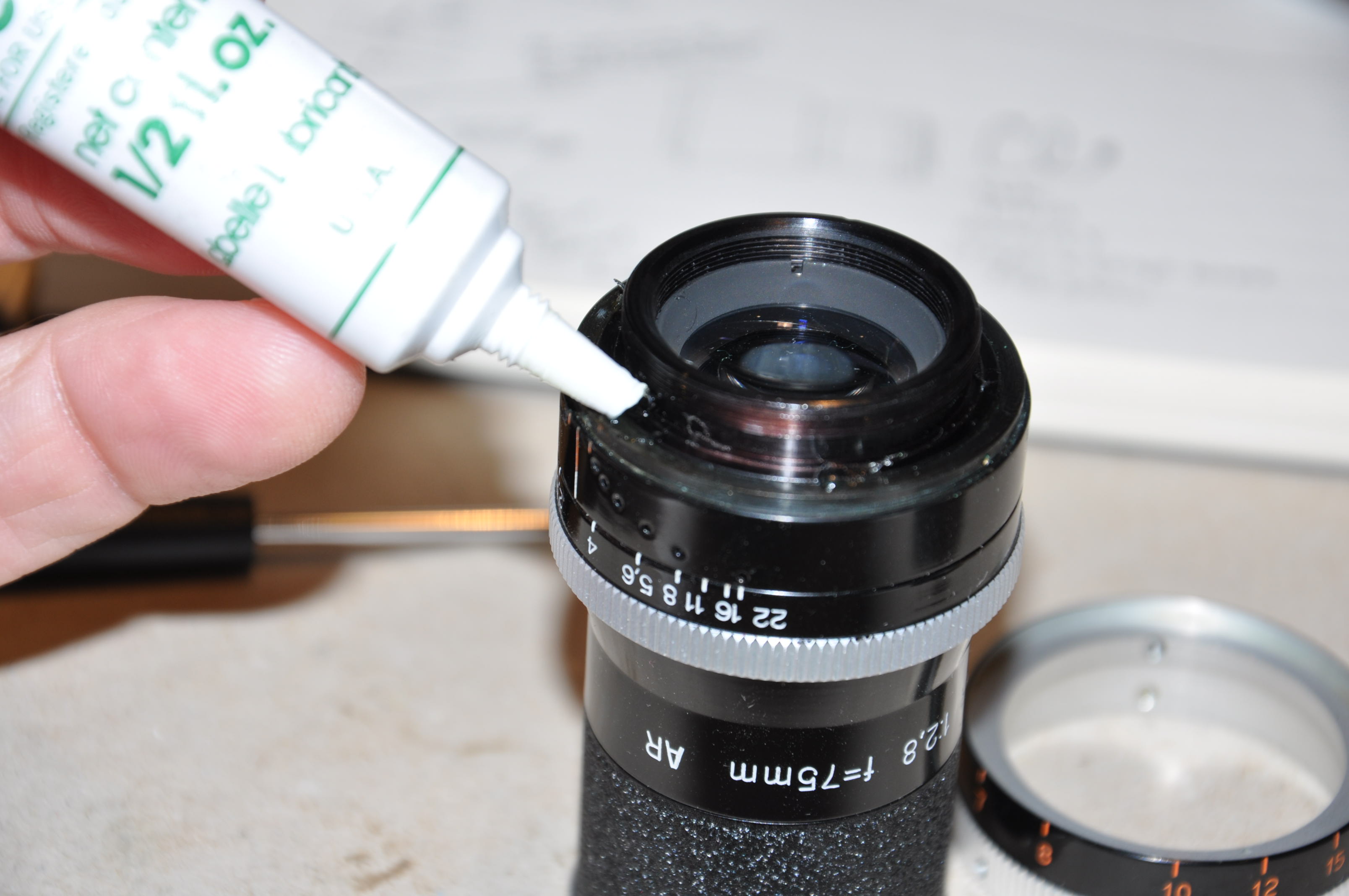

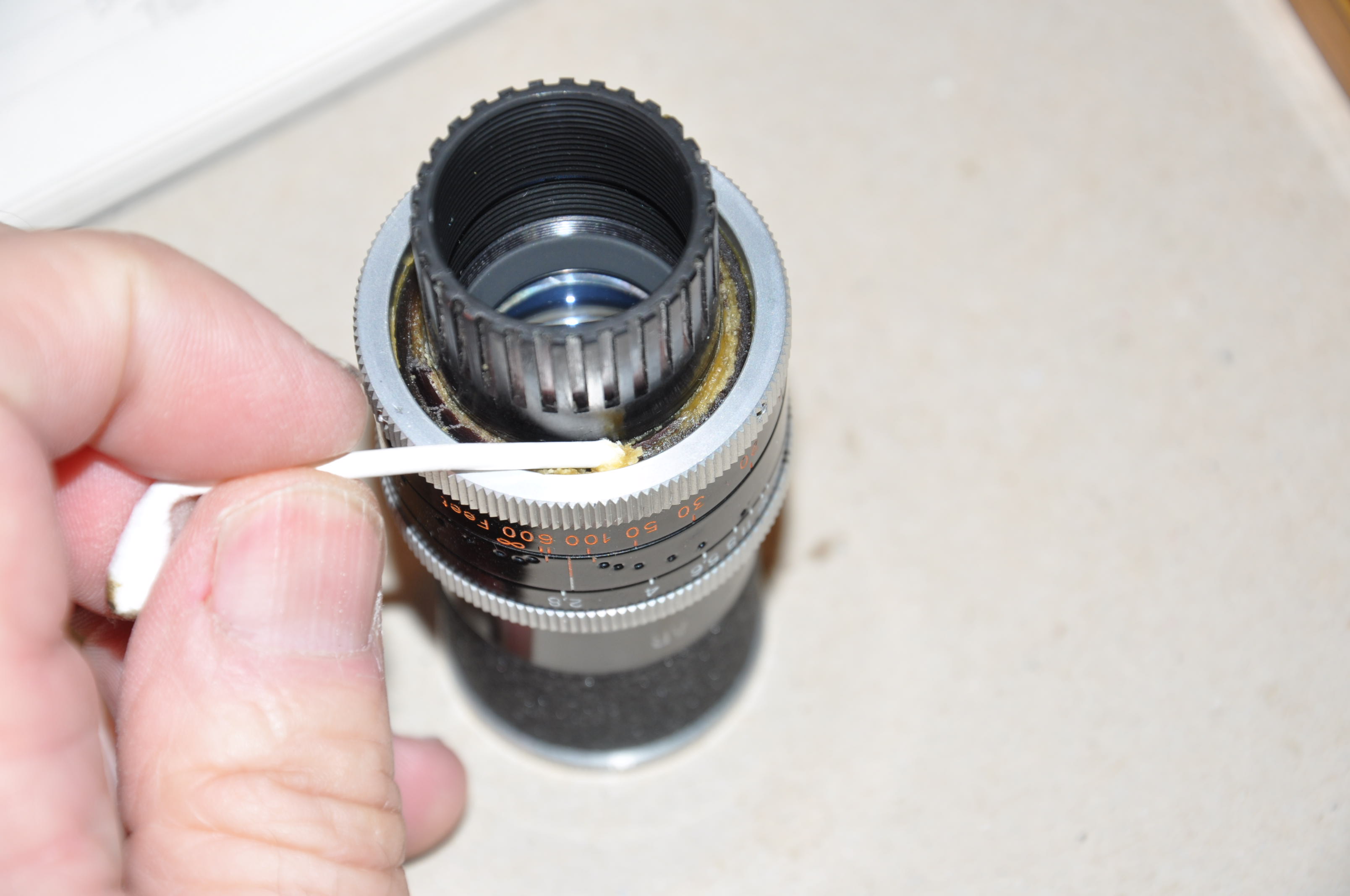

The old grease had turned into something resembling wax.
The multiple grooves are to enable roation of the lens so the marks are where you want them. Some cameras work best with the marks visible from the top, right or left side. In my case, the camera works best if the marks are visible on the left side of the camera.

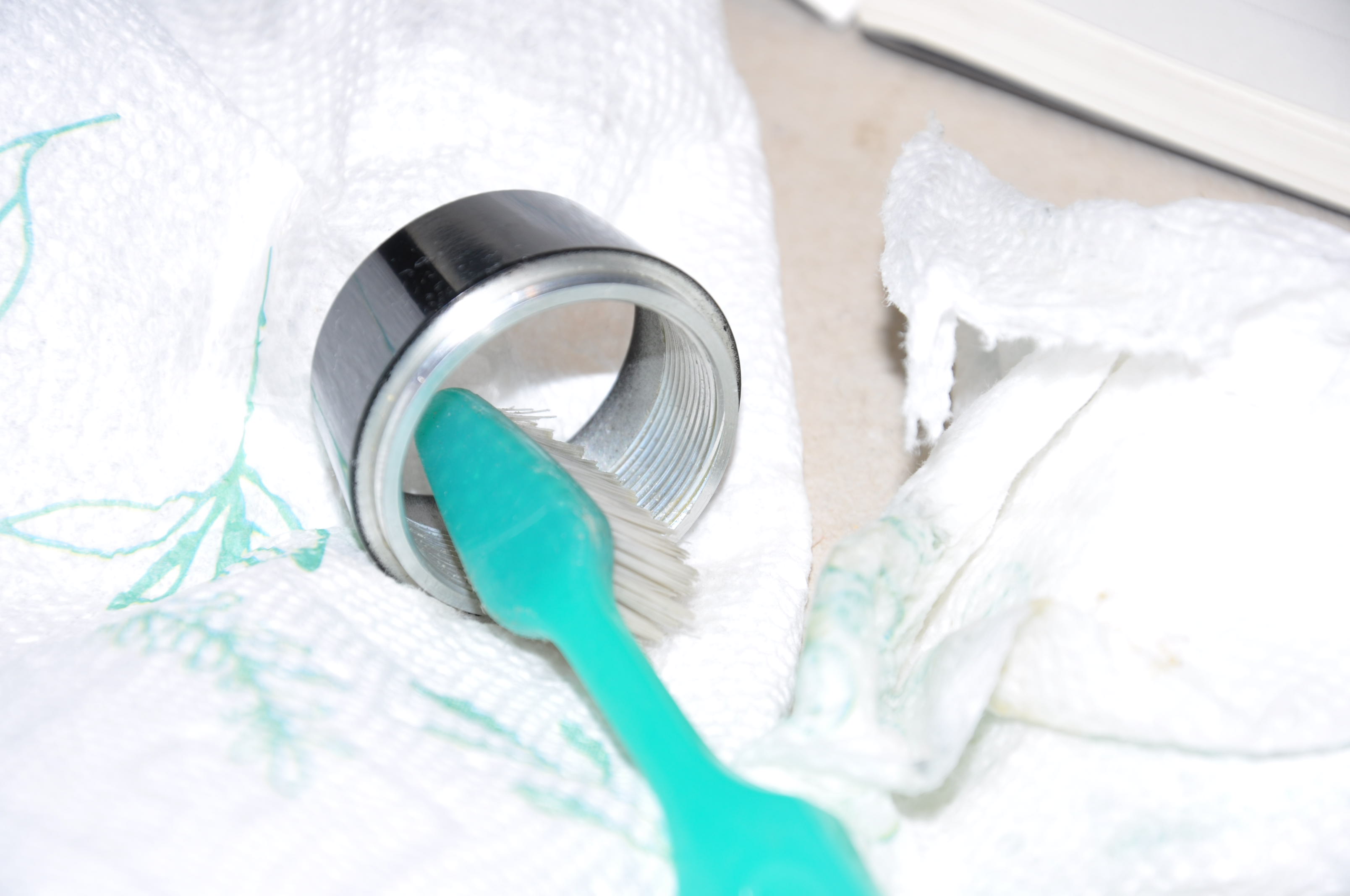

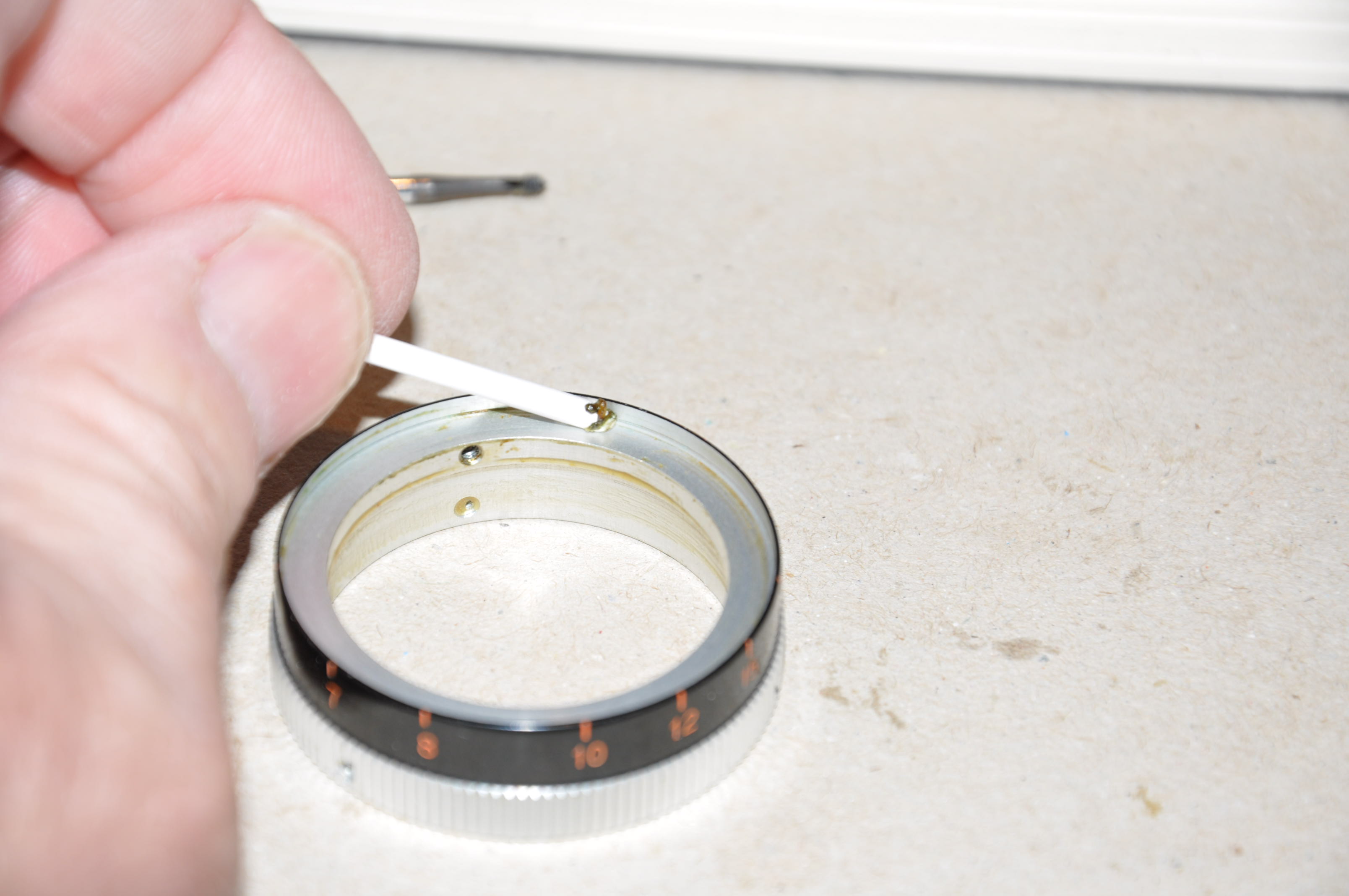

The focus threads were cleaned with alcohol. This looks like simple threads as there is only a single start position.

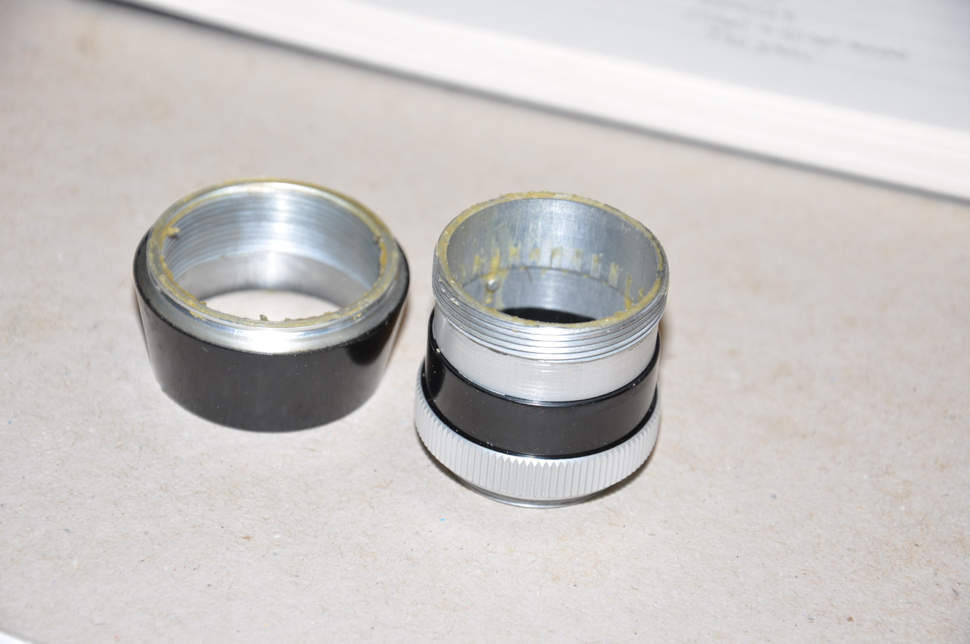

Actually those threads were not frozen. The part that was frozen was the focus ring itself.

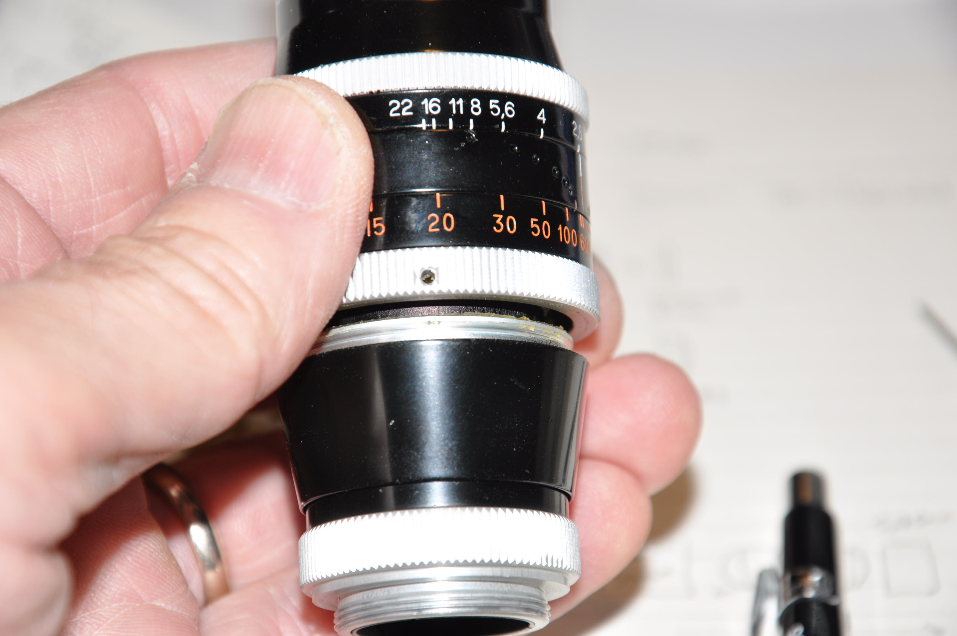

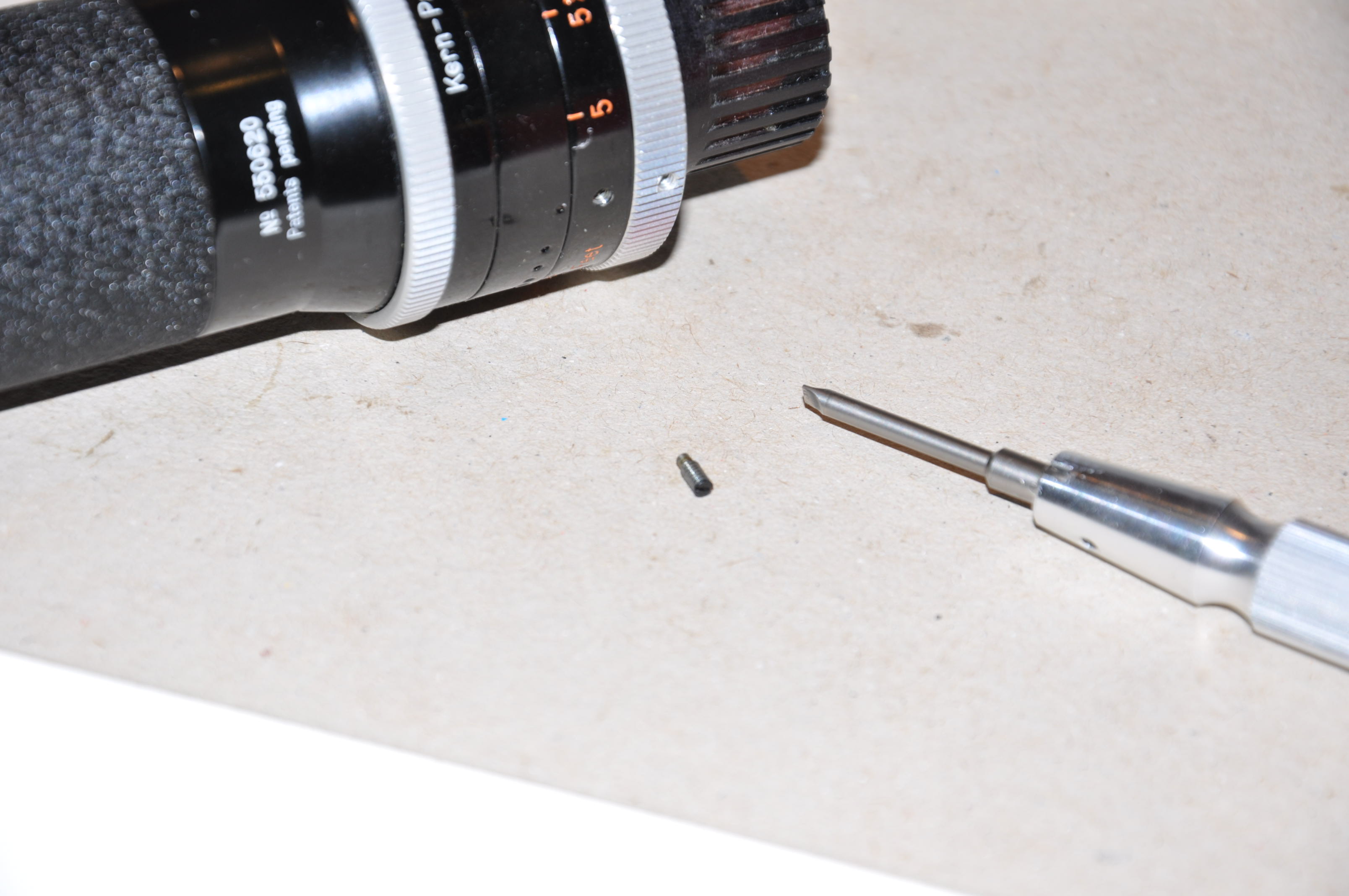

To get the focus ring off, the focus stop screw is first removed.

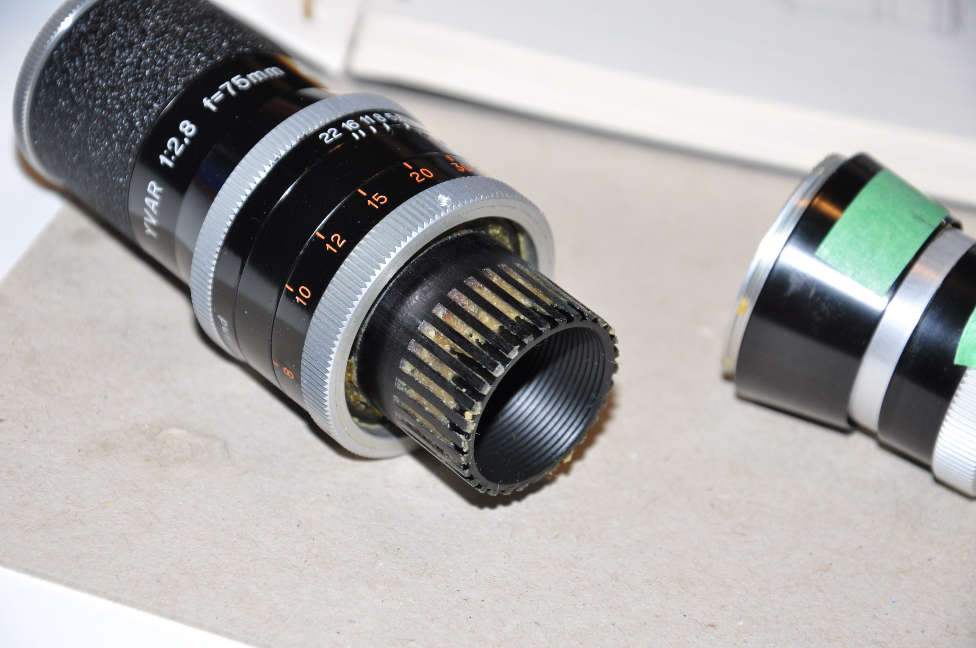

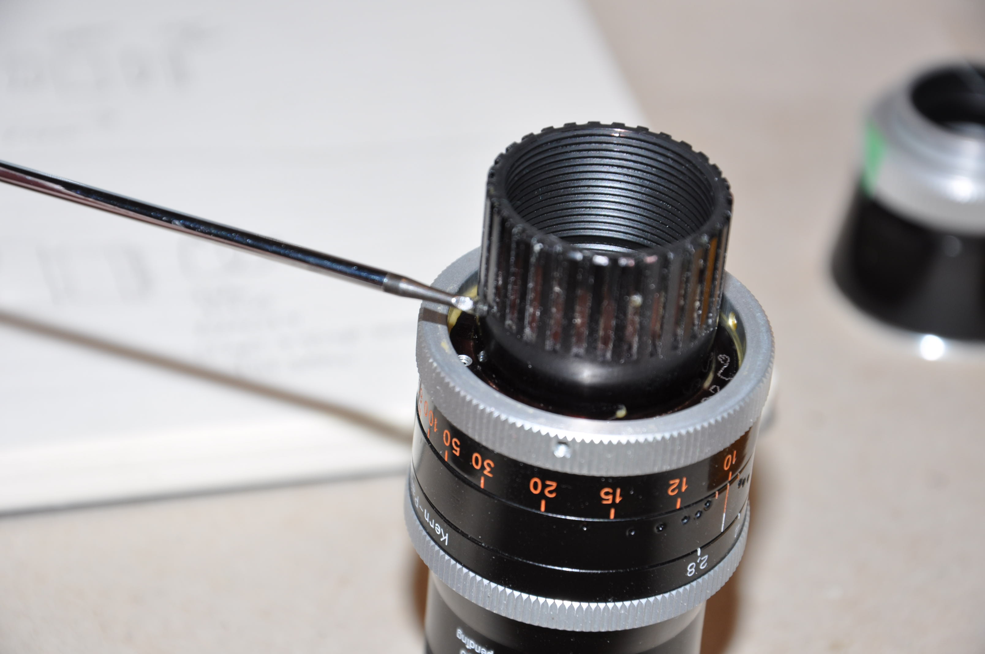

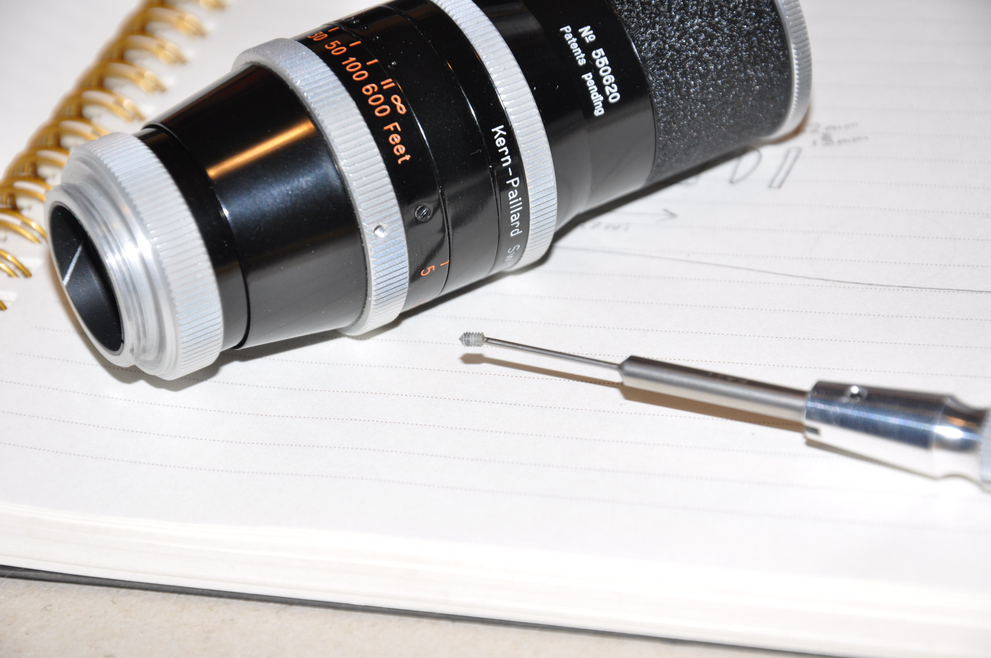

Under this caked-on grease there is a screw that needs to be reomved so the serrated piece can un-screw to free the focus collar.
After cleaning the old grease, the screw is visible and can be removed. The screw is on the end of the magnetized screwdriver in this picture.
The rear serrated piece can now unscrew. The focus ring came off. No mechanical problem here, just hardened grease.

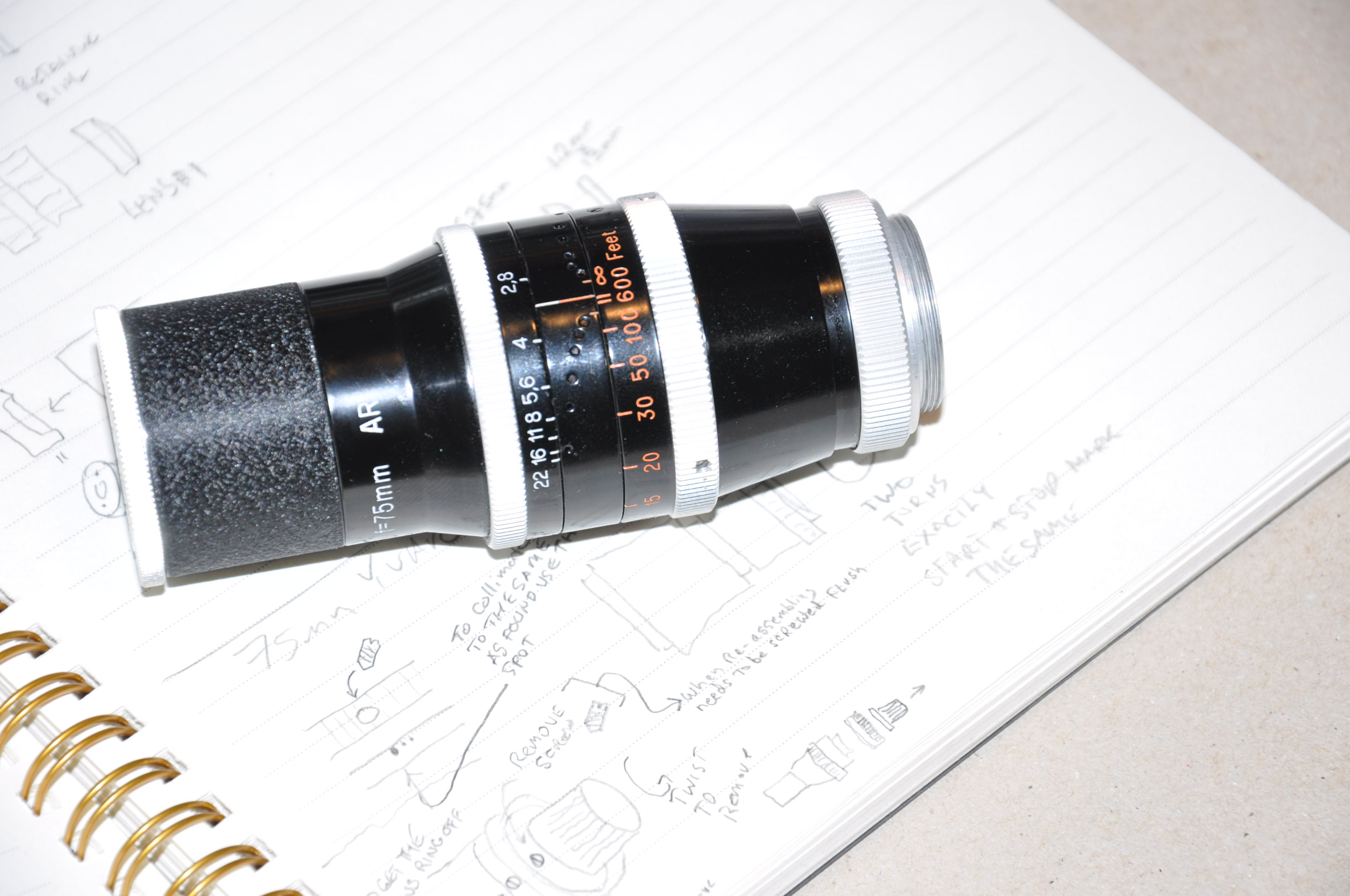

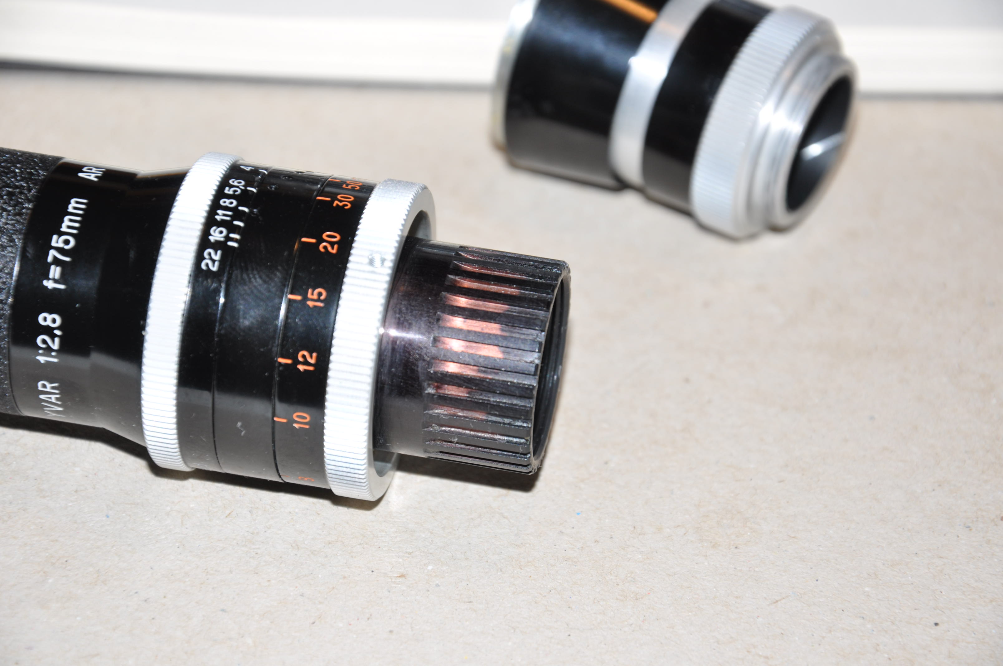

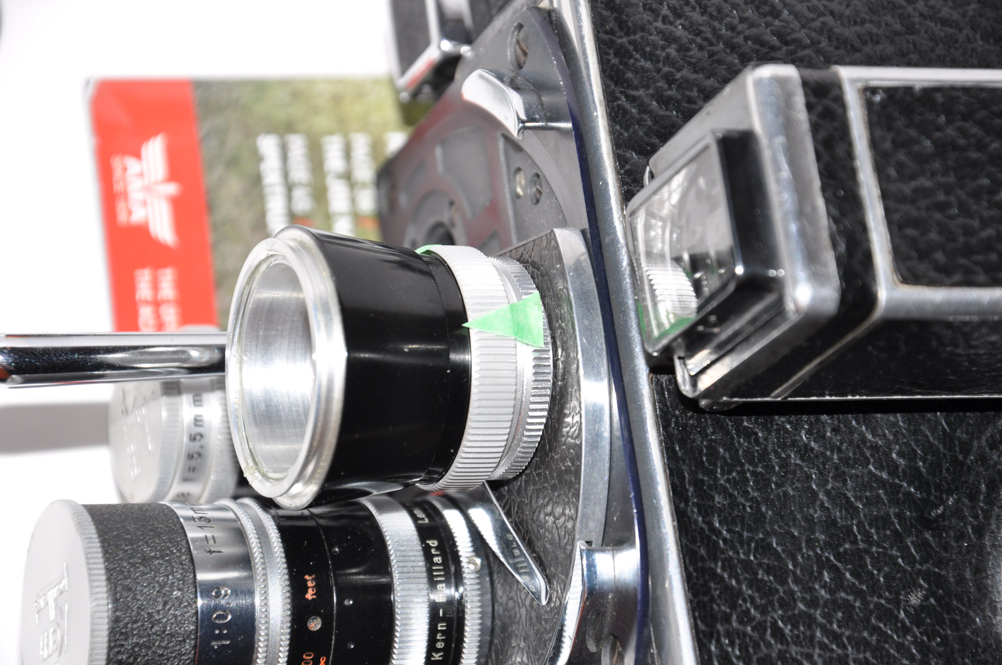

For re-assembly, I want the marks on the lens to face the left side of the camera. That is where the marks on all the other lenses on this turred face.
You can also see the 2.2mm "C to D" adapter between the focus mount and the turret.
The focus ring is re-installed, with its focus-stop screw. The serrated tube is screwed back in place and locked with the little index screw.
The focus mount is slid back on the lens, catching the appropriate groove so the numbers align where I wanted them. All the while making sure these two marks stay aligned with each other.
To hold it all together, the three screws around the perimeter of the focus ring are replaced.
