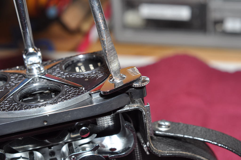

Remove 4 screws on top of the finder. Close the light shade on the viewfinder.

4 screws need to be removed to release the viewfinder.

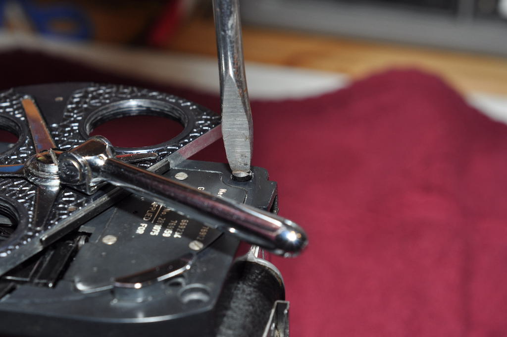

Remove this 6mm nut from inside. Removing the nut allows the turret stabilizer to be removed.

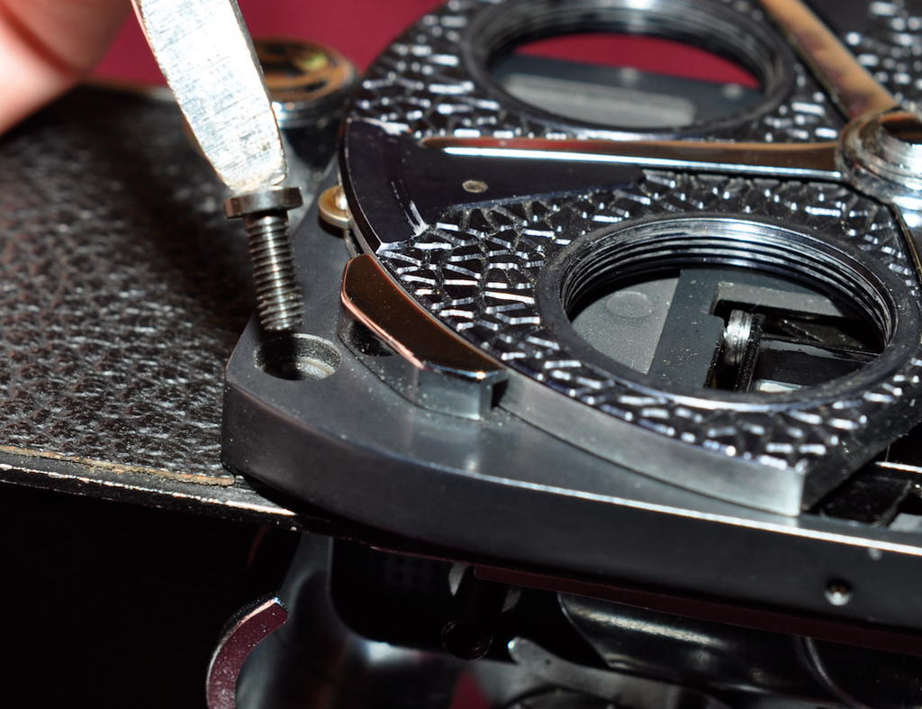

Remove the other three screws from the turret.

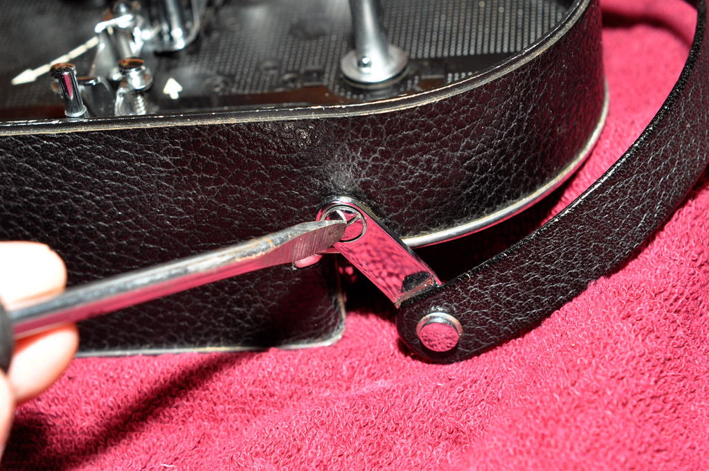

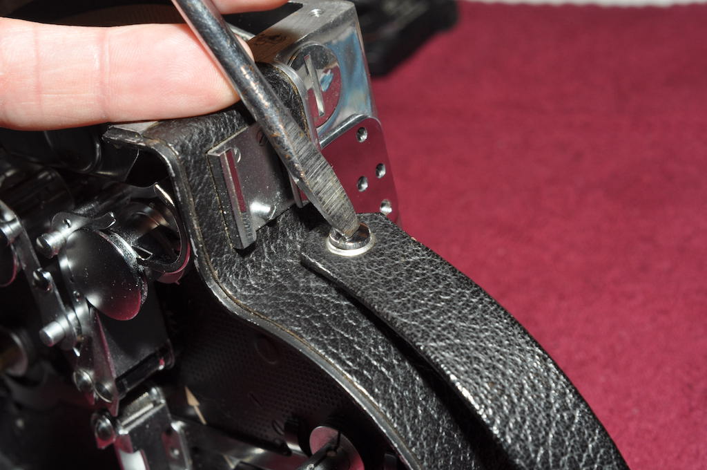

Loosen the screws for the handle (the ends sometimes get in the way).

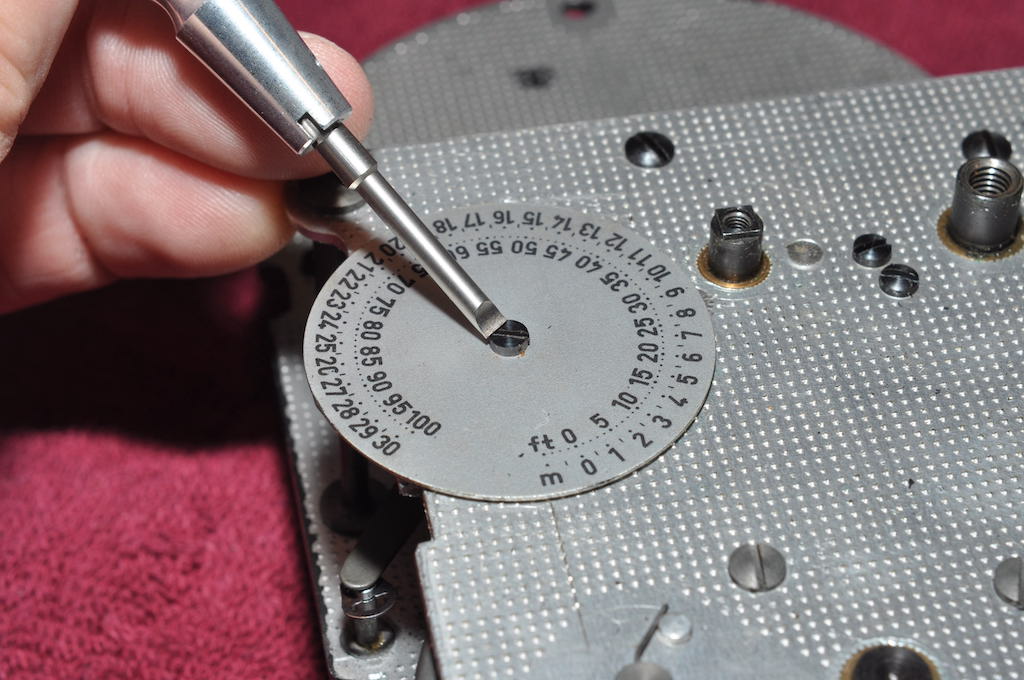

I took the film counter to keep it from getting damaged.

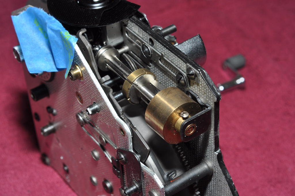

This is the governor. It is likely gummed up, causing slow and erratic speeds.
ic-racer
ic-racer
Feb 25, 2007
16,673
USA
Some old goop around here.
This was cleaned and re-assembled with just a little moly grease.

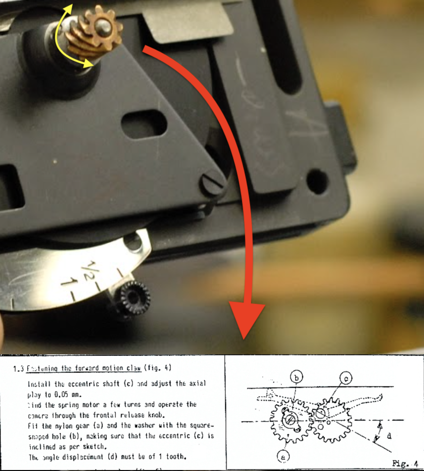

The forward drive claw was not aligned with the center of the sprocket hole, so it was bent upward slightly.
