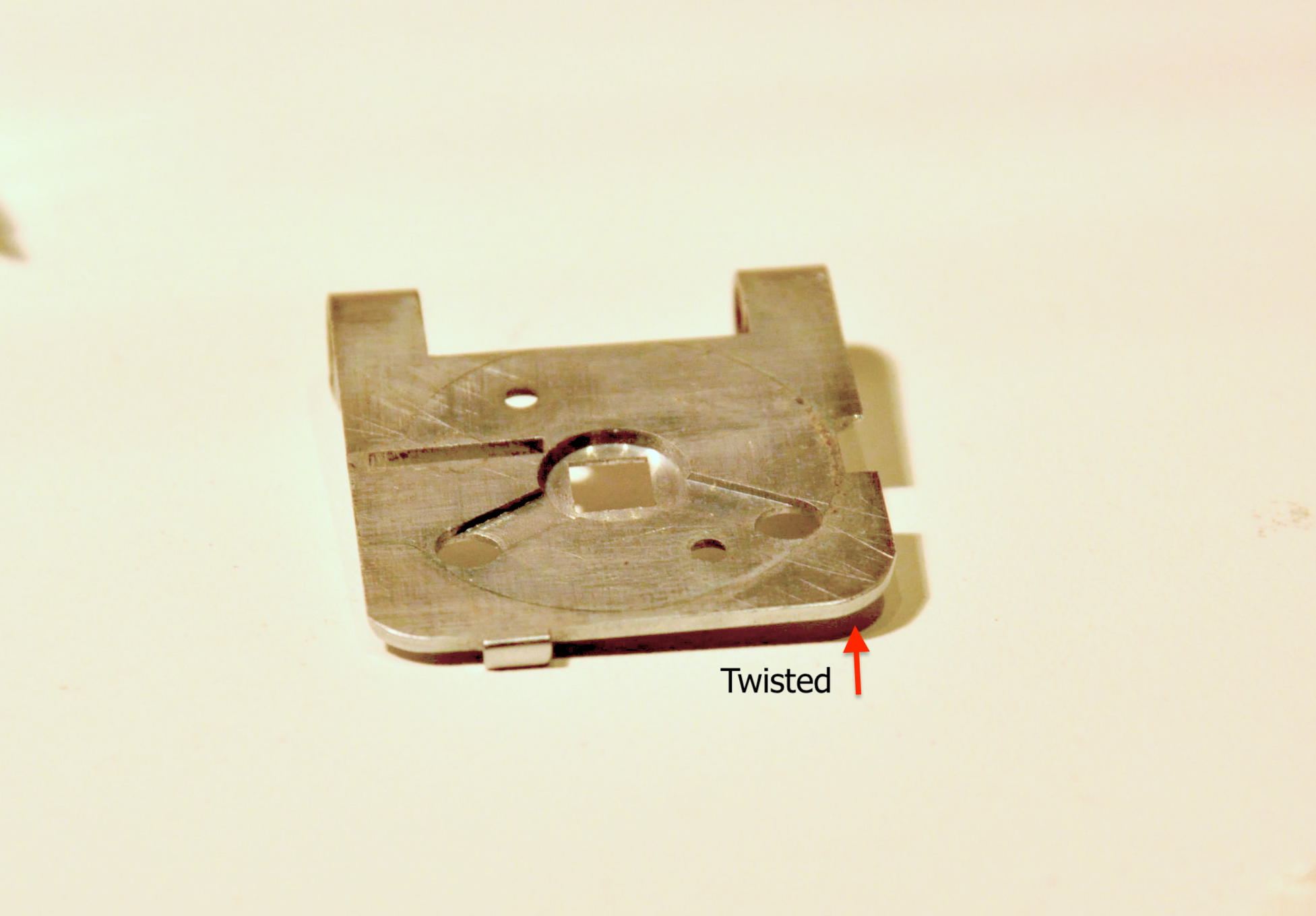

The film gate was removed from the back to see what is wrong.
This tab had been bent (black line). This image taken after the repair shows the correct position, parallel to the film path.
The front of the film stage was bent and twisted.
The metal is pretty soft, so I was able to bend and twist it back in shape.

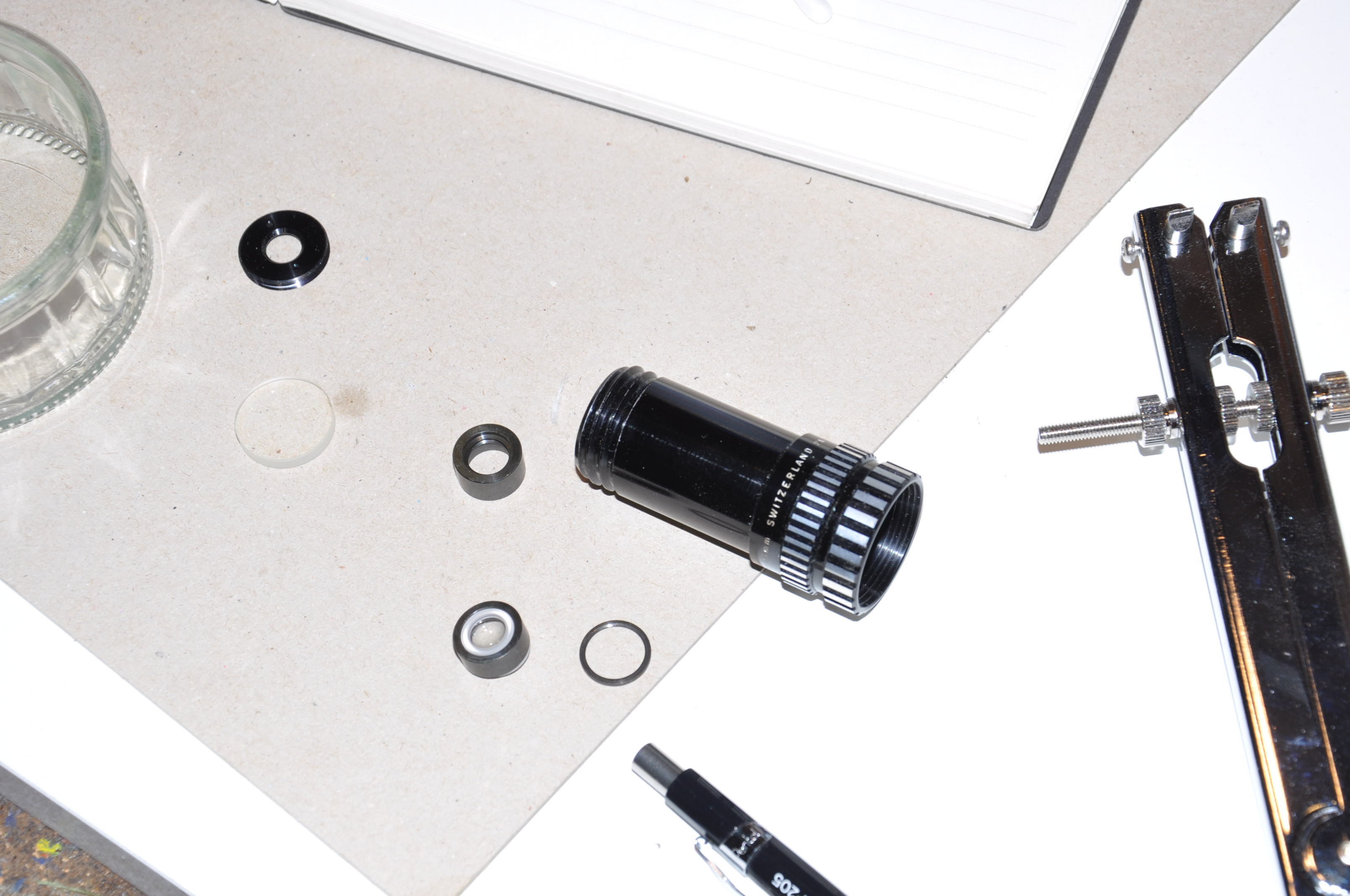

This projector came with the Hi-Fi Zoom lens 12.5-25mm f1.3.
I did not disassemble the moving block in the middle of the lens. There were one or two elements in that. Overall it is a 5 or 6 element lens. Pretty high quality.
The inner lens surfaces are NOT coated, but the front is coated.

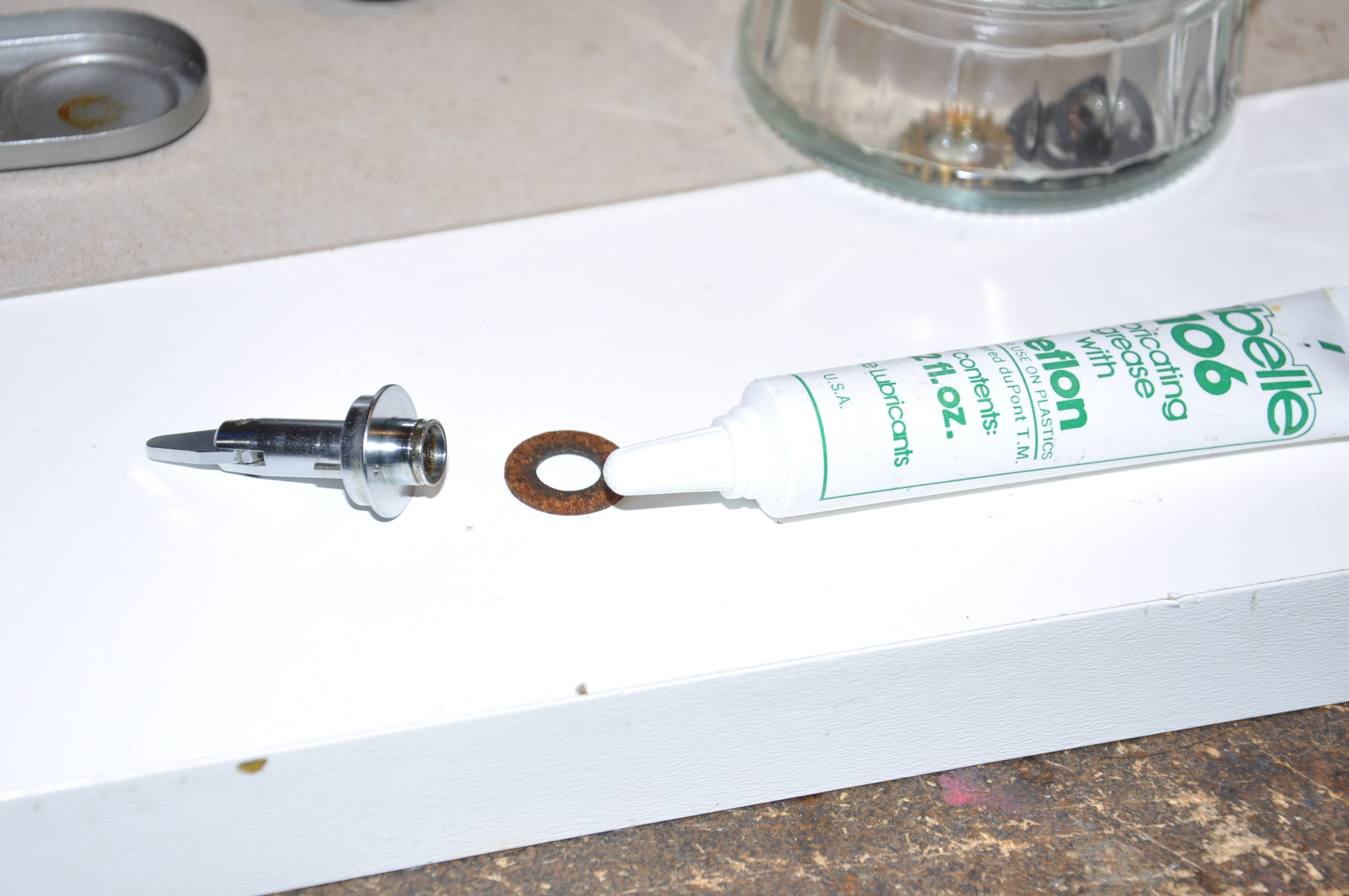

Takeup clutch too stiff. Pulls on film too hard.
The plastic gears look ok. The clutch was stiff with thick old grease.
I made a mistake with the picture. The gear actually does ride up against the cork without tearing it up. The flat washer goes between the two wavy washers and the gear (blue arrow).
These items were all cleaned in alcohol and re-greased.

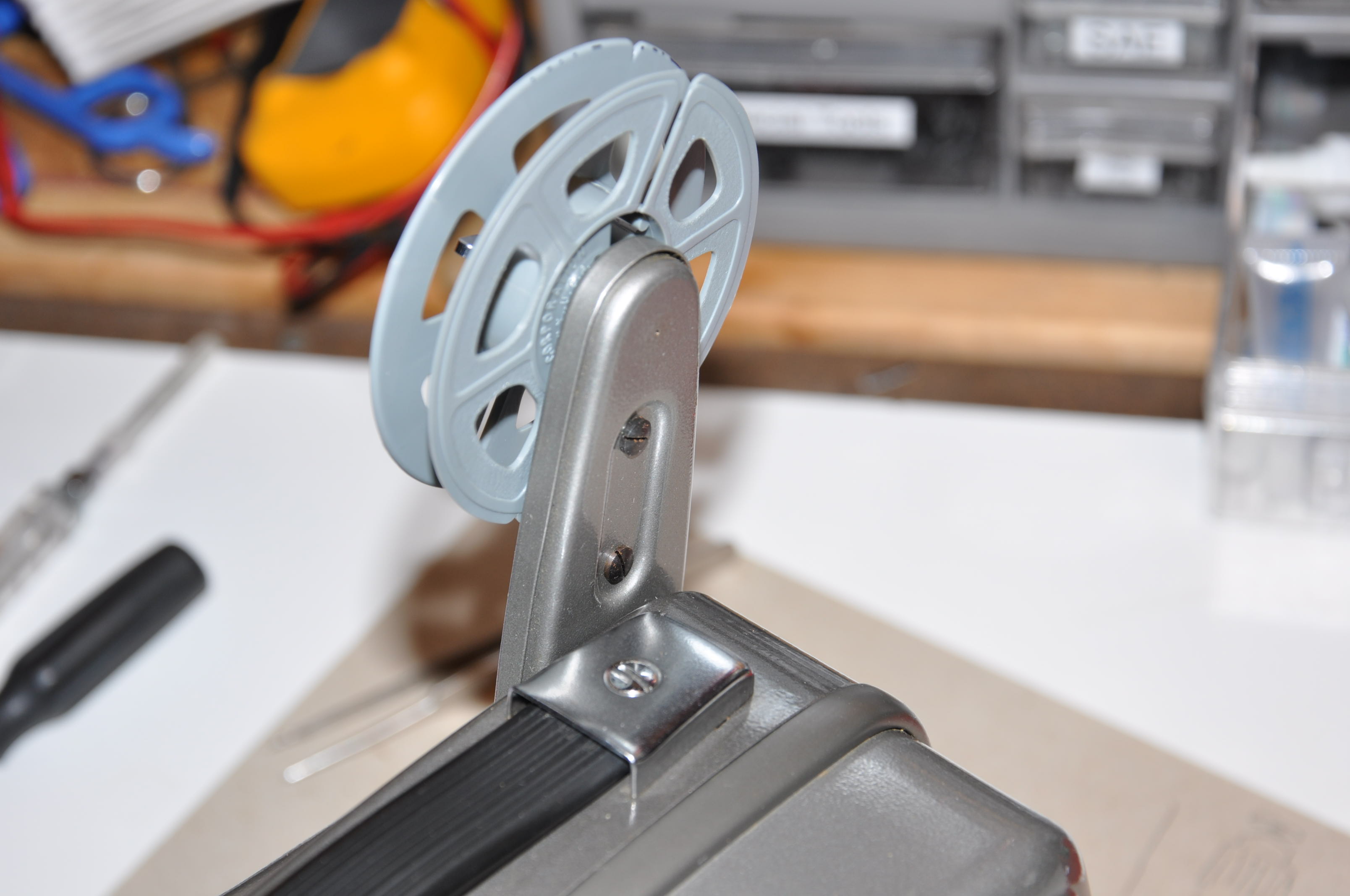

The rear feet were removed and bent back into shape.

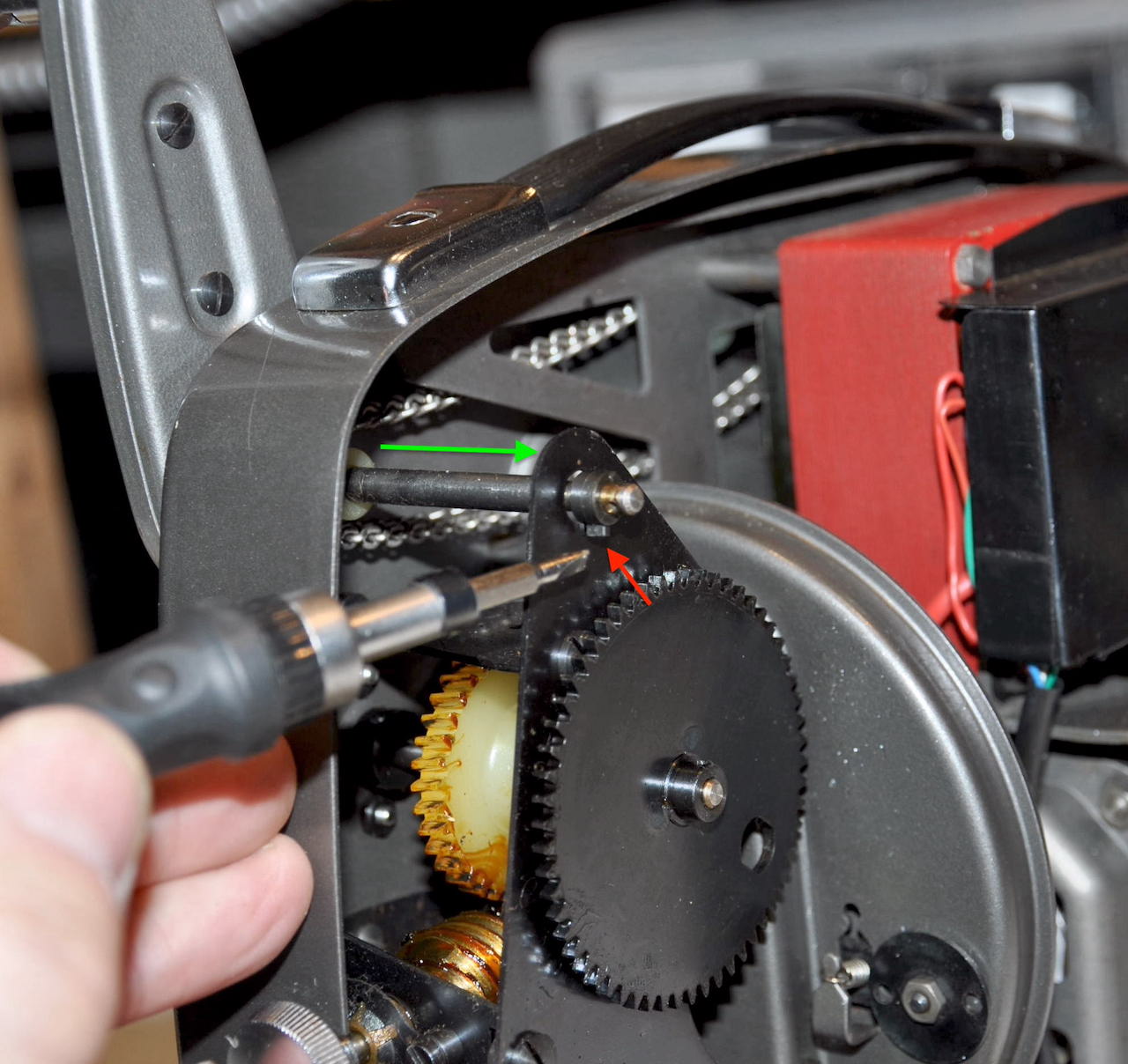

To get to that, I needed to remove the shutter.

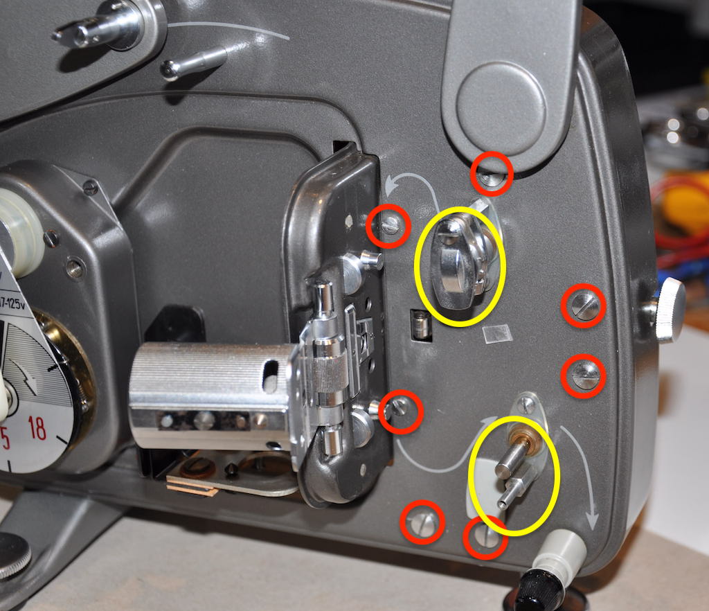

All these items need to be reomoved:
All the other gears will come out (green arrow) attached to the shutter assembly if the pin on this spacer is aligned with the little opening (red arrow).
Shutter assembly. These gears will be cleaned later.
