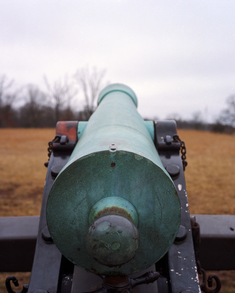

Untitled by Michael_Sergio_Barnes, on Flickr
11 by Michael_Sergio_Barnes, on Flickr
