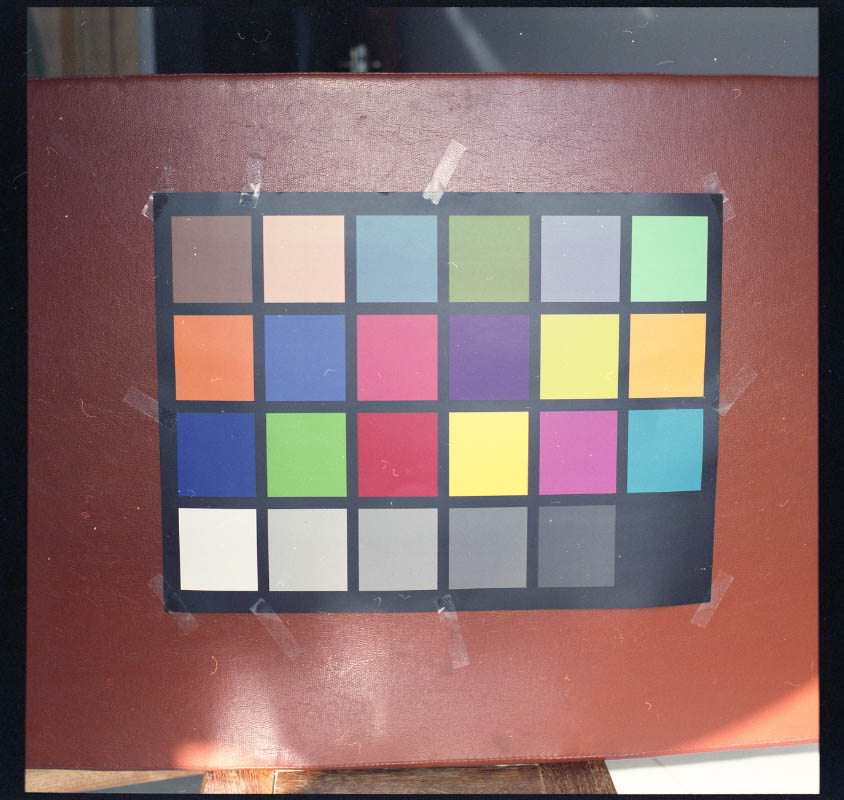

Hello, I got consistent blue RA-4 prints regardless the content on the negatives.
If I set cyan to zero, the whole print gone pure blue. Adding up cyan filtration is the only way I can do. In order to get an acceptable print, my final filtration value is C90, M85, Y70. It looks crazy because I know enlarging color negative seldom uses cyan filtrations.
After that, I used Unicolor and Beseler subtractive color calculator to confirm CMY filtrations value and the results told me that Cyan is needed.
Please help.... got confused
Here I list my darkroom setups and tools for printing:
  1. Darkroom: absolutely no light.
  2. Enlarger and lamp: LPL 5xxx color enlarger with 12V 100W Osram light bulb (3500K light temp).
  3. Negative used: Pro400 H and Ektar100 developed with fresh C-41B chemical. I can't see any visible flaw on the negatives. Scanned image (Epson V550) looks Ok to me.
  4. Exposure time: usually ranges from 10 - 20 seconds.
  5. Paper: Kodak RA4 paper, but not sure about the expire date, brought it from a local lab. stored in a thick black plastic bag. Stored 3 - 4 month on my book shelf before use. Room temperature 20 - 35 degree Celsius.
  6. RA-4 chemical: Fresh Kodak Ektacolor Prime paper chemicals from authorized vendor.
  7. Modified Durst RCP20 (for RA4 process) used during RA4 printing. No stop bath between developer and Blix.
Epson scanned negative:

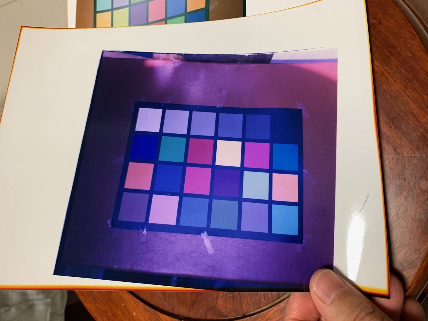

RA4 print if Cyan is low, 30 - 40:

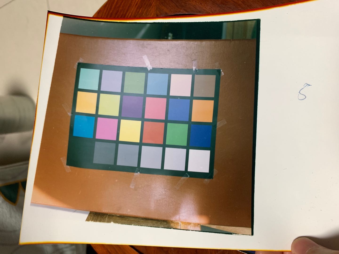

RA4 print C90, M85, Y70 (the one look pretty close to scanned copy):

To expand a little -- all you get by having all three filters active is neutral density -- C10 M10 Y20, IIRC (because yellow filter is weaker than cyan and magenta), is equivalent to a neutral. Adding cyan is equivalent to cutting magenta and yellow, so you should be able to cut the cyan to zero and cut back magenta and yellow, perhaps below "starting" values for the paper you have.

Btw your second image shows mostly way too much blue, so I would have started by dialing back Y by 15-20 units and leave the rest alone and then see what comes out. Especially at the start only change one filter at a time until you develop a feeling for how the material responds to more complex adjustments.

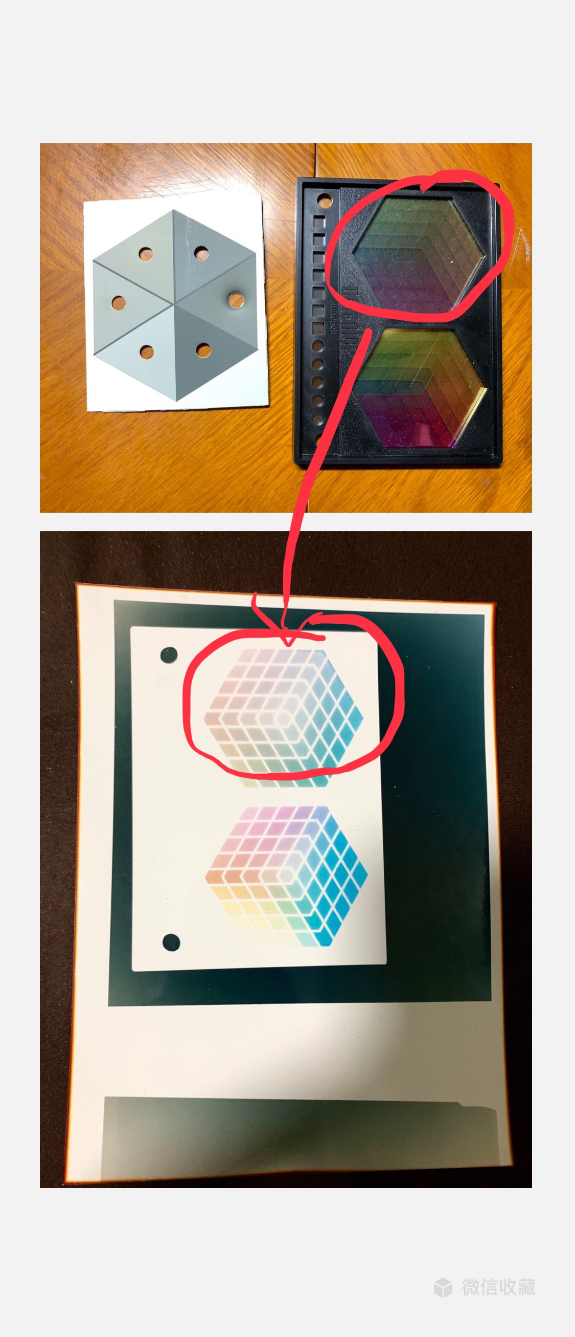

I used unicolor subtractive color calculator. As instructed, the left cube is used for negatives printing (red circle in pic). So i guess the tool should be correct .:D
However i cant find several pages on the user manual , only cubic chart with filtration tuning data is available. Perhaps i used it in a wrong way :sad:

There is at least a possibility that the "calculator" is faded/discoloured and therefore not particularly helpful.
