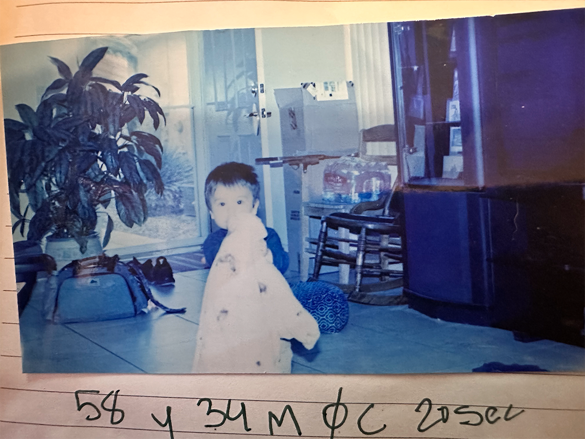

My prints are coming out with a tinge of blue/cyan no matter what I set the CMY to. Why is this happening?

Threre we go...
Ok, thanks for putting up the example @ashcorra
Your print looks very blue to me, but your yellow filtration is at a fairly normal spot. What kind of negatives are you printing, and do you get the same problems when printing fresh negatives on fresh C41 film? Does the problem occur with all negatives you've tried (from different films)?
Can you tell us a little bit more about your enlarger, the chemistry you use and your procedures? Have you tried the test where you process a sheet of paper without exposing it?
I have tried to get rid of all lights, but there may be some faint lights still.
In your darkroom with all lights out, let your eyes accommodate to the light for a few minutes. Any light that's still visible at that point can be a problem. However, the severity of the problem would suggest a light source that would be fairly easy to see even immediately after turning off the lights.
This looks like your blix is not working properly.
Sorry, but I disagree. Unblixed color prints look fairly normal with just a bit lower saturation and slightly higher contrast. The most notable characteristic is that they tend to fade to yellow/tan (especially the lighter tones) when exposed to normal light (the remaining silver prints out). The blix as such does nothing with the actual dye hues or color balance.

Probably. In my eyes, these pictures look very different. For picture posted by Timsch, I am almost sure it is caused by red light, I don´t know, whether it is in his darkroom, or if the paper had this problem when he bought it. Aschorra´s picture is very different. From a picture taken by a cell phone, it is hard to say anything, but the most obvious cause would be problems with developer - for instance, carryover of hypo. According to Kodak documentation, 0.1 mL of blix in 1L of developer is enough to ruin it totally. But he said mixing new batch of chemistry did not help. I thought about blix, but this is definietly not the problem. What I thought, is that many of the Durst enlargers have a knob called "B filter", which switches on Y40 M40 extra filter for negatives needing more than 130 of filtration (in Durst values, these are not universal with all manufacturers of enlargers). But the picture looks patchy. Could it be using too little of developer in the drum (such as 30 mL instead of 75, if the latter is the minimum amount posted by the manufacturer of the drum)? Maybe the problem is not with RA-4, but the negative is bad - due to expired film, processing failure producing leukocyan dyes., or a very old and badly stored negative with faded cyan dyes. Maybe the light bulb in the enlarger should be changed to a new one. Hard to say. these are just some ideas.
Some useful ideas there, Samu. I have a Durst with that ability to add that Y and M increase but it requires that you take a definite action and is not something that you can do accidentally and not notice it so it is possible but seems unlike to have been the cause in this case
pentaxuser
This degree of contamination will most likely result in measurable color shifts, but from my experience it won't result in such a massive color shift as we're seeing here. It would have to be a much more significant amount of carryover. But something like that could easily happen in a home setting. However, OP apparently has eliminated this possibility.
Unlikely, IMO. You generally get clear signs of unevenness in development with grossly insufficient developer formulas.
'Leuco' dyes are not intended to be produced in color film. In fact, if the image-forming dyes are partly in their leuco ('colorless') state in the finished negative, it's due to a (major) processing problem. It's virtually impossible with today's C41 films. Expired film or faded negatives are indeed possibilities, but generally you'd expect that the color balance would respond fairly normally to changes in filtration. You'd just end up at a rather extreme filter stack for a decent looking print. Since OP hasn't informed us on process and materials details, for now we can only guess.
