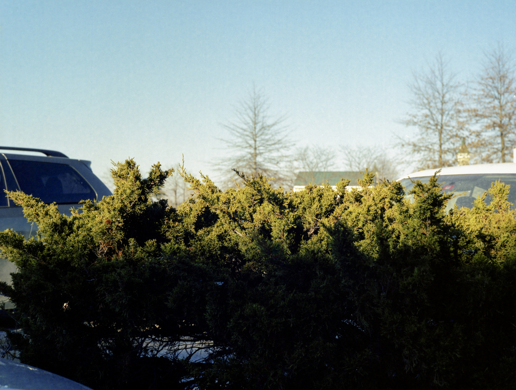

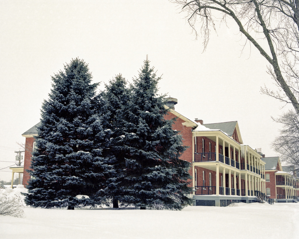

I've noticed a lot of my film has this blotchy look to it, especially in the sky. I realize this is a byproduct of analog film, and believe me, I am not switching to digital anytime soon, but I have to stop and ask around, is this typical? In some cases, this blotchiness is more than I asked for, and I would prefer a smoother tone. I wonder if I could be metering differently, or sending my negs off to North Coast for processing, instead of using my local guy.
Take a look, I've attached a couple examples.

The first shot was with Kodak portra 160 on RZ67 and the second, with blue sky, was shot with portra 400 on 645af.
the development is done at a local place, and they have screwed up my film before. This could be about my scanning I suppose, but I'll have to try mailing out to NCPS and see what all the fuss is about.

I cross reference my edits between a retina display MacBook pro, iPad air, and 27" iMac. Granted, this only gives me Apple display calibrations, but I see a bit of this everywhere. It's more like a haze and less blotchy I guess. Kind of crunchy, mixed tones where it should be smooth. Maybe I am under exposing...

I'm not sure that I could find "Vermouth" on a U.S. map but in my little home state, we've got plenty of beautiful skies. Perhaps if I shot digital you'd know what I mean, but sadly I seem to have some developing or scanning issues to address.
likely a scanning problem.
I am starting to think so as well. Canon is about to replace my 9000f due to a small piece of dust under the glass. Maybe this unit has other issues I am not aware of.
I'd say the 'blotchy' effect is a processing artifact. What format film is this? Your profile says you are a medium format shooter.
