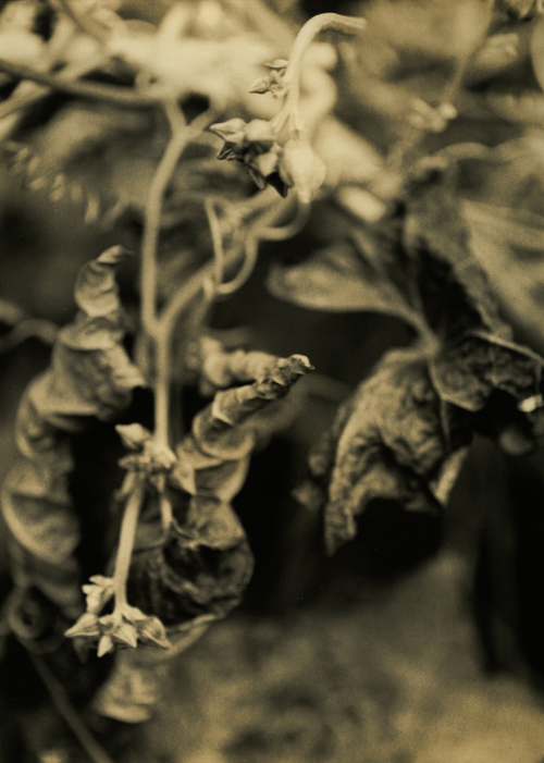

Scanning Images
I am in the progress of posting these images. I have 4-5 I will post. I wanted to show the results as I have not been able to achieve these results a second time. Here are the first two:
Loufa on the vine
1. First pass results 2160.7: though the film was poor stored, it does have a nice soft quality I think is suited for this type of work.
Equipment Used: M645/80mmf4macro
Exposure: f4-1/60th
Film & Developer: FP4+ - Finol 1+100 16:30 (film was 7yrs exp and poorly stored)
Paper & Developer: Foma MG 132 - Meritol 1+10
Toned: BL 1.5/MT3 1.0m/ BL 15s/ MT7 40s/MT3 30s/MT7 30s

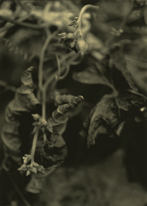

2. Second pass 2160.7
Highlights are gone and the red-orange is not showing up in the scan of the midtones. I am unable to duplicate these results. Again, these scans aren't indicative of the coloring the resolution lost so much, esp the red-orange. and good god, they're no where near that bright (#2) they must be compressed more in the upload here because I looked at the image before I uploaded and the coloration is still there. So big bummer I can't get a better upload. It's much richer then that. There, much better now.

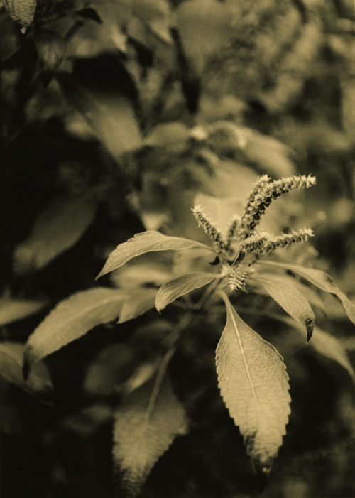

Holy Basil - Vana - (insectary)
3. and 4. Results for 2158.11
Exposure: f4-1/15th
Film & Developer: FP4+(64) - Pyrocat-HD 50m semi-stand
Paper & Developer: #1- Galerie#3 and #2 - Foma MG 132 - Ilford MG Dev
These are the ones that had the beautiful yellow-green I was talking about. (well, it's sorta there)
I kept the toning process the same for both groups so I could see results across the board for various exposures.
#2 is more red-orange but that's the best I can get. the upload is butchering my colours.
