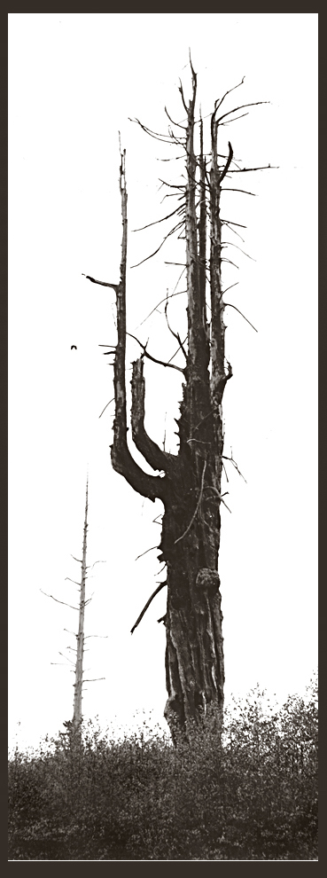

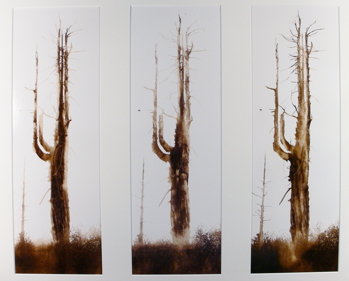

It can get a bit crazy. These are three 7x19 prints that I bleached, painted with dektol, fixed, rebleached, sepia toned, and then repeated in various ways. I was up until 2 or 3 in the morning having fun with these.
I included what one looked like before the punishment I gave them...

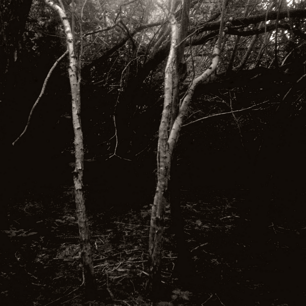

This image only works as a print because of use of localized bleaching.
Brownie Hawkeye handheld in a darkish forest thicket.
