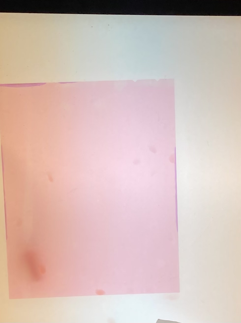

Just developed 4x5 T-Max100 in Kodak DK-50 stock(cola Coleridge) possibly exhausted? Film came out blank. Wrong dev/film combination or exhausted dev? And no I didn’t leave my lens cap on.

That’s cola colored. Dark brown.thank you

Let's get these out of the way. Did you pull the dark slide or fix before develop? :wink:
You can do a quick test if you have any developer left. Dip a film leader in to see if you get anything.

Thank you for the suggestion. Yes I pulled the dark slide. The film is completely see through, no density on emulsion. I had luck before with Kodak D-76 , guess I should stick with what works.

If the DK-50 developer is dark brown then it has expired, it is no more, it has ceased to be.
As a check, is the Kodak imprint visible on the margin of the film?

Your developer was expired. Always do a clip test on your developer before committing valuable film to it, especially if it has been stored for weeks/months. I always keep a sheet of old film handy to cut a strip from, to test developer activity before using.

This is what it looks like. I know the color is due to not enough fixing.Thank you everyone, in keeping with the Monty Python’s reference, I have a dead parrot.
