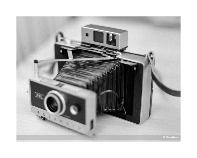

First, I tried a fresh roll of film, Arista EDU Ultra 400 in the Mamiya 645 Pro TL camera, souped it in HC-110 dil.H and all frames came out fine. Therefore there was nothing wrong with the camera. Here is a test shot:

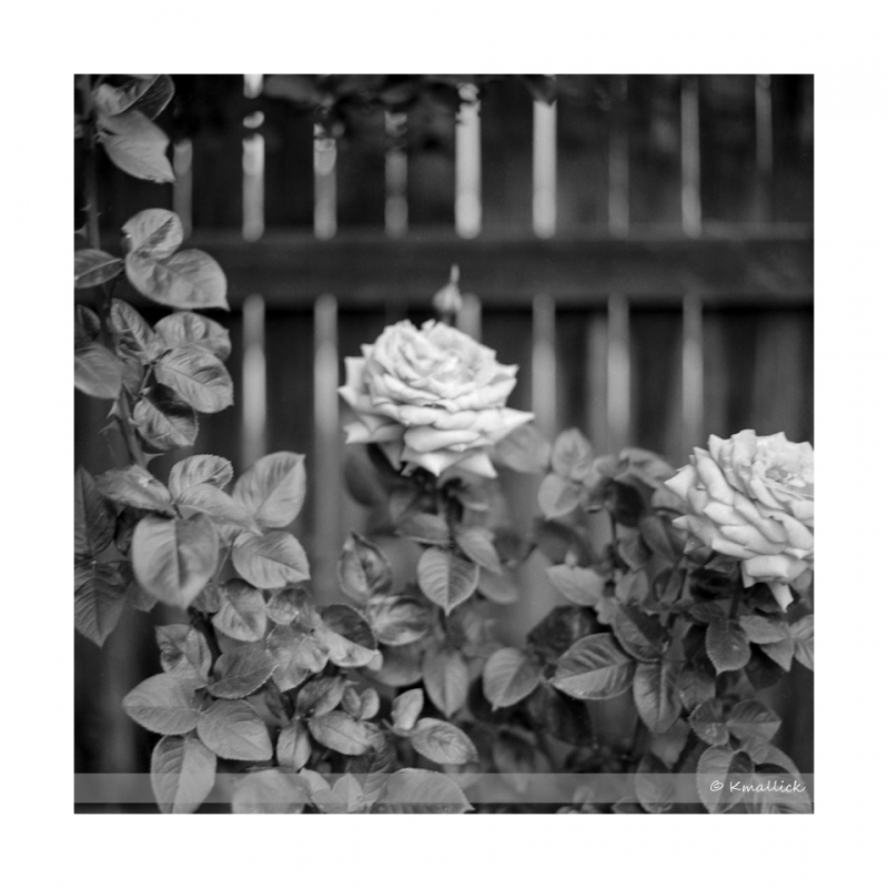

Next, I shot another roll of the suspect Agfa APX 100 film in a different camera, a Bronica SQ-Ai and souped it using the exact same method as before (Rodinal 1:50 for 13 mins). All frames were exposed properly. Here is an example shot:
Nothing wrong with the camera or the film. Its just that the film was loaded wrong. And I didn't even know it. :blink:
