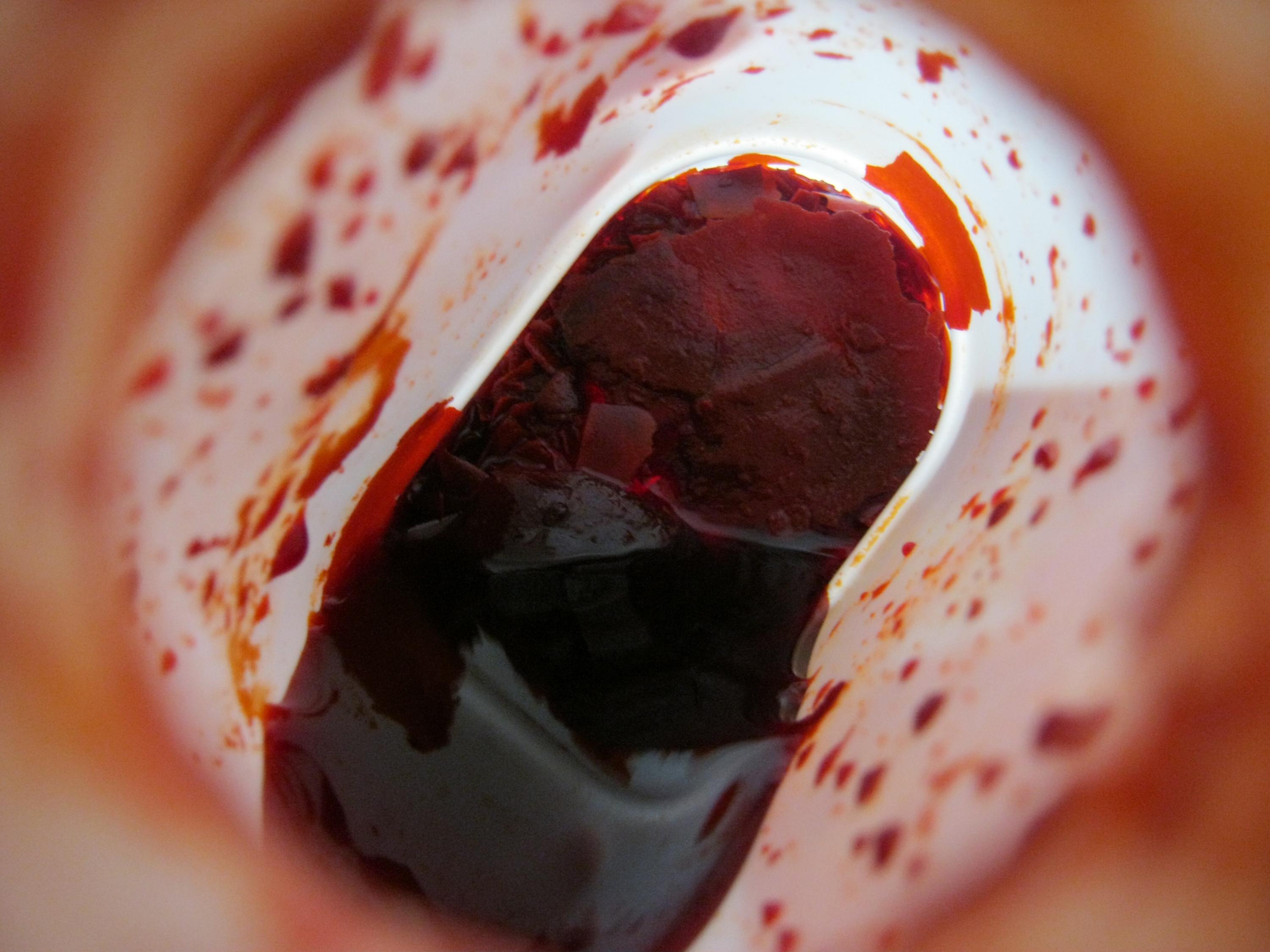

Also, I looked into the bottle and saw this:

No, No, No! A completely blank film indicates that someway, somehow the film was fixed before it was developed. The only developer that can comepletely lose its activity is Xtol. Rodinal, even when it is very old and improperly stored, will still produce some detail. The image may be very weak but there is something there.

If you're 100% sure about your sequence of development your working solution Rodinal must gone bad. You're sure you made it just before starting development? Or maybe you had a severe contamination in this bottle. But believe me even with contaminated Rodinal you will have a faint picture and then the whole film has a higher base fog too.
