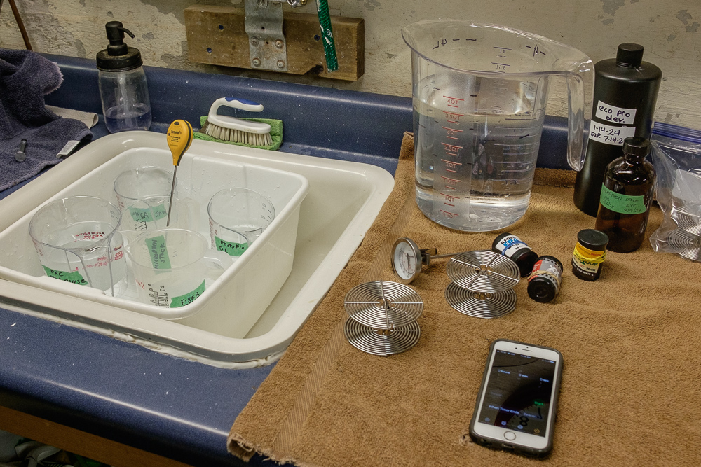

Earlier this evening, I processed a 35mm roll (36 exp) of Kodak TMax 100, in Claytons F76+. The entire roll came out blank, no edge markings, but evidence of halation dye during the rinse cycle.
My first thought: bad developer: I applied a drop of the developer I had used to the leader belonging to this roll, and got the big black dot—assuming that the developer is okay.
My process is pretty established, I prepare solutions in “reverse order,” meaning HCA first, then fixer, then stop, finally developer—which in this case was a matter diluting the prepared developer, 1 + 9 to distilled water. It’s pretty unlikely that I’d confuse fixer for developer as the fixer has already been prepared and is sitting in the queue.
I clearly saw evidence of the anti-halation dye during the various pours between stages of development. I fixed for about 4:30 in freshly mixed Claytons Rapid Fix, diluted per instruction.
I completed the wash cycle, went to hang the film and to my surprise the roll is totally blank—no markings of any kind.
I checked the camera’s shutter and it appears to work normally (all of my cameras had been recently CLA’d—but it’s worth checking anyway). That said, I’ll put a roll of Kentmere through it tomorrow and process with the same chemistry I used this evening … as a sanity check.
Naturally, I’m interested in any additional tests or hypotheses others might be able provide.

Do you pre-rinse?
And is there any chance that the film was never actually in the developer?
In other words, (pre-rinse if used), stop, fixer, HCA, wash - but no developer.
This test can be confusing, since dropping a liquid (even water) onto a piece of unprocessed film can give the appearance of density. Did you exclude any false positive here by fixing the strip of film, which should have revealed a dot of density on an otherwise blank piece of film?
No edge markings= fixer before developer.
This is really the most likely cause.

I thank everyone for their quick and helpful responses. And I agree with the consensus opinion: it must be a developer problem—given the statistical likelihoods … .
Now the problem becomes determining how that might have happened. I’ve been decanting one liter bottles of developer into smaller containers because I generally process one to two rolls per session. In this way, I can store the unused developer containers in a refrigerator at much cooler temperatures.
Clever is often the culprit.
I surmise that those plastic bottles were somehow the source of contamination. It’s extremely unlikely that the developer, out of the bottle from the manufacturer, was contaminated. The only remaining possible source of contamination had to occur during the transfer (and storage) of developer in separate plastic, screw-top bottles. [This assumes that my lab ware is clean. I thoroughly wash and treat tanks, reels and beakers in Titan Blue Systems Cleaner, before the final rinses and drying.] The irony here is that film chemistry is probably the least expensive component in the workflow

Contamination causing this sounds odd to me. I would have expected some density and/or fog.
I thought about this as well. After the film dried, I examined it closely and found one or two “trace” images near the end of the roll. As I recall, the last few exposures on this roll were about +1 or +1.3 above the norm.
Following up, I then examined the last roll that I’d processed with that particular developer. It was a roll of Tri-X, exposed at 250-320 ASA, processed in this exact developer about two weeks prior. The setting for most of these images was heavily overcast. I noticed that the edge markings on this roll were nearly unreadable … having a faded appearance. The images themselves seemed fogged, but I attributed this, at that time, to the lack of inherent scene contrast. In retrospect, I choose this particular film with the scene contrast in mind. Reading through my processing notes, I agitated this roll a little more aggressively—again, bearing in mind the relative flatness on location.
I am no chemist, but I wonder if within those two weeks the developer had deteriorated without showing a big change in color—Claytons about a month in use appears somewhat “straw" colored, or even slightly beige but has worked.
I suppose that I can replace the developer and see what happens.
This is possible, yes. Many developers die without a distinct color change. I don't know the composition of this developer, so I couldn't comment in more detail.
It sounds like there's a considerable chance your developer was already "going off" when you developed that roll of Tri-X a couple of weeks beforehand. Hindsight is always perfect though and at the time those negatives probably didn't give much concern.
I was thinking that in over 40 years of developing film, the one time I had a film come out completely blank with no edge markings was when I was anxious to get developing after a two week summer holiday. The developer I was using was ID-11, several months old. While the previous film (developed maybe 3 weeks before) had been fine, the developer probably was beyond it's best. I should have been more patient and mixed up some new developer.

You wouldn't be the first person to accidentally fix a roll of film before developing it, no matter how careful you are in laying out your chemistry.
However, if you determined that there are very minimal images present on some frames of the film, then you didn't fix it first - it had to be something awry with the developer; either it has expired or was somehow contaminated. (Do you make a stop bath when developing film? Any chance you accidentally added an acid to the developer, mistaking it for the stop bath container?)
I've never heard of any manufacturer recommending refrigerating a developer to extend its longevity. I don't know that this practice is doing you any favors. The first thing I wondered was whether the cold storage forced an important ingredient to fall out of solution, or somehow be degraded by cold? Dunno. But the thought occurred to me.

The thought that refrigeration may have resulted in some changes should be considered. I have poured the questionable developer into a flask and examined it for any evidence of sedimentation, etc. None seen. That said, it could still be problematic. I will follow-up with the manufacturer and let you know what (and if) I hear anything about refrigeration.
