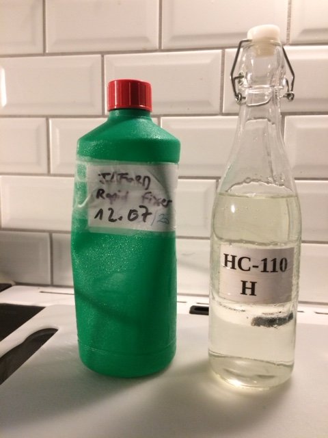

also, I am totally positive I didn't pour fixer instead of dev, because the way I do one shots. I keep colored plastic bottle with fix, and I use clear glass bottles for the dev.
I have just processed a roll with HC-110. I mix HC-110 with water, then pour it in a bottle. Bottles are put in a sink full of temperature controlled water for some time, then I process, grab the glass bottle first, etc.
I the case of this Rodinal, I did the 1+50 mix, which gave a dark yellow liquid. I poured that first in the thank, dumped it after dev, stop and then grabbed the plastic bottle with fixer. It's fool proof and I was not drunk :smile:

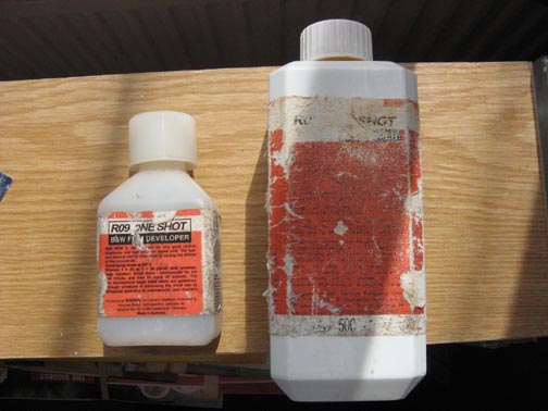

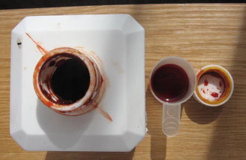

I use ro9/one shot, made by Compard, sold under the Firstcall label, supplied in softpak, on friday I used up the dregs of a 5 year old bottle to see what happened, it was black, with crystals rattling around, the film was Fomapan 400, and deeveloped as normal, I have just finished printing the results, the negatives were fine, printed on grade 2 to 3 as normal, I have nevr had the ro9/one shot go bad, even with crystals forming, I always use it down to the last 10 ml( the amount of concetrate I need to develop a MF film), it lasts as well as Agfa rodinal, at least for me, could be the softpak that helps to exclude air, but the last drop that I used on friday was from a plastic bottle that I decanted the softpak when I got it new, in 2015, I know the date because I always put the date recieve whatever I get,Paper,chemicals Ect, so in mmy experiance of RO9/one shot, which I have used as soon as it was for sale as a replacement for Agfa Rodinal, is that it keeps as well as the original,mind you, I am not that careful how I store it, it is on the chemical shelf with everything else in the darkroom, gets hot in there in the summer, don't know if my storage has anything to do with it, but I have never been that careful about storage, and never get problems with it, but it works
