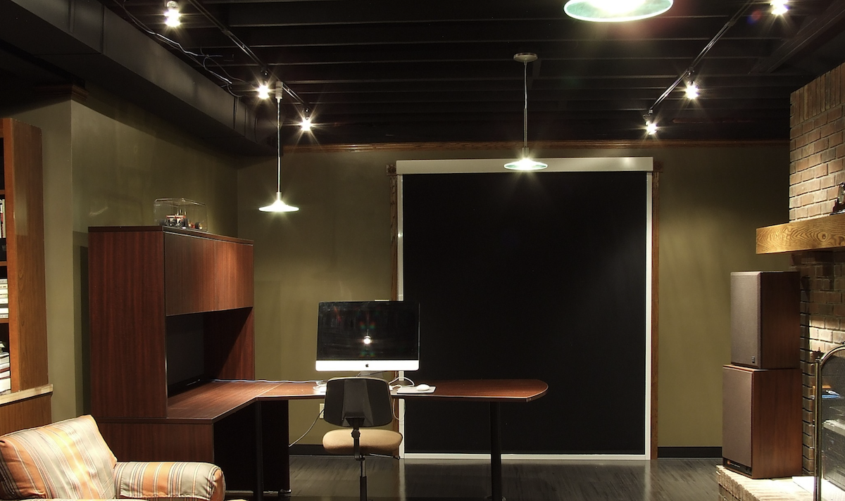

I installed a blackout blind. It was extremely difficult to find these. Lots of ads on the internet but no one actually sells them. It took months of searching.

Nice with those old school speakers looks like a hip Batchelor pad.

I believe he was showing his solution to a request by his wife, in a space other than a darkroom.
This looks to be the 'blinds' in a full frame affair, and possibly motor driven or am I at the wrong end of the stick?

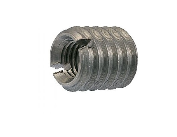

A drawback is the machine screws protruding from the frame when the blackout is not in use. I used a similar wood/metal combination, except with a female metal thread; Just to be clear because I don't know the exact name in English:
Rampa nut, Rampa head screw insert, Rampa muffle screw insert, there are many variants.
