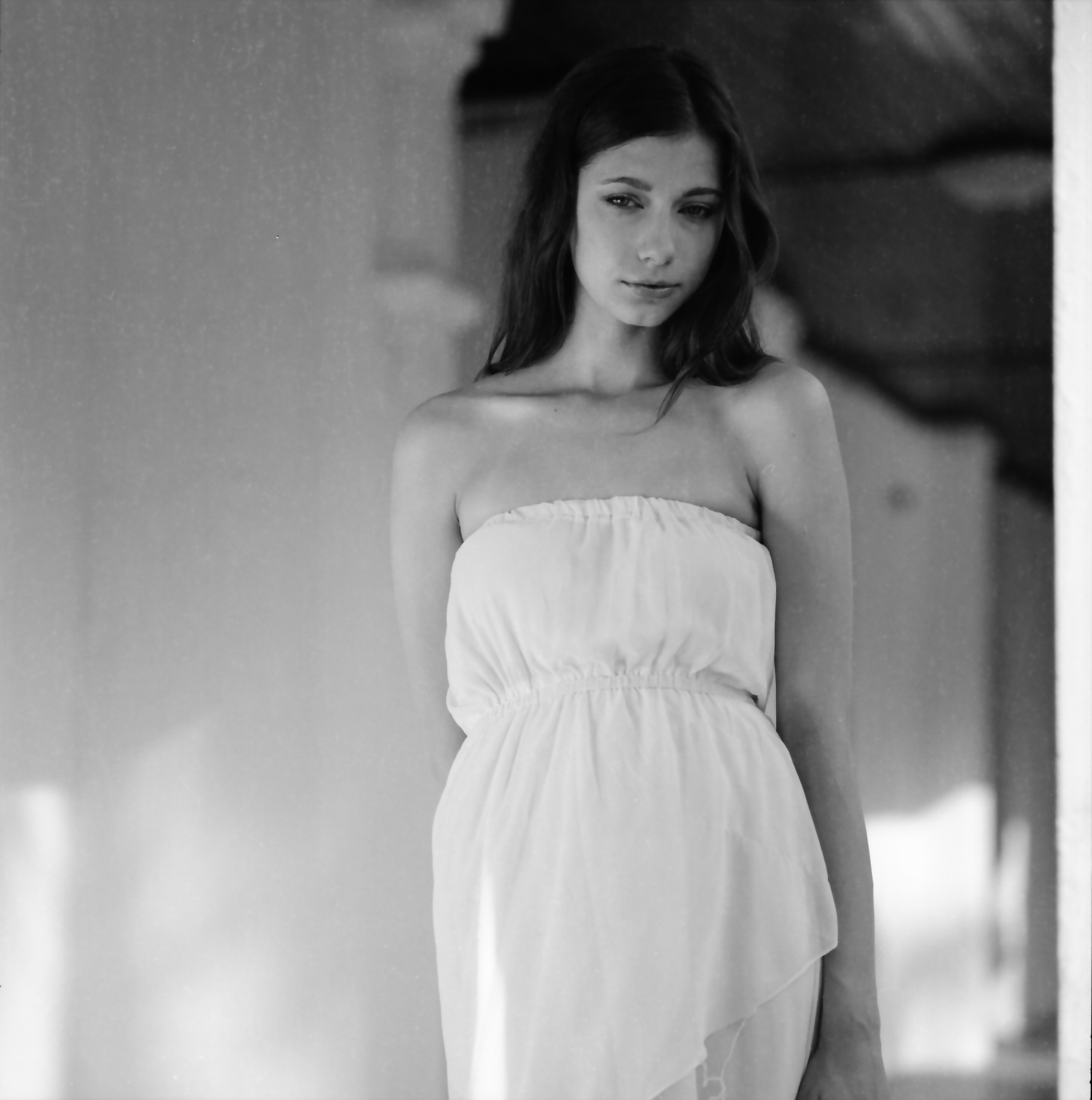

Black Spots on Pan F negatives
I just processed several rolls of 120 Pan F film that I had shot but did not process for about 5 years. They were kept in their boxes in my basement office, but not refrigerated.
The image quality was severely degraded and covered with black spots. I then tried processing rolls of Tri-X that were shot at the same time and kept under the same conditions.
The Tri-X didn't show any degradation of the image or have any black spots. Both processed in DD-X. Apparently Pan F does not hold up under long term storage.

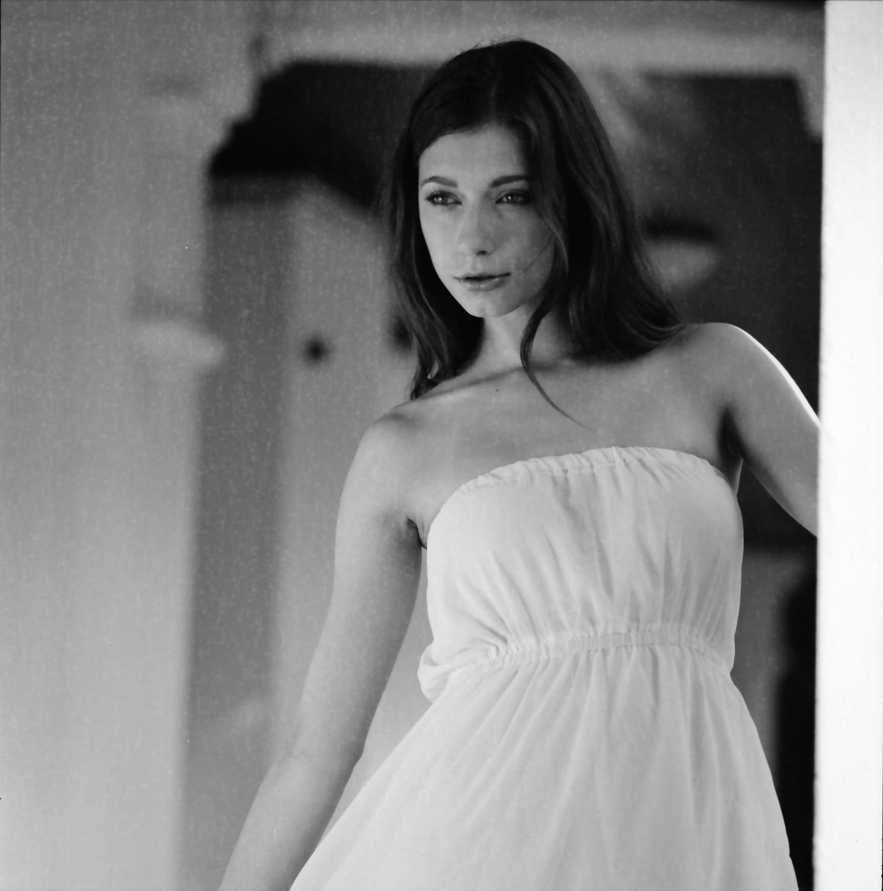

I processed 10 rolls of Pan F+ 120 in Adox Adonal 1+50 at home and all the rolls having same spot, sample attached.
..forget those 'poo-poo' replies! This condition is most definitely the film. ILFORD has never addressed this issue. We dont know what actually causes it, but suspect this happen to long cold stored film. Something in the paper is causing a reaction in the emulsion.

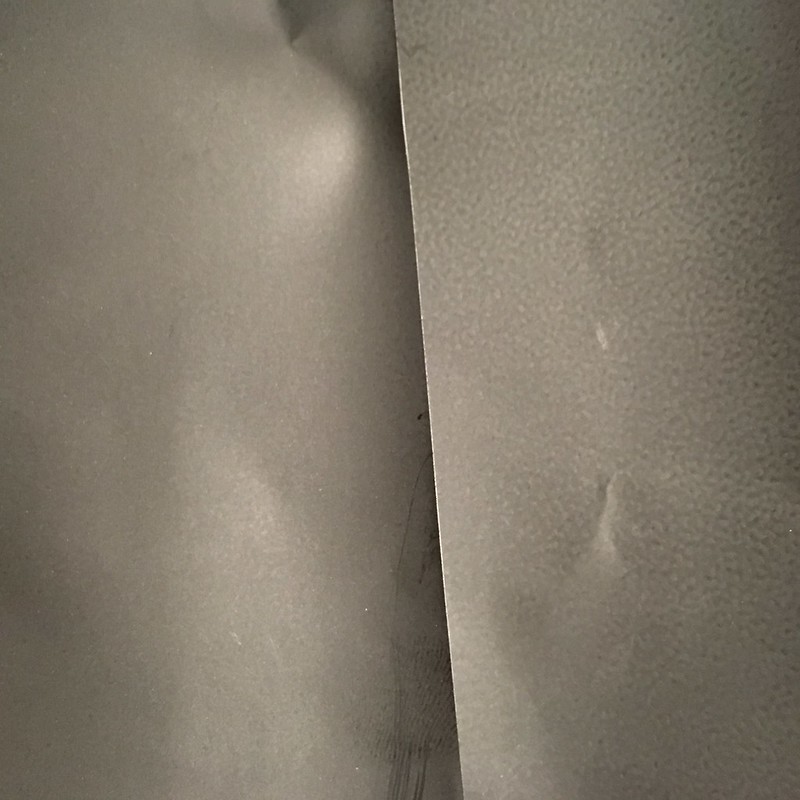

I think I found the problem: the protective paper has been changed it is more granular and when making long time exposure the paper refers to the light and brand the film here is a picture of the difference between the two papers
Thank you for updating this thread. However the effect of the backing paper over time or poor storage will not show the spots complained of here. That effect looks like this on HP5+ 120, which you will note matches the "pattern" on the paper you show:

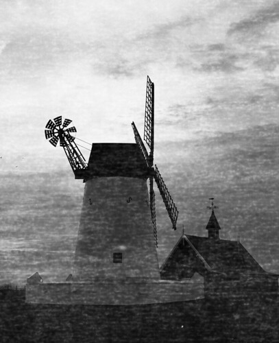

I had one case of Pan F Spots -- it was dated 1978 and been in fridge for years -- I think it could be the backing paper reacting -- I used MK35 Formula ( a 'Single-Solution Beutler ) formula I made up myself. Camera was a 2002 Hasselblad 501CM + 80mm f2.8 CFE Planar.
Are you suggesting that the grain patter on the right is due to the backing paper? I would beg to differ. That grain structure is characteristic of the emulsion (regardless of format). I've gotten similar results on Pan F in Diafine, 35mm.
It is a comparison between protection papers. that's the only difference I found between films that I used before and those that pose a problem today.
