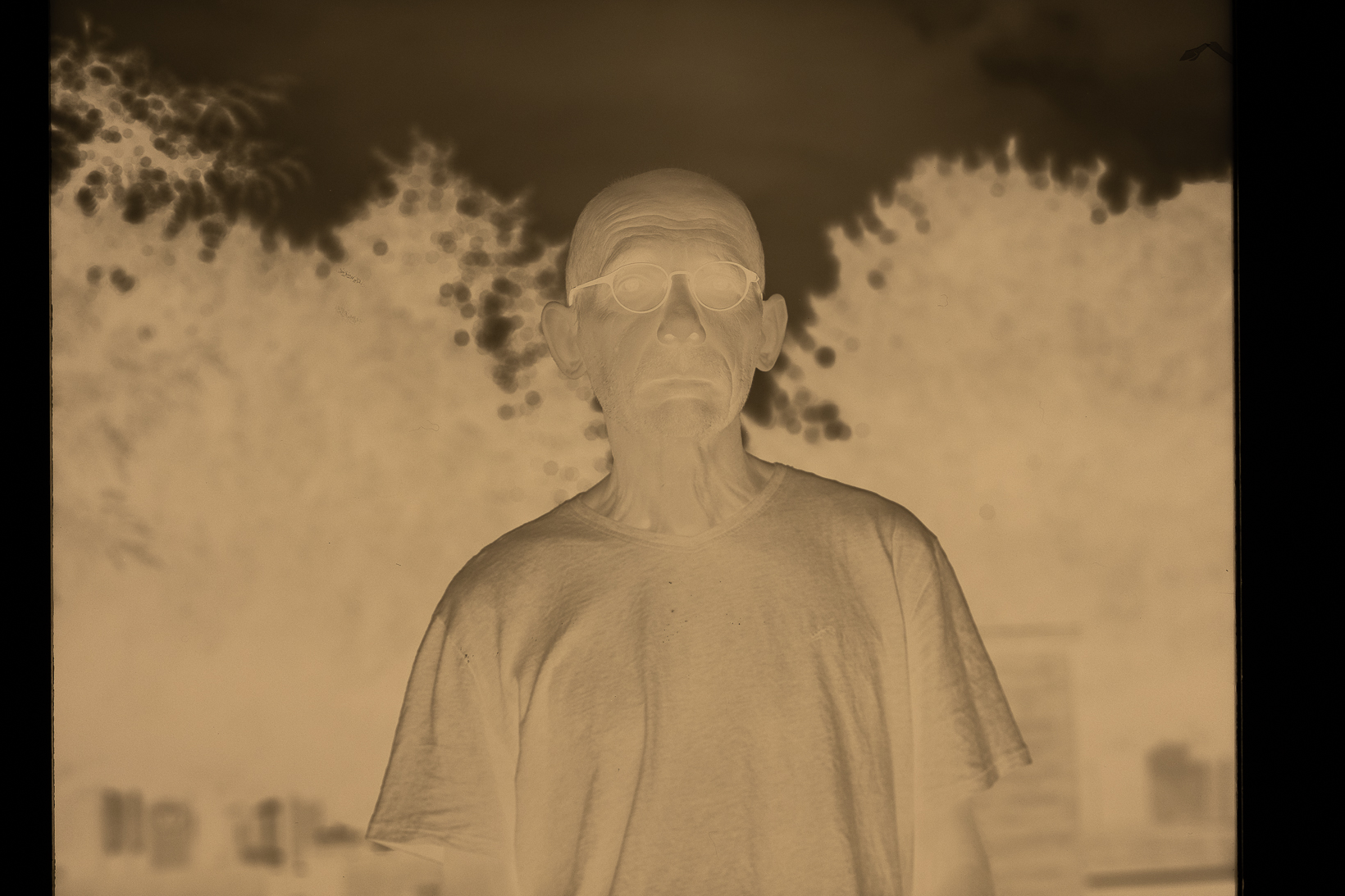

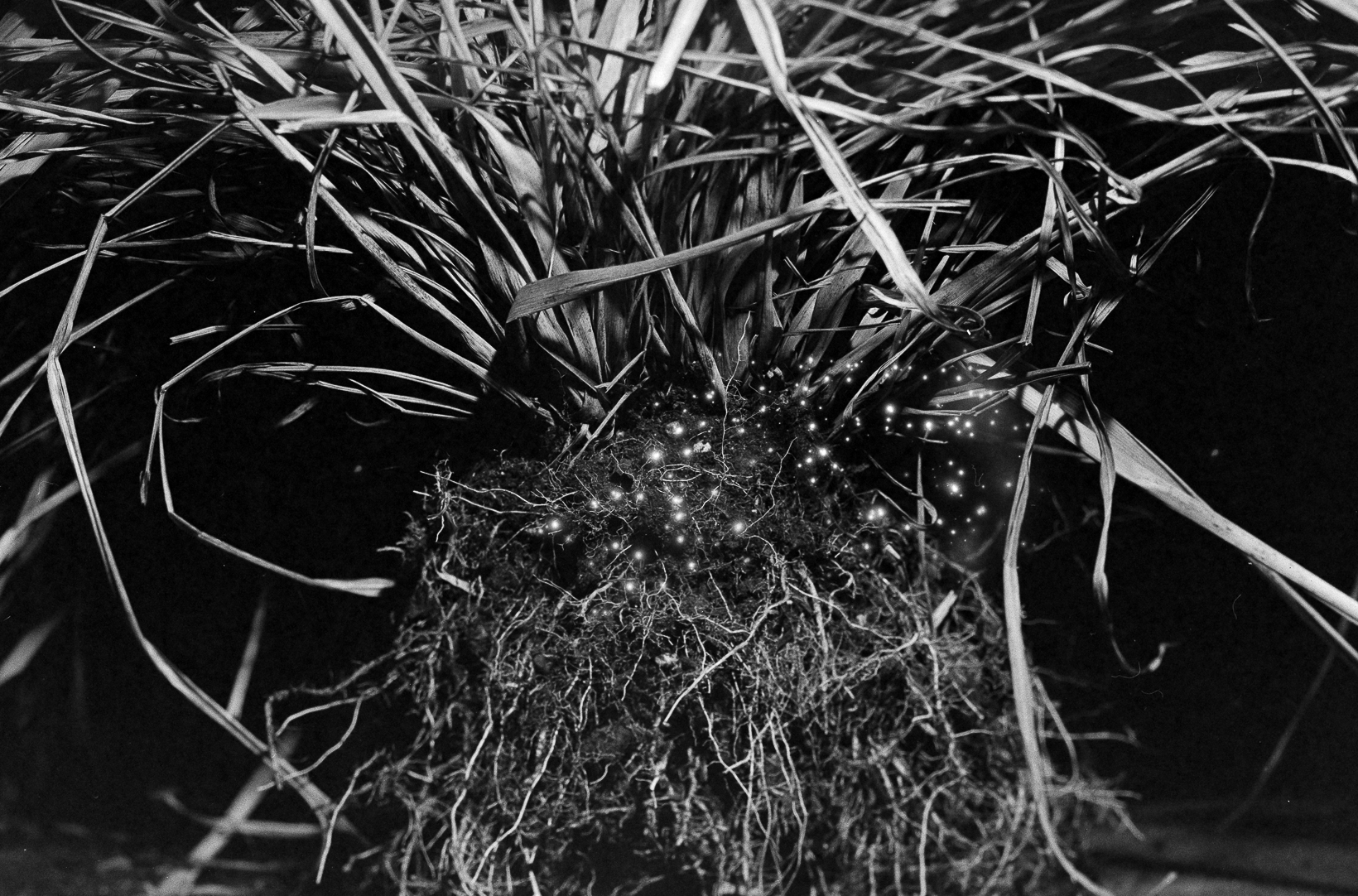

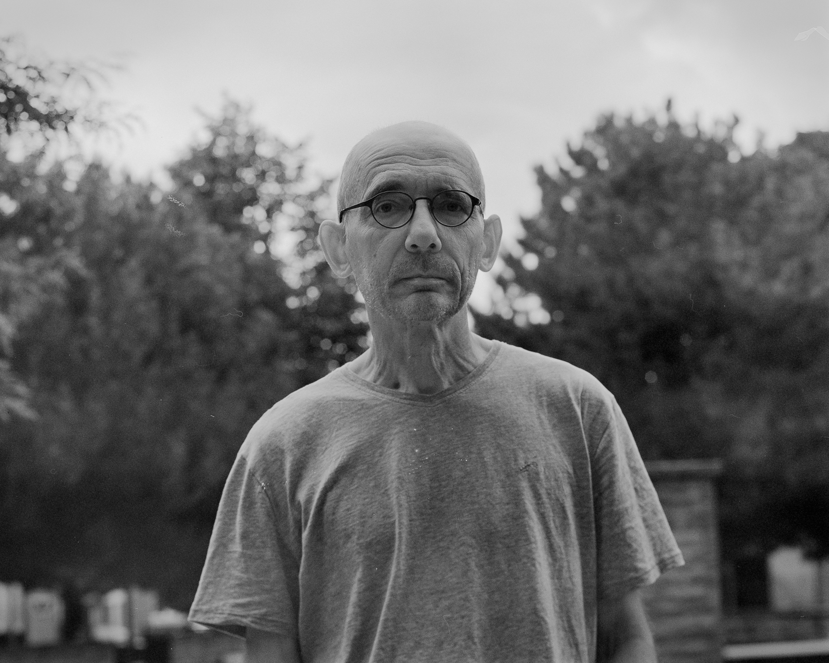

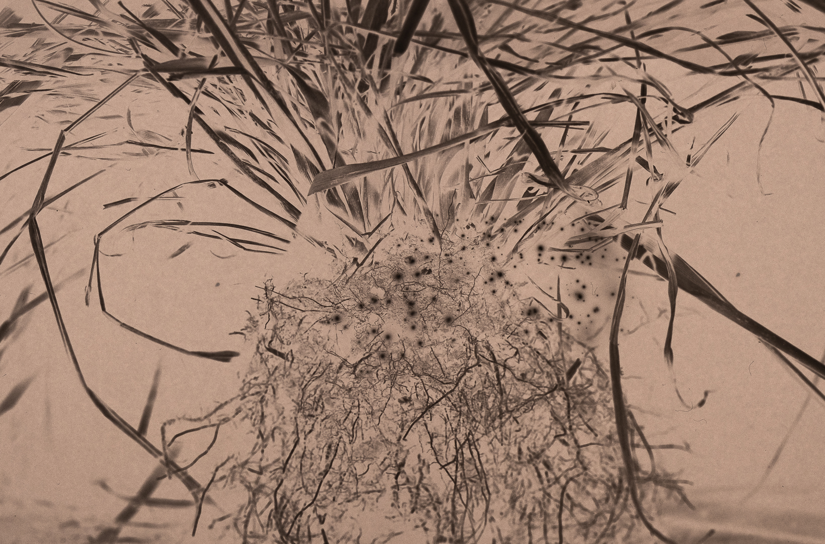

Hi! I am a beginner with large format (4x5). I have those black spots on a couple of negatives (white on prints and scans). Mostly on one negative and a little bit on a second one. They seem to appear in the same general area in both cases. I developped about 10 negatives before these and it didn't happen before. In one instance (the picture of the plant, included here) I took the same picture twice in the exact same conditions with a flash and without moving the camera. One of the picture has the spots the other doesn't. They have been developped both the same day in a sequence in Xtol 1+1 in open trays in complete darkness and they come from the same film holder (one from each side, so not the same darkslides). Are these light leaks? I checked the darkslides in the dark with a fairly strong flashlight but didn't find any leaks. I could be mistaken I guess. If anyone could advice me it would be greatly appreciated. Just got myself a nice box of Provia but now I am fearfull to use it...

Matt, check out the positive of the man at it's biggest size, then at that enlargement onscreen, you can see hair dust and some other artifacts, which were most likely deposited before exposure. Don't ask how I know. :sad:

A spot like light leak on the film holder is indeed weird. To me the second image of the negative looks more like there are fine holes in the plastic bag of the film and someone opened the film box and exposed the plastic bag to light. I would say it is definitely not caused by dust on the film, that would lead to blank spots on the negative and it also does not look like dust spots on the negative during drying. Such kind of dust would not cause that fogging around the spots.

Actual dirt on film
