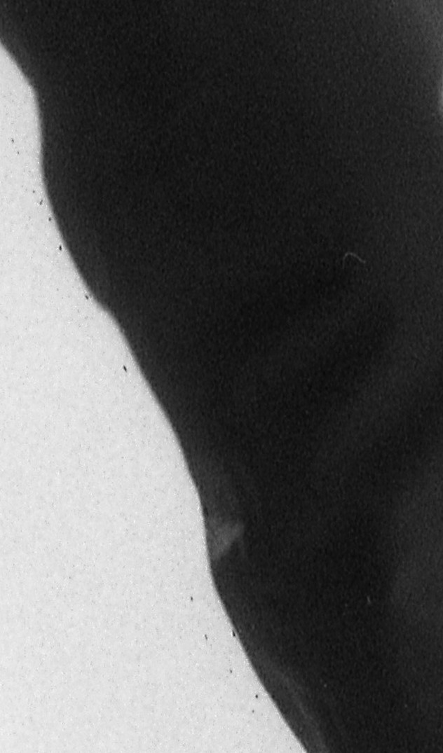

On prints and scans I sometimes get small black dots or specks, usually in a light area in close proximity to a darker area of the image. Most noticeable with Rodinal on slower film emulsions, like FP4+ or Fomapan 100.

No guys, it isn't dust. It's as if the darker areas of the scan or print - clear parts of negative - have silver particles that have drifted away into surrounding light. They don't occur in other areas.

Here is blockend's example...
Thanks for the help, Andrew. This is a small portion of a scanned negative. The specks occur where dark and light areas meet, there's a complete absence elsewhere in the image. I don't think it's a digital artefact, the black dots aren't geometrically pixelated and seem quite random. Nor are they associated with any particular object, surface or texture. It looks most like a grain aggregation of some kind.
FP4+, Rodinal 1:50, gentle agitation every 30 secs. Scanned at 3200 dpi on Epson V500.
Very strange, indeed...
I've just had a very embarrassing thought. The series this image was taken from was shot in the evening, in farmland. An increasing yet unavoidable feeling says the specks may be gnats, midges, in other words flies. If I'm right my past Photoshop interventions have been more than a little misguided. Face plant waiting for a better solution.

It's surprising how once you've convinced yourself of a cause, you'll only look for solutions that fit the theory. Living in a rural area I have noticed this phenomenon before, and always thought it was chemical not optical. Midges stay close to objects, especially people and animals. Vintage 35mm lenses are sharp enough to show the object, though not the detail. An acutance developer like Rodinal sharpens, but small objects get lost in the pronounced grain.
