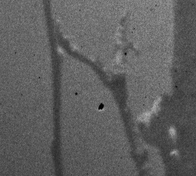

first time seen ever in one of my negatives. They seem to appear at different locations with every scan.
Some background info here:
Film: HP5+ 120
- new camera : holga120wpc
- new developer: Rodinal semi stand with one 15 seconds twiddle
I wanted to blame the camera but the specks move but also look like holes

If you make multiple scans of the same negative, the spots move? Have you examined the negatives with a loupe or magnifier to verify that the spots are not on the negs?

On the negative. I think new holes are being created every time I move the negative around?

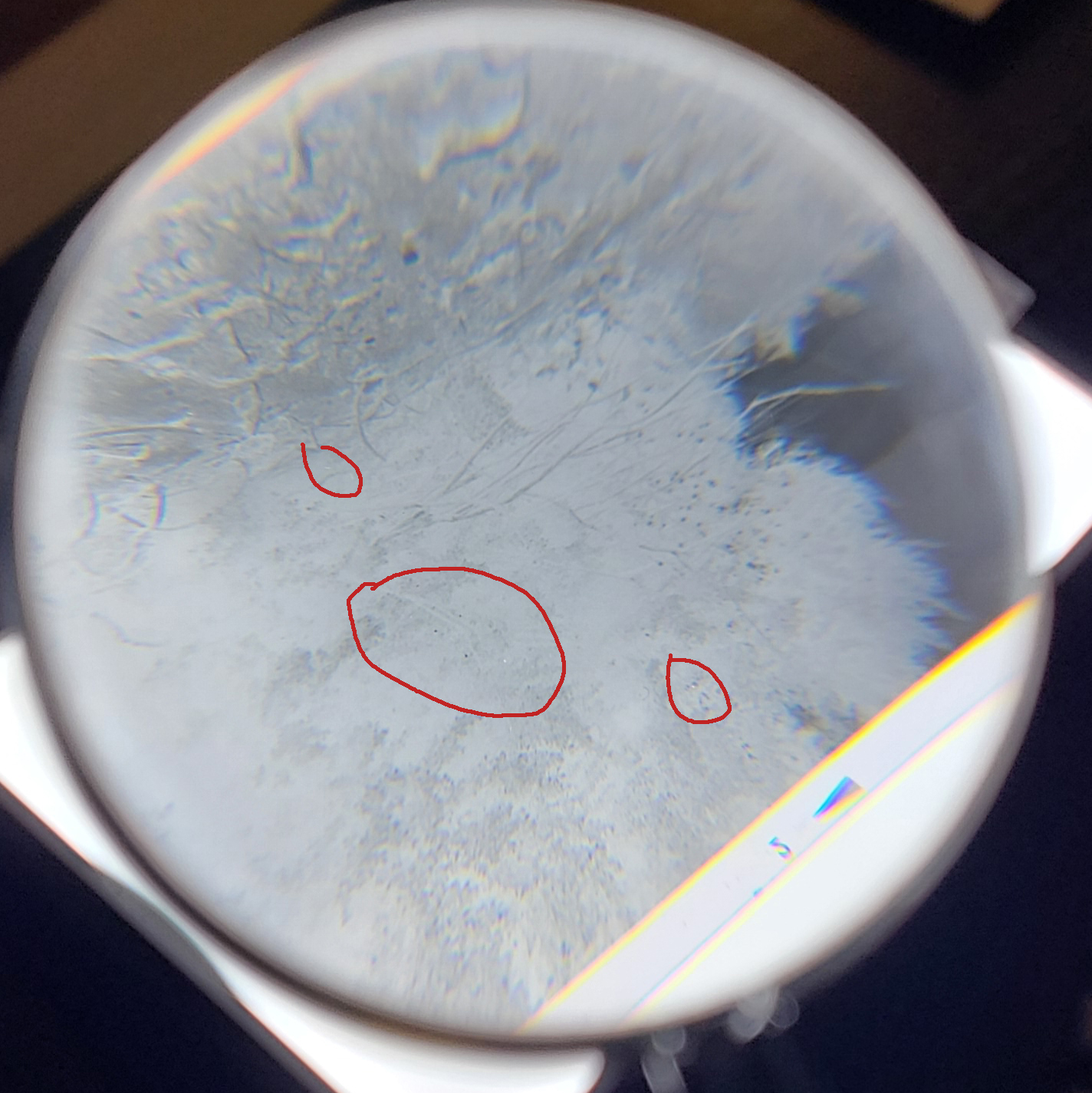

Thank you for replying. Yes, that is what I'm saying. If it wasn't that strange I would not post it here. It took me a while how to take a picture looking through a big magnifier. Tiny pieces are falling from the neg. Here is a picture, I hope it helps. I'm just curious to see what can cause such a thing. They are the ones at the top and the big one at the bottom.
Could these be particles that did adhere to the negative during development?
Is it possible that loose particles from the plastic camera or the backing paper did adhere to the negative during development? Or from the Patterson tank?

Those don't look to me like clear spaces in the negatives.
Those look like dust or dirt or some other detritus on the negative.

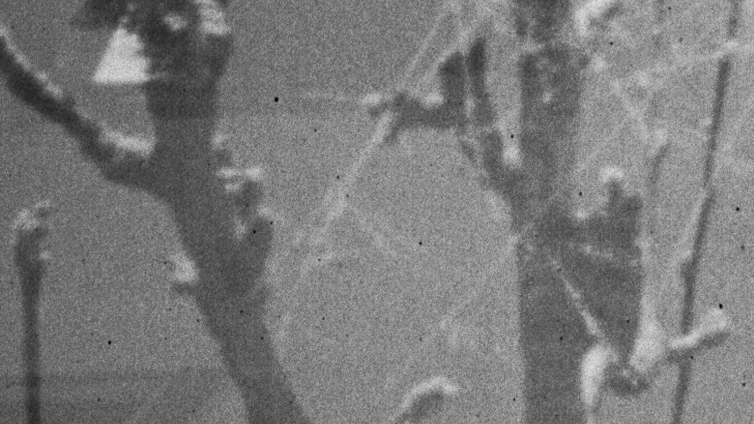

Sorry, it is really hard to see on that picture, I took another one, really hard to focus though. There are both white and black specks and they are part of the negative, not dust.

Clear spots on negatives often arise if there is dust in the camera that falls on to the film at or before the time of exposure. That dust blocks the light from getting to the film. When you print or display a scanned positive from that negative, the spot where the dust is is clear on the negative and black on the print or the screen.
Black specks on the negative re often dirt or dust embedded in the emulsion due to the conditions of either processing or, more commonly, drying.
