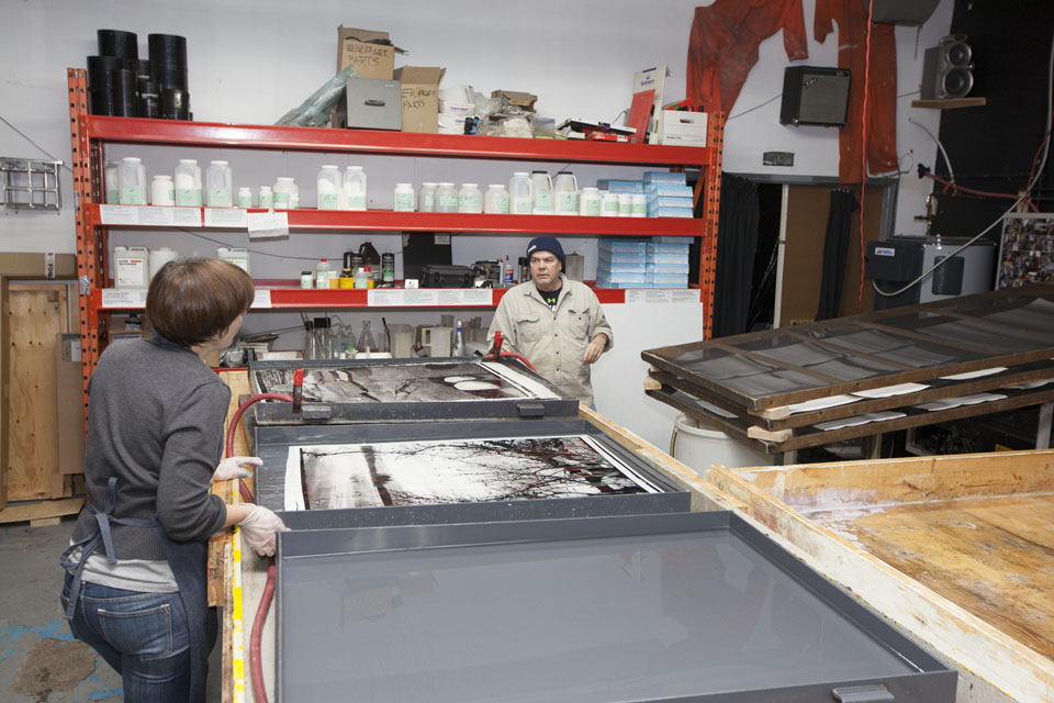

Ok a bit of an update... bleach retouching on the print is a real pain in the ass if you are doing murals.
25 30 x40 inch murals printed washed and dryed properly,
then hand bleached by Rose Scheler of Toronto.
then Re fixed , selenium toned , hypo clear and wash to normal standards...
This is basically double the physical work and IMO too much handling , I am investigating a machine to use Old School that vibrates the negative and then density is applied to the negative to print white so that I do not have to go through this every time.
I brought Brad Pitt into the lab to pose with Paulette as she does the hard work.
That isn't an optical illusion, he really is that short!
