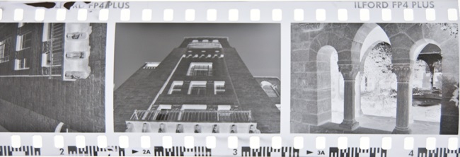

What would cause black circles around sprocket holes when a film has been developed per ilford standards, stop bathed for 2 minutes, and fixed for 4?

Either light leaks or excessive stress on the film during winding/rewinding.

If you could post something like this, it might help.
