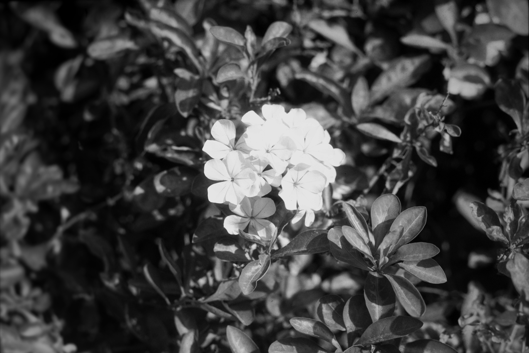

I recommend Fomapan 400 (Light gray film base but it doesn't have much impact.), which can be exposed at EI 200 and developed as a reversal at ISO 3200. There is a formula on Reddit (search "First and second attempt at B&W reversal" ), and I successfully replicated it.
