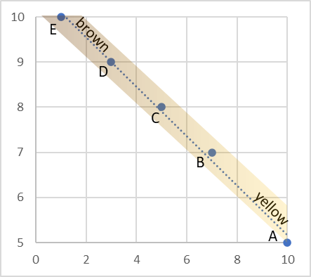

koraks
Nov 29, 2018
26,778
Europe
Ive also read that sulfur based toners can be used in the same way as a thiourea developer
It's essentially the same thing. Thiourea + carbonate (or hydroxide) is essentially a sulfur toner.
there are som more neutral then the thiourea developer
I don't think so. Silver sulfide is brown, basically. You can influence the hue a bit, shifting it between a dark chocolate/purple-brown and a more yellowish burnt sienna brown - but thiourea is in fact the most flexible in achieving this, in my experience. Try using a little sodium hydroxide instead of the carbonate. I once did a whole toning gamut for thiourea sepia toning (the redevelopment step is what you're suggesting) where the hue was varied throughout this gamut. I must have the actual strips somewhere as well, but I plotted it in Excel for reference; here's the essence from that worksheet:
Working solution: grams
100ml . NaOH Thiourea
A Yellow 5 10
B . 7 7
C . 8 5
D . 9 3
E Purple-brown 10 1
The molar ratio for yellow is around 0.5 (NaOH:thiourea) and 10 for deep brown.
With carbonate, you'll get the lighter hues due to a lower pH, I expect. I only did the quantitative tests with NaOH though.
I found that bleaching the prints (this was for B&W silver gelatin prints) with copper sulfate would create a sort of split-toned effect with blueish highlights, but this was really just a copper salt getting stuck in the emulsion; the whites would also stain pretty badly as I recall.
So yes, there are some ways to modify the tone, but if you're going to 'redevelop' using sulfer, you'll have to be content with some form of brown. This is especially the case in an application such as yours where you convert all silver halide to silver sulfide, as opposed to a print toning situation where you typically don't tone to completion.
