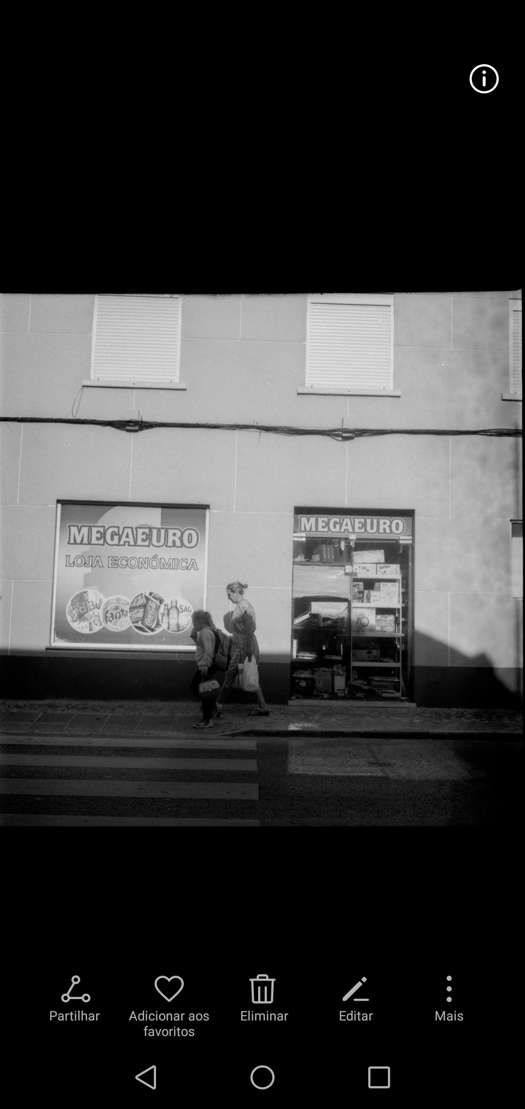

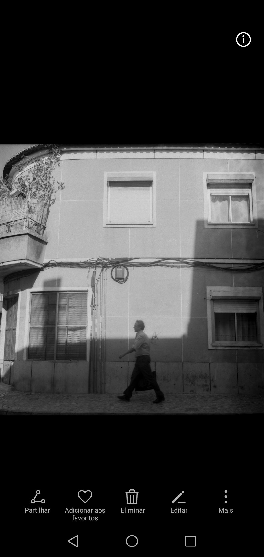

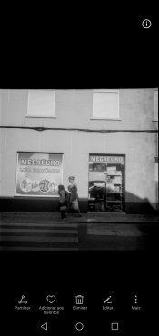

I reveal it in black and white at home, I have now started revealing 120mm and the 4 5 rolls that I made most of the photos appear to me with these spots usually on the right side of the photo. What will be the problem? Little liquid? Agitation problem?

a better translation would be....
I develop the B&W film myself at home. I have now started developing 120 format film and the 4 or 5 rolls ....
I don't know Portuguese but I do know a little Spanish and I can see how one might translate the Spanish, "revelada" to English, "reveal" but, it should be some form of "develop".
When you use a 2 reel Paterson tank to develop the 120 fim, use 600ml in stead of 500 ml of fluid and probably the problem will be gone.
