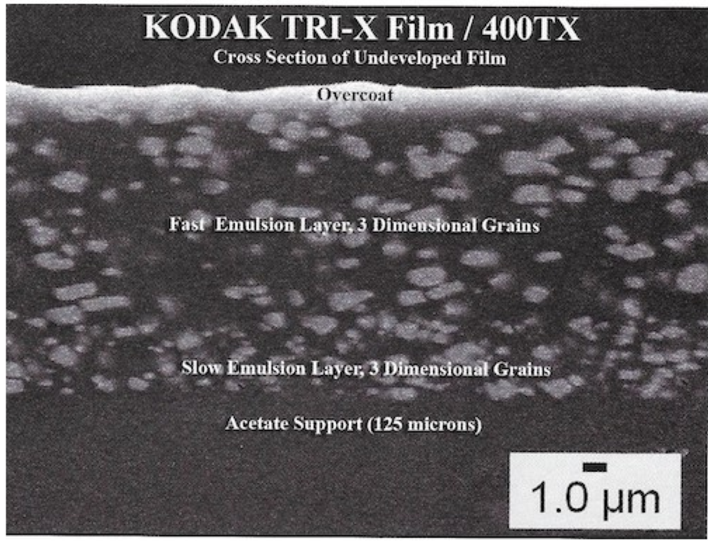

Tri-X 320 sheet film is different from TX400 roll film, but in just how many respects I cannot say.

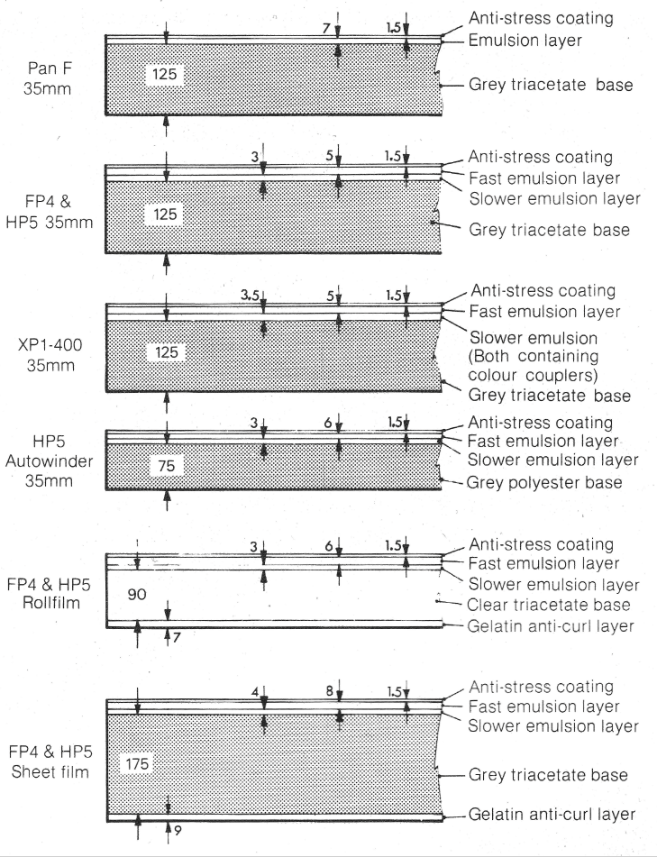

From Shanebrook, "Making KODAK Film", 1st Edition . Figure 3, page 8.

It's interesting that the emulsion layer thicknesses for FP4 and HP5 differ for 35mm, rollfilm, and sheet film.
And also that they write "rollfilm" (no space) and "sheet film" (space).
DREW WILEY
Jul 14, 2011
14,594
8x10 Format
HP5 sheet film has been coated on polyester base for a long time, not triacetate; and it isn't gray. That seems to be the case with all Ilford sheet films. A tinted base would be more characteristic of roll film, which the diagram oddly lists as clear. So I wonder if there are other errors on that posted diagram. HP5 has also undergone certain subtle emulsion improvements over the years, only one of which was formally designated as HP5 Plus.
