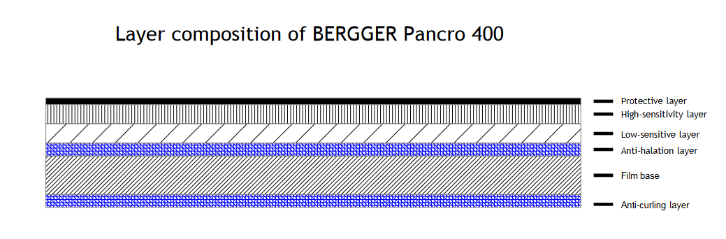

According to a diagram in the Pancro 400 instructions pdf there are two sensitivity layers as well as a bunch of others. Text cut and paste (top to bottom): Protective layer, High-sensitivity layer,
Low-sensitive layer, Anti-halation layer, Film base, Anti-curling layer

@Focomatter thanks for that. I'll stick that image here of Bergger Pancro 400's layers... So, it looks like they are laid down as separate layers. I'm curious about HP5, and other 400 speed (conventional) films. I imagine then that HP5's layers are also laid down separately...

What I find interesting is that the high sensitivity layer is on top of the low. Maybe whatever attenuation (shading) that exists is not significant.
It must matter. I'm sure it would have been tested. I wonder which layer is made up of silver iodide...
It's logical that the top layer would be the faster layer. You'd want to limit attenuation of incoming light for that layer, specifically. Putting a fast layer at the bottom is somewhat antithetic, especially in a monochrome film package.

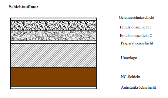

"Making KODAK Film 1st edition" has photomicrographs of the cross sections of Kodak B&W and color films. The light sensitive material in film is a combination of silver (Ag) halides AgCl, AgBr and AgI some times noted as AgX. The other silver halide made with Fluorine is not very light sensitive. Silver nitrate is not light sensitive; it is the material that contributes the silver (Ag) to the silver halide when the crystals are formed. One fact that is not discussed in the thread is that several emulsions makes are typically blended to create the material in a single layer. This allows fine tuning of the characteristics. The first edition of Making KODAK Film is available at:

I imagine it is similar to Tri-X which has two distinct layers, a fast layer on top of a slow layer. T-Max also has two distinct fast/slow layers (the top fast later being the tabular one). On the other hand I have a vague memory of an old article about Ilford Delta 100 in which that film was described as having a single (presumably mixed) layer. This may or may not have been correct so don't quote me on that.
Note that even if there are distinct layers they can often be coated at the same time (rather than in succession) using a multilayer slide/cascade curtain coater. I'd have to go back to Making Kodak Film (Robert Shanebrook) to check but if I remember correctly Kodak's slide coaters can do up to 10 layers at a time - which is especially important for colour films that have many layers.
