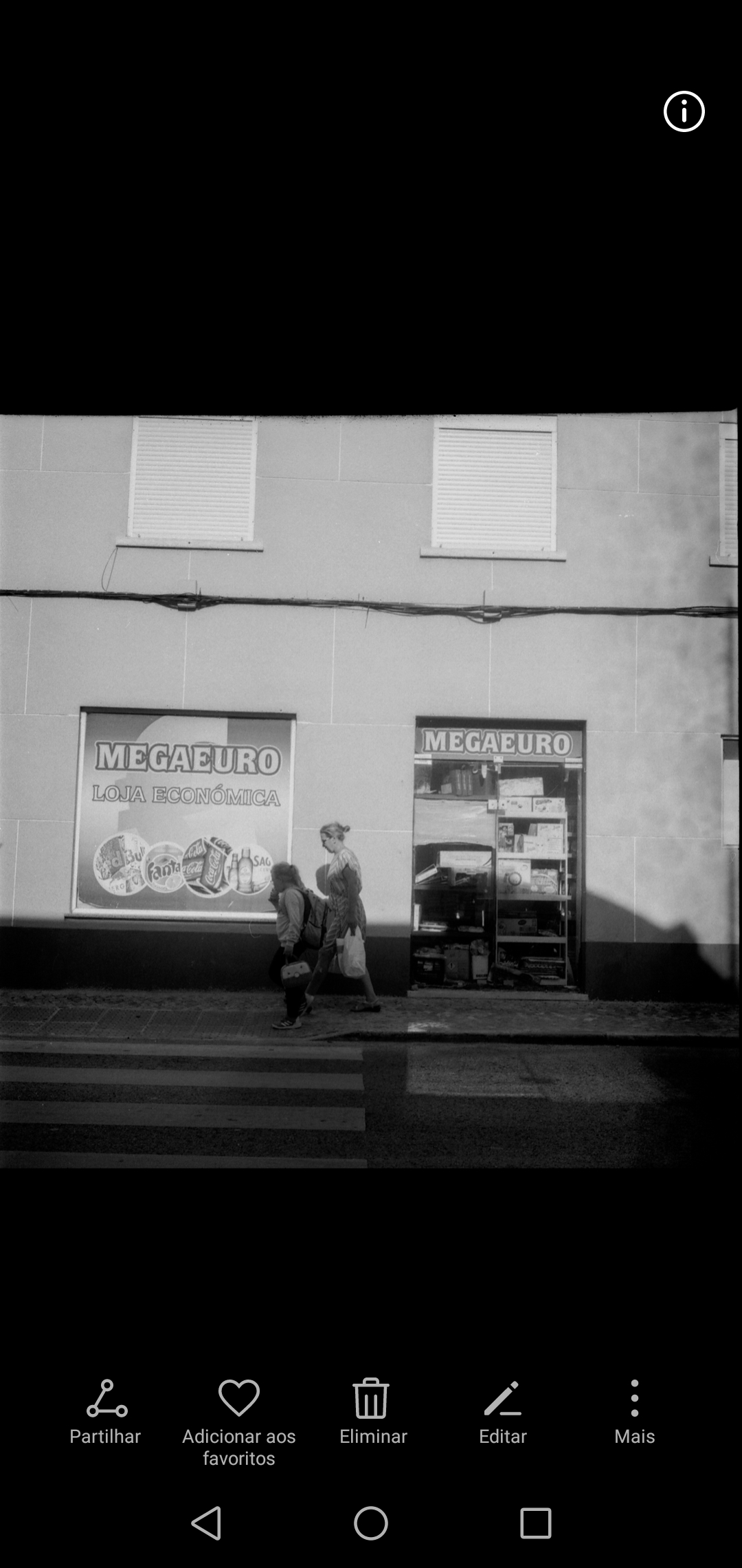

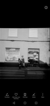

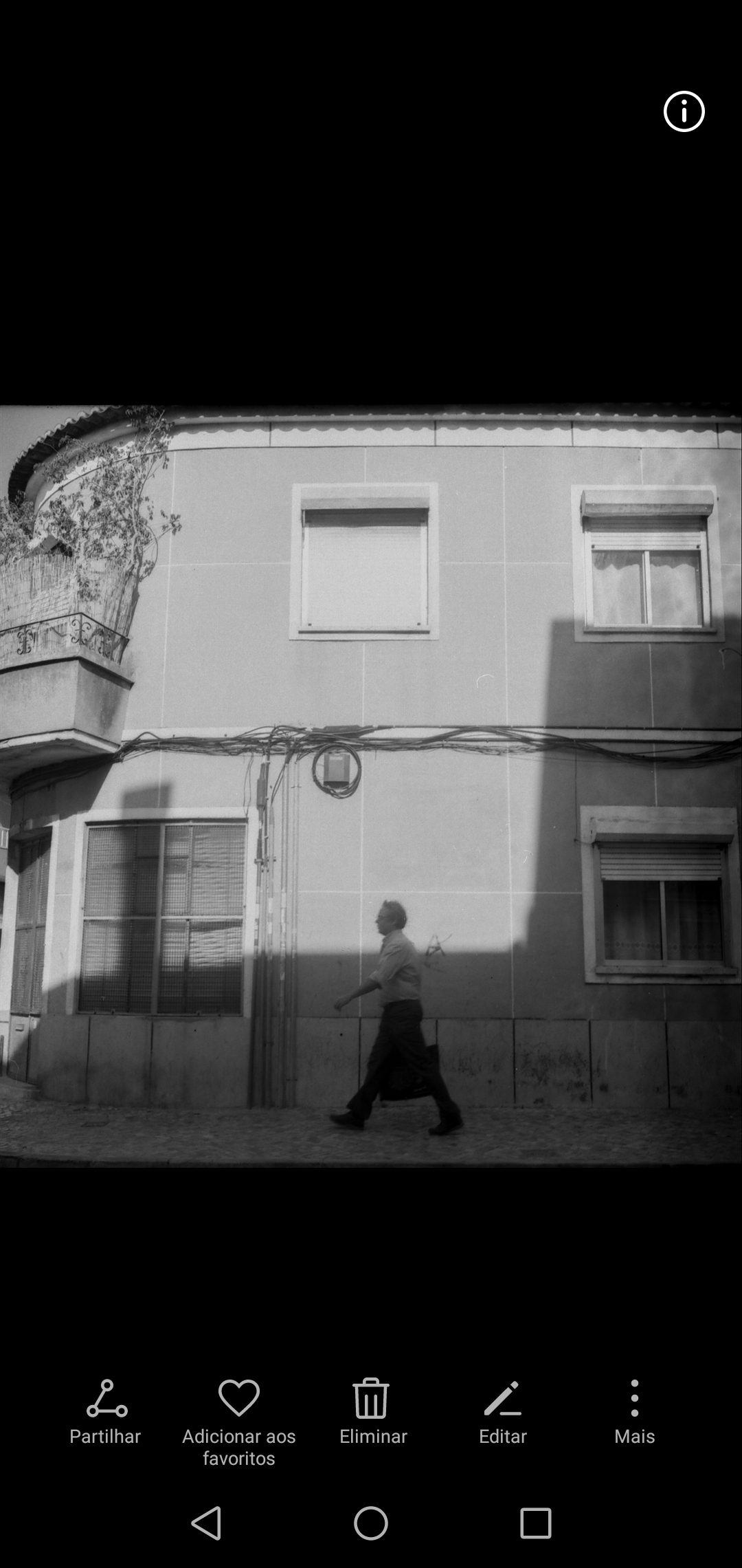

Some photos of another roller with development problems with such spots essentially on the right side

Bro Some photos of another roller with development problems with such spots essentially on the right side

So these later shots you have shown us show the spots on the opposite side to the first shot of the woman with a block of flats in the background.
If you are sure that the reels are covered with a little more developer to spare so say 580 mls for a tank which says 550ml for a film and you have cleaned the reel as I suggested and use the Ilford or Kodak agitation process and the Ilford wash and dump for the routine I suggested then I am at a loss to explain the problem in terms of the way you have processed the film

I inverted the picture of the woman with the buildings in the background ie in the same place always on the right side on the top edge below. My tank gives about 700mml or so, the next roll I will do with 650mm and I will do the rotations as it should be
If the tank holds 700ml of liquid then this is 150ml more than you are using which is a lot. In most tanks when you cover the reel which you say takes only 550ml this leaves a small amount of space before the tank is full to the top and not 150ml.
