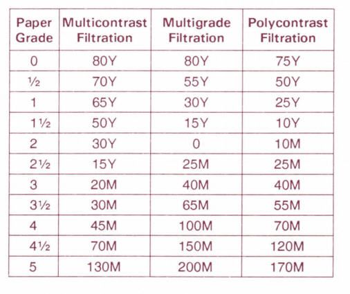

From Ilford comes suggestions for different brands of dichoic heads for its paper

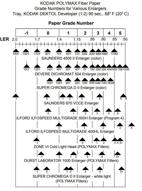

From Kodak, a chart for its Polymax paper

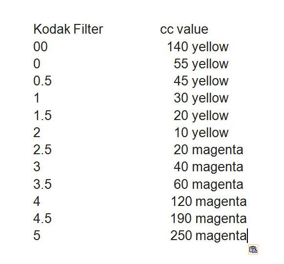

And a general suggestion of filter values to start with
So you see that universally Yellow does figure into contrast control, mostly at the low contrast end of paper ranges, but even at the 'normal' contrast range.

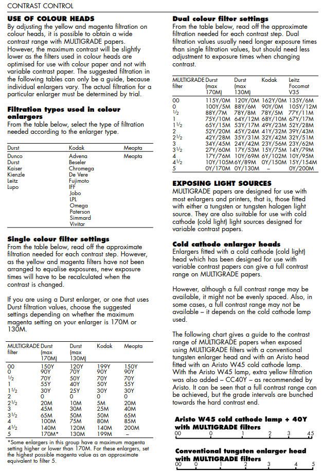

The sheet that comes with VC papers (at least Ilford's) gives suggested filtration settings.
For one filter and two filter combinations for all grades. That is what I use.

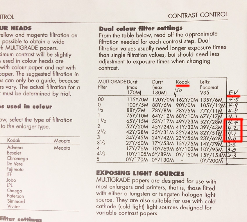

I recently rescued a beautiful Fujimoto 45m enlarger with a colour head so I thought I would try to test my patience again with it using multigrade paper. The dual filter method certainly minimises exposure time adjustment. I used a lightmeter to measure EV in the middle of the easel, setting grade 0 as close to 5 as possible and moving up the grades from there. Attached is a photo of my measurements. I am normally working in a range of grade 1.5 to grade 3 and there is less than half a stop across that range. Using this table and dual filter controls has helped me get the first draft print a lot closer as I change grades. It is also nice to be able to occasionally switch between the Durst 138 and Fujimoto based on negative properties. I still prefer the Ilford gels but the cussing has diminished when using the colour head!
