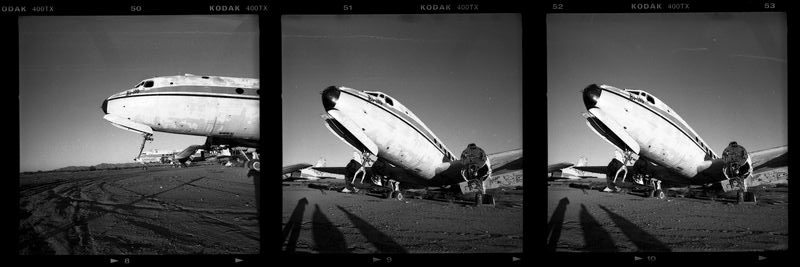

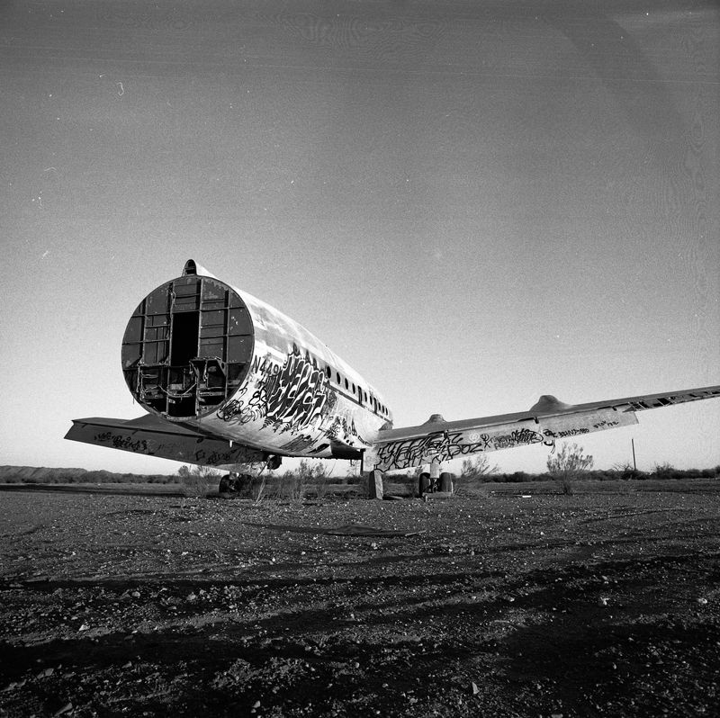

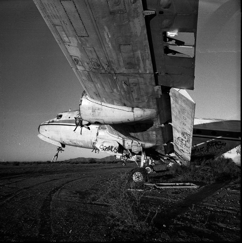

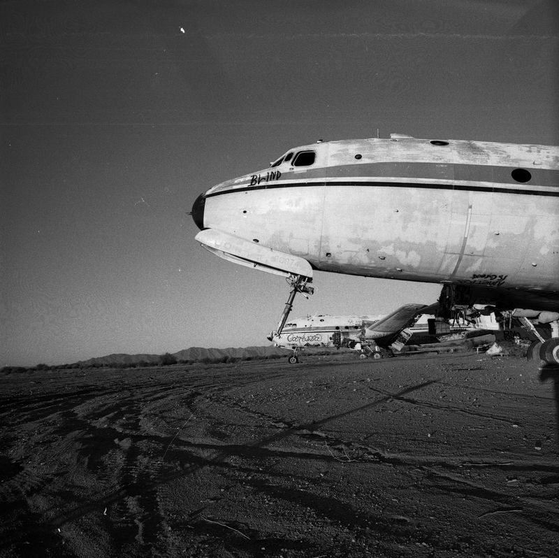

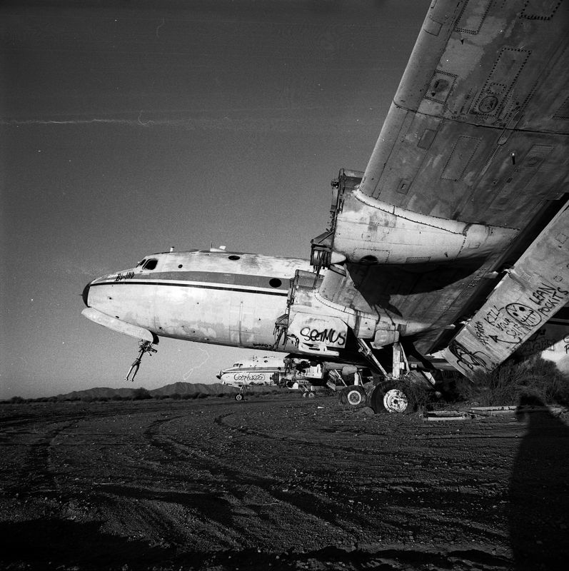

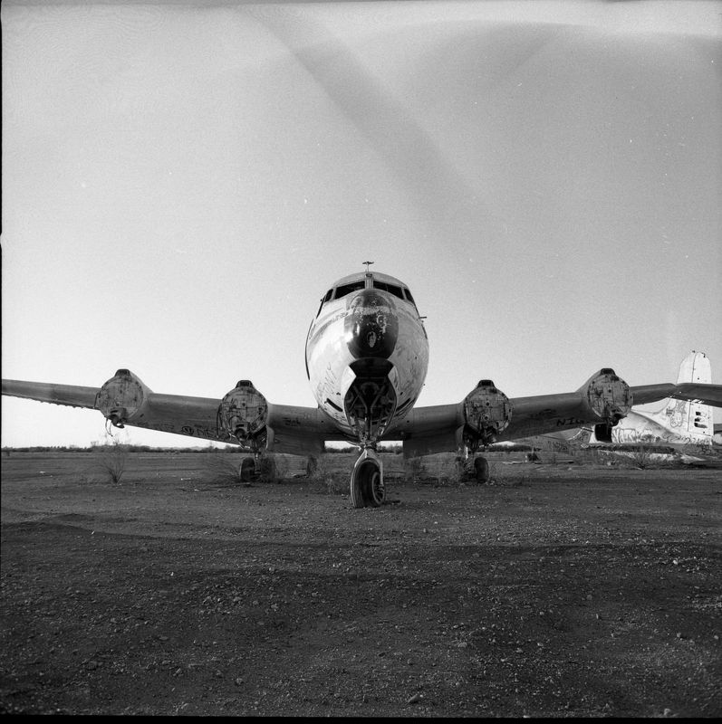

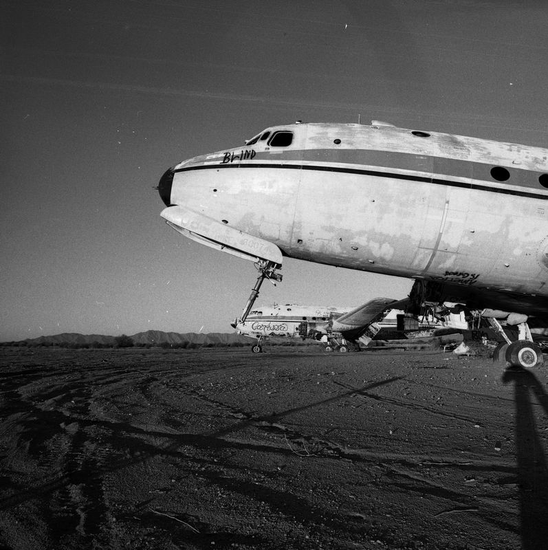

I don't usually shoot Tri-X 400, but I was out with a friend and only had 100 on me and she gave me a couple of rolls of Tri-X 400 in 120 size. Developed them today, and there's a REALLY weird pattern on one of the rolls of negatives. It appears that it's consistent throughout the roll.
Normally I'd look at something like this and think "camera problems," but the pattern, while consistent in shape, varies in location on the frame, and consecutive rolls of Fomapan 100 do not show it. Neither do previous rolls of Fomapan (it's pretty much all I use, because it's cheap) -- they are all pretty much perfect.

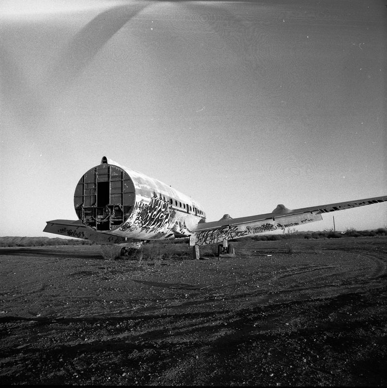

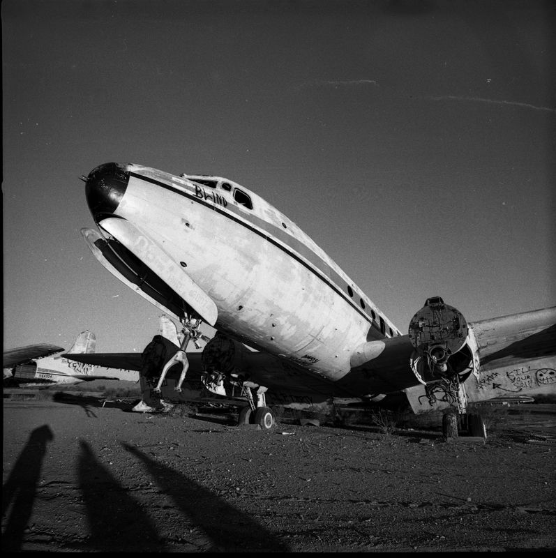

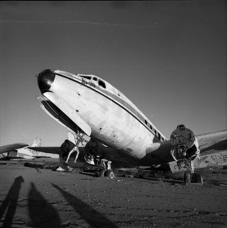

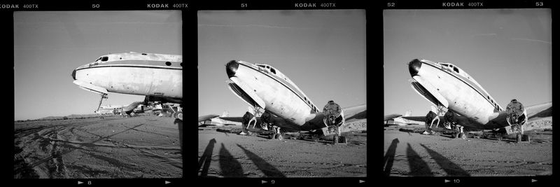

I've thrown these negs on my filthy-dirty scanner and scanned them direct, with no manual adjustments. You can see the pattern in the sky. These are consecutive images on the 120 roll. Sorry for the nastiness on the scanner platen.. I didn't feel like cleaning it at 1 AM.
Any ideas what it might be? Here are the technicals.
Camera: Norita 66 Medium-format SLR. body #2, which was repaired by Ross Yerkes at the beginning of the year.
Lens: 40MM f/4, which was serviced two months ago by a local camera shop and has been working perfectly.
Waist-level finder.
Developed in Ilfosol 3, standard developing times, in a metal Nikor tank.
I'm stumped.

My gut says it is a development time problem, like something misaligned on the reel. But that's just a wild guess. Doesn't look like a light leak.
Sep 10, 2002
3,675
Eugene, Oregon
I'm also leaning toward x-ray damage or a light-strike caused by the film not being wound tight enough on the reel before processing.

I am not entirely convinced of the xray damage theory. If the wavy bands were caused by xray, they should show as higher density areas in the negative, lower density areas in the positive. In the examples posted here it's the other way round. I see some general signs of irregular and "sloppy" development (e.g., trapped air, crud and dust on the negatives) and also light leaking onto the film, these irregularities may have contributed to what we see here. (As always ....) it would be most helpful for analyzing the problems if the OP could post some picture of the the actual negative (strips), so we can see if the areas of irregular density extend beyond the borders of the picture frames.
Neal
Dec 3, 2004
2,028
Chicago, West Suburbs
Dear mnemosyne,
Your assumption is that the spiral is an area of higher x-ray exposure when it could simply be an area of lower exposure. You could get that pattern if something blocking the x-ray left it. As noted by twelvetone12 it looks exactly like a few of the examples on the Kodak page.

Seems to be much more prevalent when the light source is to the side and minimal when the sun is to your back. Were you using a lens shade? I'm going with lens flare coupled with higher speed film. The problem appears at the top of the positive (bottom of the camera/neg).

The banding looks to me like X-ray scanning artefacts.

Just finally had a chance to take a peek at that Kodak site. It surely does look like airport scanner damage. I don't know the history of this film; two rolls were given me by a friend because I needed a higher ASA film for some lower-light fun (I normally shoot 100). It's a good thing these aren't images that cannot be reshot. It's really not that big a deal, because I can always go back if I want to shoot more of those planes.

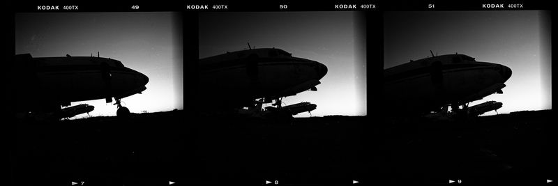

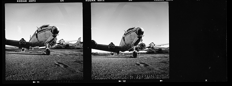

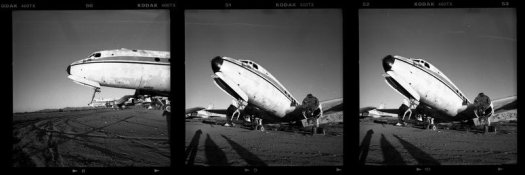

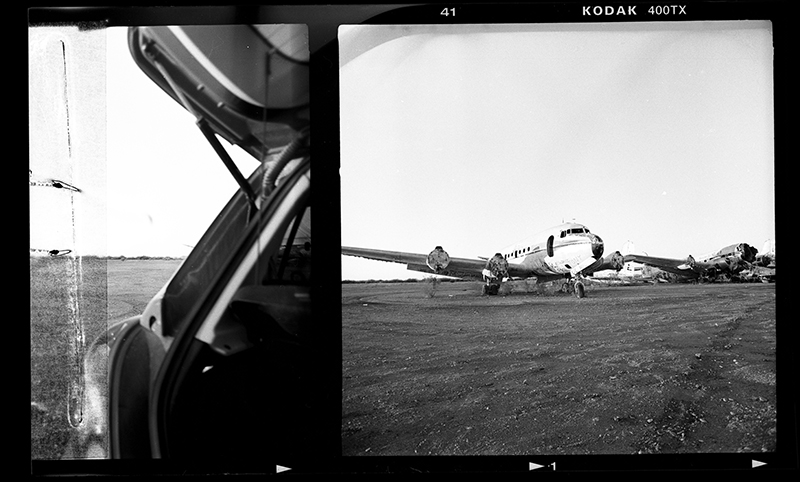

Here are some scans of the strips themselves. The last image -- img655 -- is from the other roll of Tri-X, developed in the same 2-roll Nikor tank at the same time. You can see, besides the fact I haven't cleaned my scanner in weeks, there's an issue with the shutter curtain timing on the camera (it's intermittent, and doesn't happen often enough to warrant sending it back in), but I don't see any of the markings the first roll has.

Some of what I see on the rolls looks like residue from wetting agent, or calcium deposits.
The first frame that has the arc - I'm thinking it's the phenomenon of dry air (Arizona), and sparks being created by static when the tape that adheres the film emulsion strip to the backing paper is removed.

The residue is certainly there, though. I gotta clean them off; I must not have squeegeed it off very well. I'll have to run some negative cleaner over it if I decide to do anything with the negatives.

Irregularities do occur with these Norita bodies, but never light leaks. With these cameras it's usually a shutter brake that goes wonky and results in underexposure of one edge of the film, as in img655 above. These things are so overbuilt that I believe I'd have to actually drill a hole in the body to get it to leak light.
