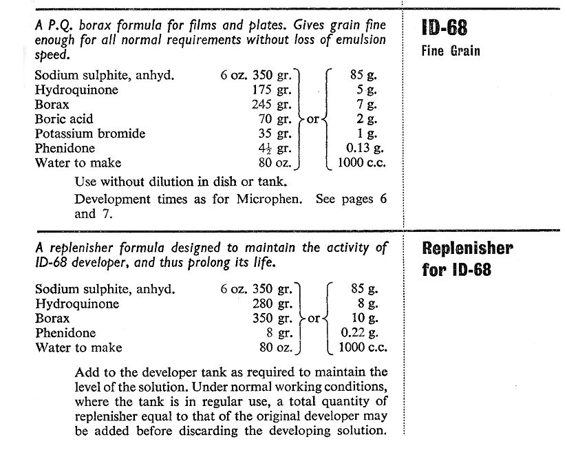

ID-68 is effectively the same as Microphen, they are interchangeable. There is a very minor difference in Microphen for packaging, that's the inclusion of Sodium Metabisulphite in Part A, but Part B is adjusted to compensate.

If you ant to make up Microphen then use the ID-68 formula, once in solution they are identical in use.
All commercial packaged chemistry varies very slightly from the published formulae but in practice function identically.

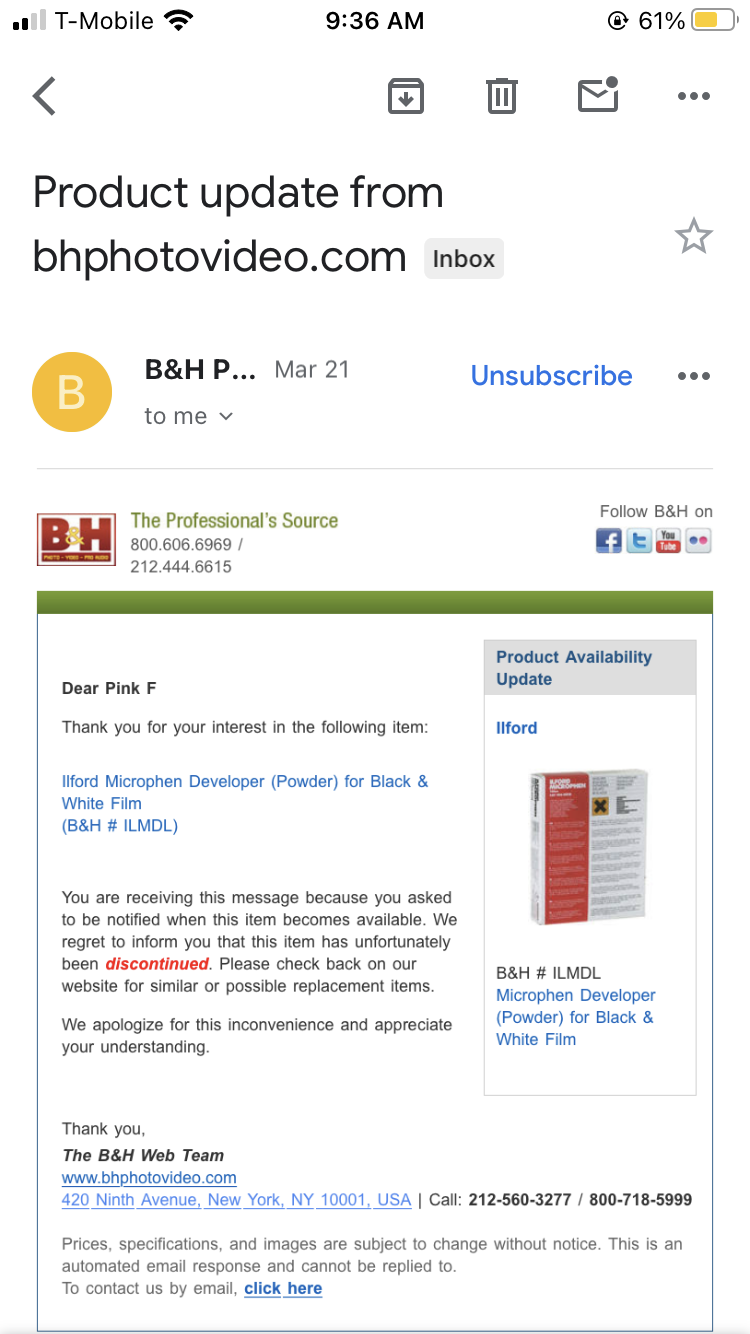

btw look at this sad email I got today. But knowing I can just mix it myself makes me feel so much better
All Ilford is saying on its site is that it is "out of stock" and it is saying that about ID11 as well. That seems to be quite different from "discontinued" The latter indicates a conscious action by Ilford to stop making it and if this was the case I'd expect Ilford to say so and give reasons
If I were a B&H customer I'd want to ask it exactly what "discontinued" means and who has discontinued it

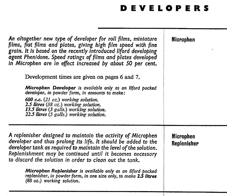

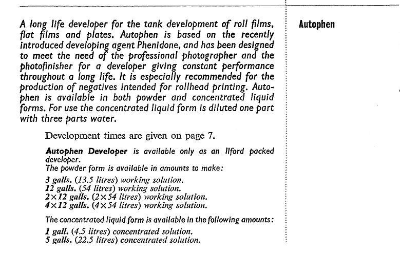

Mark, the Morgan & Morgan Photo Lab Index assumed that the Axford-Kendall Fine Grain PQ developer formula was Microphen, in fact it's the formula of Autophen a PQ variant of ID-11/D76. That myth persisted in other US publications.
During the mid to late 1950s there were a number of articles in the BJPabridgeded in the annual BJP Almanacs which shed light on the formulation of Autophen from a PQ version of ID-11 in the Kendal Phenidone patent. One aspect they highlighted was testing chemical exhaustion to formulate replenishers, two were devised one for topping up, the other bleed replenishment.
The advantage of a PQ version of ID-11 was it was not affected by Bromide build up so had a far greater capacity, and could be replenished for a long time, one lab years without mixing fresh..
One thing noticed was the slight speed increase of Autophen and a new developer was formulated to exploit this further, dropping thew Sulphite level by 20% helps boost film speed. as many found using Adox Borax MQ, or Agfa 44 (Agfa Ansco 17), compared to ID-11/D76.

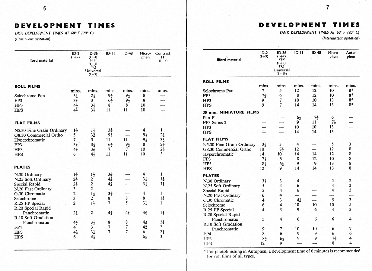

This is from my 1960 book of Ilford Forulae. Autophen was only sold in larger sizes, it was a fixed development time for most films. If I find the book I'll scan page 7
Ian
Found the book.
Here's the development times.
While there are no 35mm times for Autophen it was used for 35mm films by photo-finishers.
Ian
