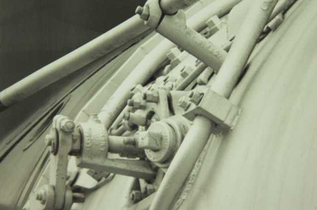

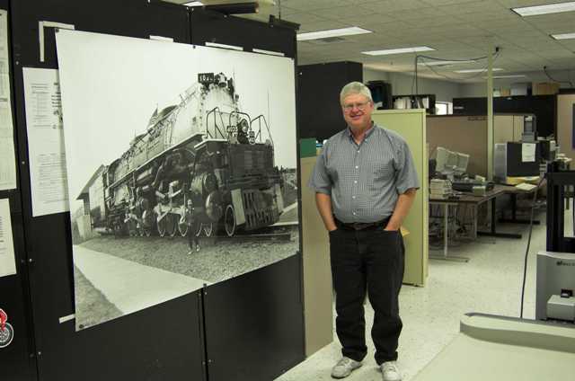

Here is a photo of Bob standing next to the print, and a close-up from the upper center of the print showing an area approx 2.75" tall.

Hey, that's a UP 4-8-8-4 , isn't it? Love those things

While it is true you need lots of light to make big enlargements, that doesn't mean you need 1KW lamps. Unfortunately, the wavelengths of light needed for printing on multigrade paper just happen to be those least efficiently produced in a filament lamp. Since this print was made on Ilford MGIVRC paper (easy to find rolls on ePay) you can refer to the document at http://www.ilfordphoto.com/Webfiles/2006130201152306.pdf to see the effect of color on print contrast for this paper. Incandescent lamps are poor generators of blue and green light. While you may well need 1KW to efficently enlarge using an incandescent bulb, the majority of the light available is being absorbed by your filtering. By using blue and green LEDs, Bob's enlarger is able to produce the needed light flux much more efficently, and since the colors are what you want, there is no need for additional filtration.
For the print shown in my first post, the exposure was 100 seconds using a 300mm el-Nikkor lens at f16. Pretty reasonable exposure time. Each color of light in his enlarger is dissipating 50W of power, or 1/10 of what is traditionally used. It works because the wavelengths of light being produced in the light head are those that are needed by the paper. His setup gives good contrast control and maintains printing speed by being able to vary the intensity of the blue or green LEDs independently. By this I don't mean each LED, but each color of LEDs. Think of it as a knob for adjusting the blue, and a knob for adjusting the green. If things are calibrated correctly, you turn both knobs to the max for a print grade of 2. Turn the blue knob down for a lower contrast print, or turn the green knob down for a higher contrast print. If you need a longer exposure time, turn both knobs down.
Oh - yes the train is a 4-8-8-4, #4023. The photo was taken about 13 years ago in Omaha Nebraska at the park area ran by the Union Pacific Railroad near their offices. The train has since been moved to a city park somewhere in Omaha.
