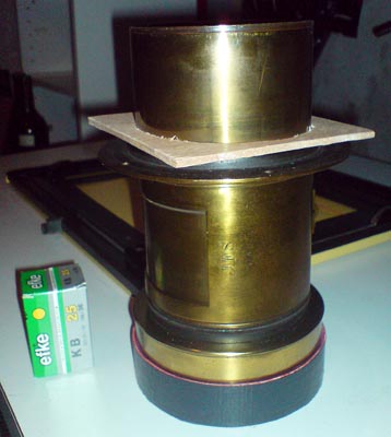

I just found a Petzval design to play with on my FDK 18x24 camera. But, as you can see the lensboard i made for it is too small... The lens itself is quite heavy for the camera.
I am sure I am not the first one with this problem. I am thinking about adding some more sheets of plywood and maybe a hose clamp on the inside. Any suggestions would be welcome.
The lens says JFS. I have a couple of stops for it.
/matti

Can you make an extended lens board one that is a box which tapers from smaller to larger with the smaller end having a flange so it will fit into the front standard like your regular lens boards? The smaller end is just a board that overhangs on all four sides.
Curt
Yeah, I had something like this in mind. It is supposed to be about 35 cm, so 18x24 seems like a good portrait format for it.

Hi !
You can, as I do, glue 2 or 3 sheets of plywood to make a thick board.
Then you can machine it using a router mounted upside down on a table. Be particulary precautionous and make/install protectors to prevent your fingers to reach the router's cutting tool.... Routers are quite dangerous tools.
